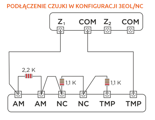

How do I wire the dusk sensor output of a Satel Opal PRO detector to an Integra 128WRL control panel?
Connect the dusk sensor output directly to a control panel input, and use the detector in the classic 2EOL/NC wiring because the Integra 128-WRL does not support 3EOL/NC inputs. [#16515079][#16515650] The thread notes that 3EOL/NC is available only in the Integra Plus series, so using that scheme on the 128-WRL can cause tamper/sabotage problems. [#16515650] If you want to use the anti-masking contacts, connect them to any panel input and program that input as NC/EOL for a masking detector. [#16515650]

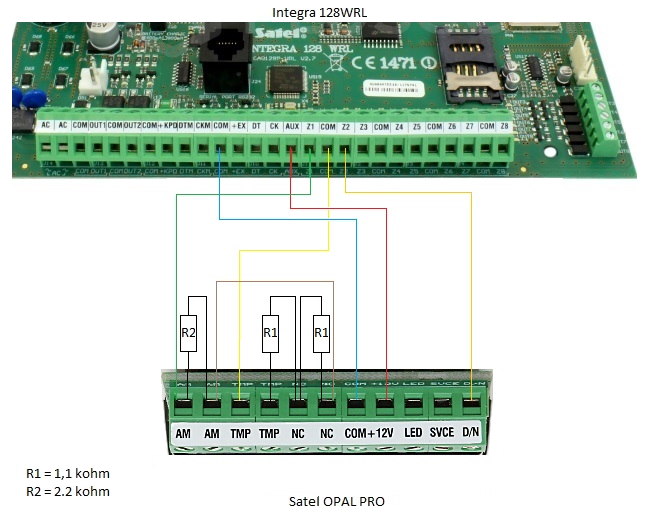

    Please help me connect the Satel Opal PRO detector with a dusk sensor to the Integra 128WRL control panel.
    Generally, I do not know how to connect the D / N dusk sensor output to the control panel.

    The dusk sensor output is connected directly to the control panel input.

    And I suggest to my colleague the author to look again at the 3EOL / NC scheme. There is an error in the diagram. When moving, the entrance will sabotage.

    Thank you for the analysis. I added a corrected drawing (I hope it's ok this time)

    In fact, we accelerated anyway ;) Integra 128-WRL does not support inputs in the 3EOL / NC configuration (only Integra Plus series). Therefore, the classic detector connection as 2EOL / NC remains and the anti-masking contacts connect to any control panel input and program as NC / EOL - masking detector.
  • #7 16516669
    marius3200
    Posts: 12
    Right, I suggested the options available in DLOADX, and here is a surprise.

    I started assembling the system at home. As far as the classic DEOL configuration is concerned, I have no problem with it
    Satel OPAL, I am considering connecting additionally AM.
    And here is the question - how? Is this diagram from the beginning of the post ok? He still looks like 3EOL to me ...
    Can the output from AM1 be given directly to the control panel input configured as Normal / Normal?
    And if I would like it to be in the EOL option, then a 2.2k resistor should be connected between NC2 and AM2 and the output from AM1 to Ix in the control panel?
    Detector outputs:
    AM1-AM2-TMP1-TMP2-NC1-NC2-COM-12V

    For future reference, catch the schematic of the colleague above (dariusz.bembenek)
    https://obrazki.elektroda.pl/9652722400_1488477771.

    Black and blue in series with the "tamper" resistor (TMP-TMP circuit).
