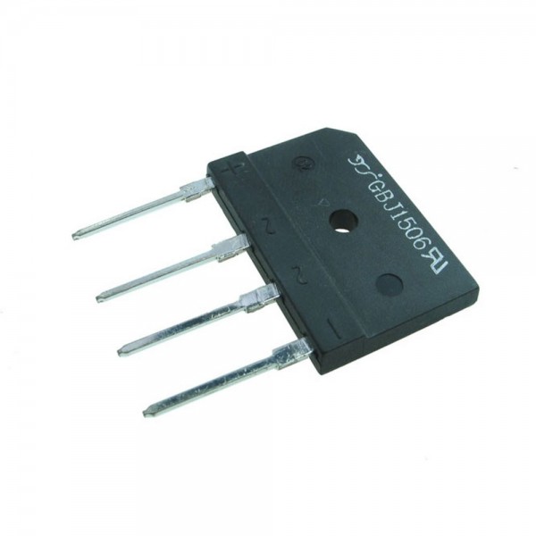

    LG 42lm670S TV 4.5 years old. The TV was on and nothing else was connected to the sockets. Suddenly he turned off, it turned out that the fuse in the apartment was thrown out. After switching on, everything works, the power is in the sockets, only the TV is silent (even the power LED is off, it does not respond to the remote control and the power button). I unscrewed it, but visually nothing can be seen burned, the capacitors are not swollen, etc. What do you suggest, of course, you can always return to the service, but maybe it is a bit of a shit. There is no typical power supply here, at least a separate one.

    The wires are not connected to the bone, but the plug and the plug in the socket ...
    Measure the rectifier bridge for a short circuit without a power cord inserted into the 230V network.
    I wrote about the F101 fuse to the left of the soldered terminals of the 82uF / 450V capacitor, also glass, but slightly smaller.

    To repair electronics, you must have at least minimal knowledge in this area.
    You should also be able to use your own mind and use the Internet, especially the search engine.
    Just enter the "rectifier bridge" in it and see what enclosures it is in and then look at your power supply.

    The bridge with the RS15005M designation (on the board in the lower right corner) has a short circuit (I put the meter tips to the leg + and the legs - and the buzzer buzzes.

    This means a short circuit. Transistors, capacitors, diodes and the bridge itself can be shorted. Replace the fuse itself it will be a buum.
