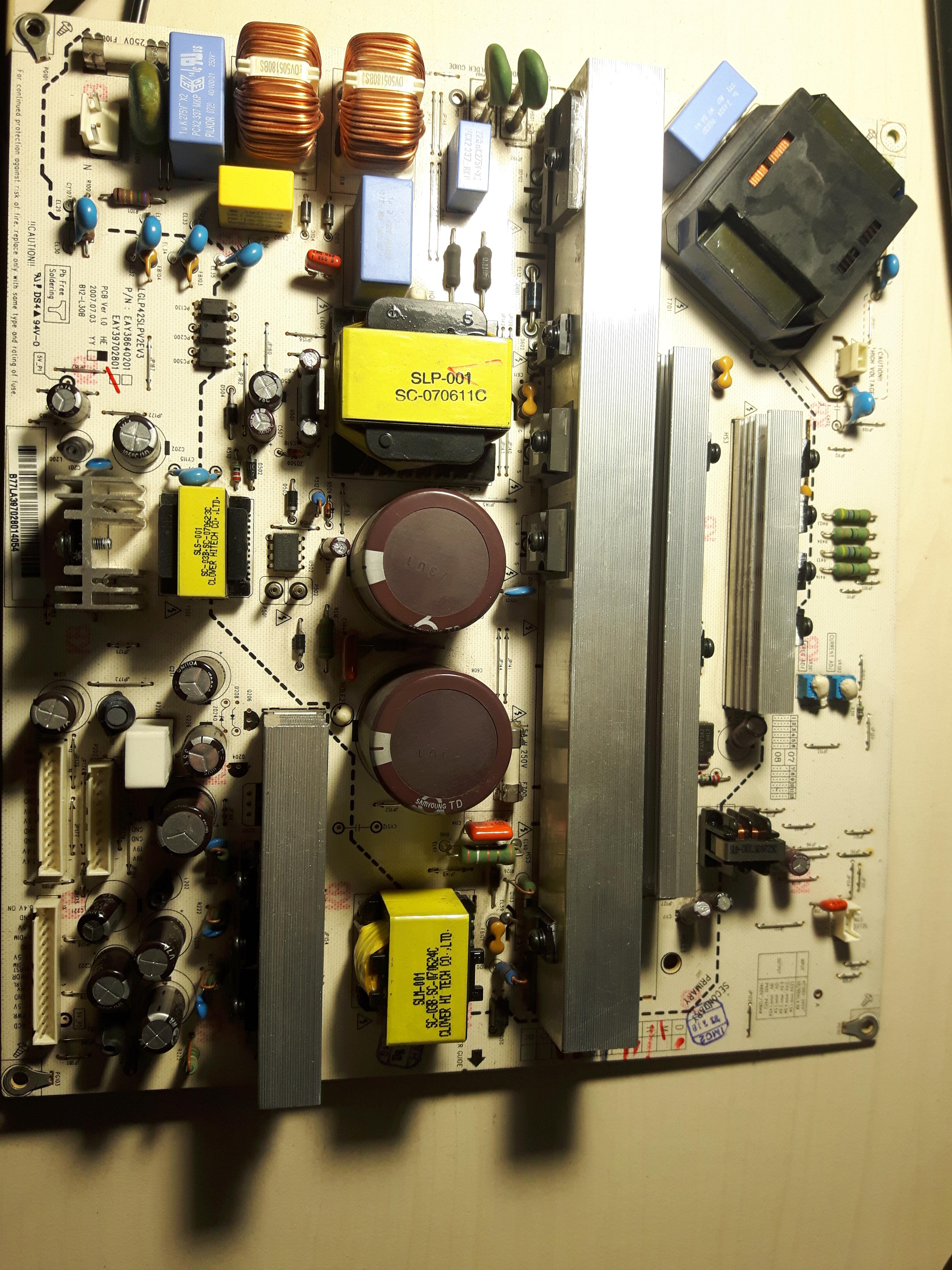

    As in the subject, 2 days ago there was a power outage and after this incident the TV won't turn on. The LEDs are not lit. What do you suggest to check first? LG LCD TV

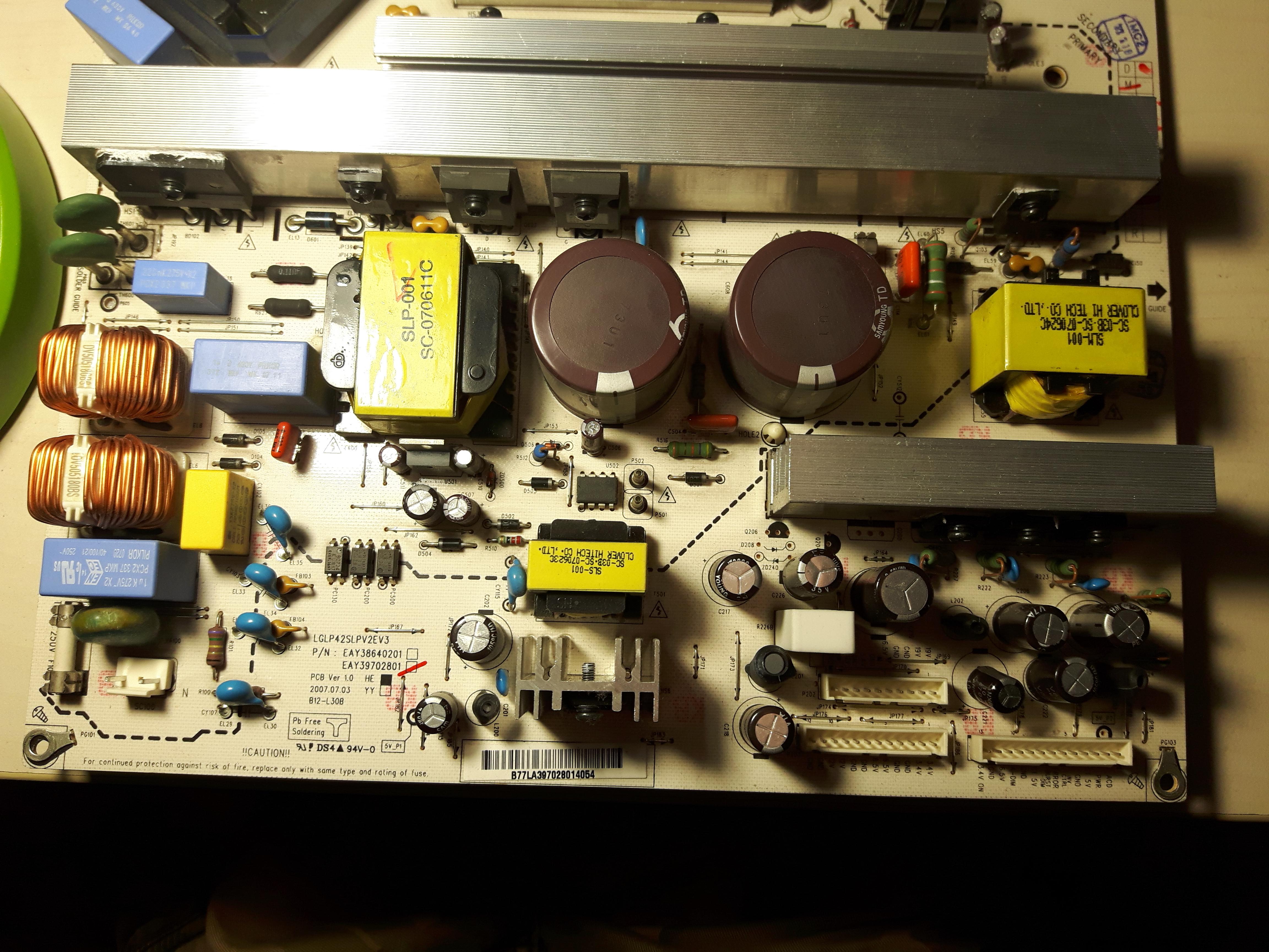

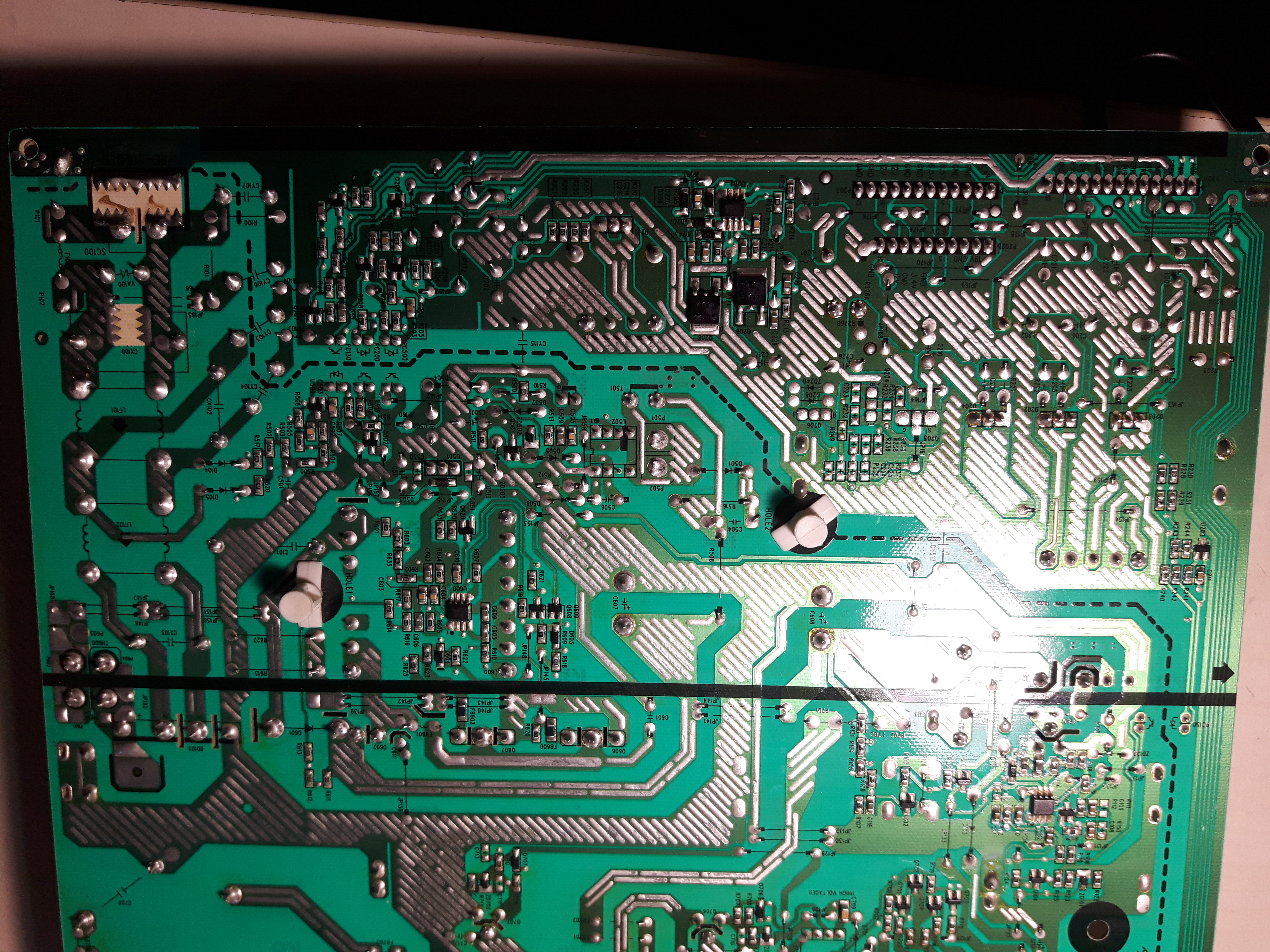

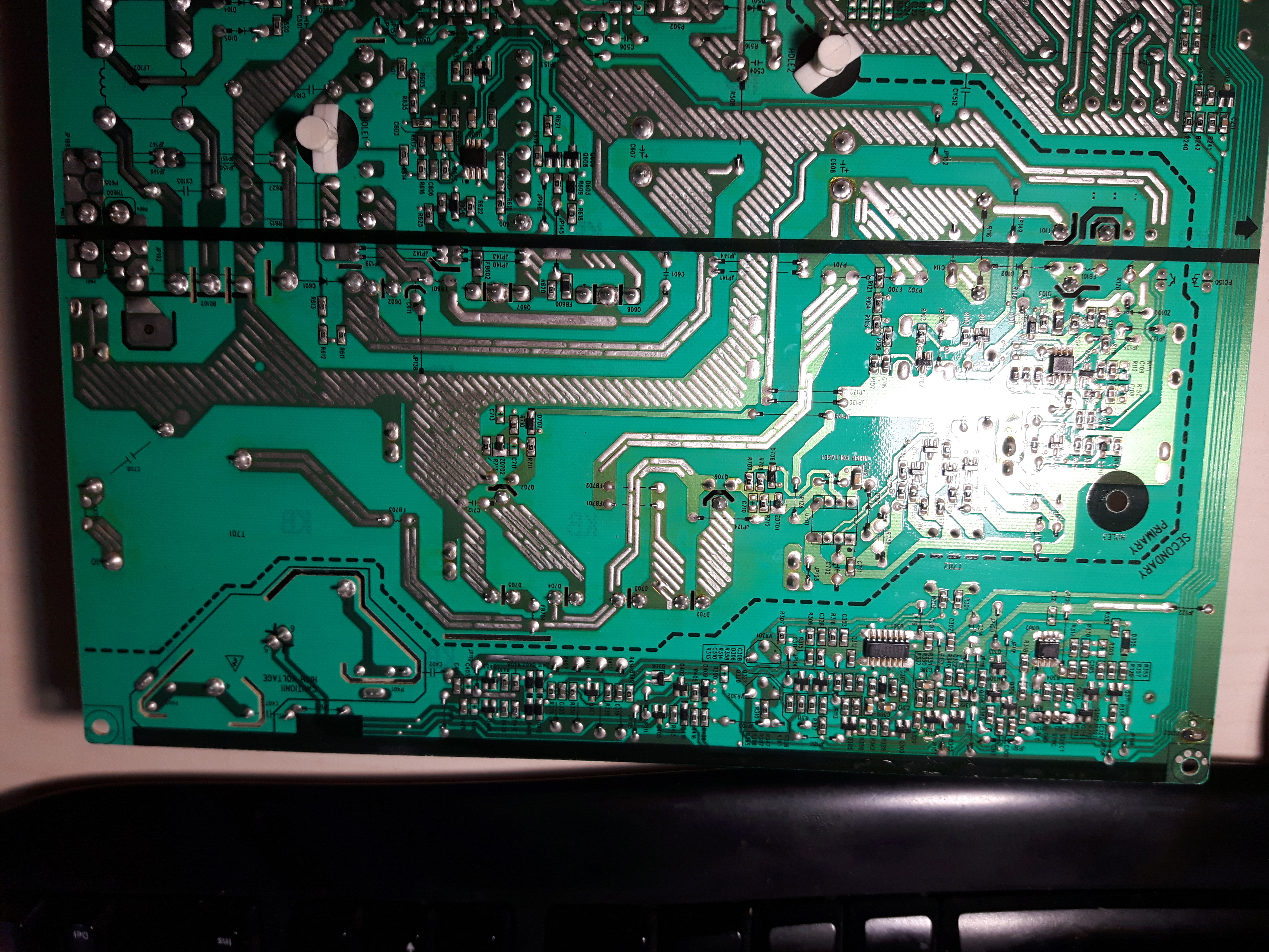

    I am sending photos of the power supply, I will edit tomorrow and let you know

    Are there any fuses maybe?

    The TV does not turn on, so the first thing to check is the voltage in standby. The output connector of the power supply is quite well described, so you can check if there is any voltage there and if its value is correct. You can also check if there are on / off signals.
    Start from this.
