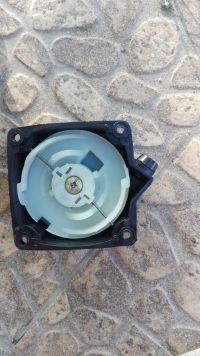

Do I need to unscrew the central screw to replace the string on this mower head, and if so which way should it turn?
You do not need to unscrew the central screw to replace the string; the head is meant to be opened/pried up and the line replaced that way, similar to the linked video [#16518385][#17235023] If you do try to loosen it, one reply says to turn it clockwise because it may have a left-hand thread [#16517537] Another user says unscrewing it can make string replacement faster, but warns that the spring can pop out if you do it carelessly [#17235040]

    Is it necessary to unscrew this screw in the middle to improve the string replacement? As you can see I tried, the mower is a week and the screw will not even move.
    Please help me deal with the problem as easily as possible.

    Try turning it clockwise :) There may be a left-hand thread.

    I have tried none of it right away and will not move in any way
    Kosa Demon: Unscrewing Central Screw for Easy String Replacement Process
    It will dig out a little bit but I just smashed this starter, and this screw is not to unscrew it, only it has 2 rows of multi-grooves and I just need to pry and pull up. I tried to unscrew it by force and I got plastic in this multi-line. Maybe it will be useful to someone. I paid 15 zlotys for the new starter

    So how many times have you turned it off a hundred? I always unscrew it facilitates and speeds up the exchange if you know how to do it (because the spring may pop up).

    I turned it a few times and did not want to come back later. I needed to fix the spring because I fell from this internal latch and did not twist the cord.

    Gee, I have just such a problem with this Demon when I was replacing the starter rope, the spring that is at the very bottom popped out, I retracted it but cannot adjust it in any way when I put it on, it jumps out of this groove and even after folding the rope does not retract back. What can I do in this situation?
    Thank you for any feedback.
