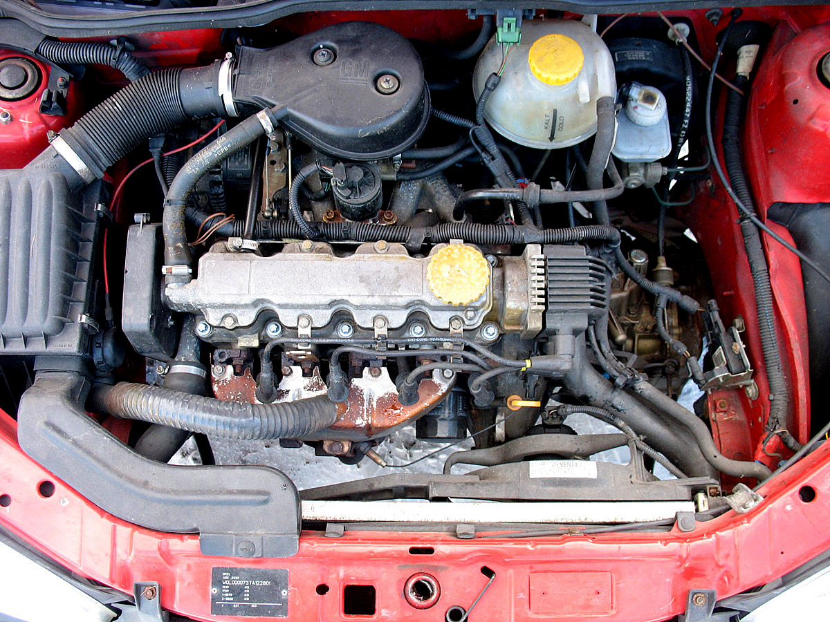

    I lost the C14NZ engine in the Corsa B I have a 2 engine but a different type and 1.2 capacity because without the possibility of installing a power steering pump, so I will also have to change the steering gear without power steering, Please give me a hint on where to start (I think I'll buy a hand winch on Allegro, cost PLN 50. and I will hang it on the ceiling at my friend's garage where there is a channel) I have to reckon with the fact that I also have to change the computer because the engine I want to install is different, but the biggest problem will be with the gas installation because if after replacing the engine and the computer, it will go on gas?

    I mean in what order to start disassembling the engine and whether it will be easier to remove it with or without gearbox, because I have a 2 g engine with a glass
    8 valves

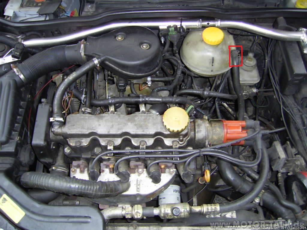

    I want to throw out 1.4 8 valves and insert 1.2 also 8 valves because I have one

    The engine is a breeze, but you have to change the installation and the computer. And connect the gas to this.
    I would buy the 1.4 column and change it.

    So buy the same without accessories and there will be no fun with the computer, gas, wires, etc.
