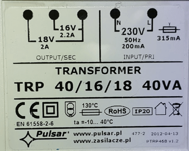

    Currently connected to the system:
    Subassembly name Quantity Power consumption Total current consumption
    INTEGRA 32 1 piece 127 - 234 mA 234 mA
    PIR Pyronix KX 15DD 5 pcs 11 - 12mA 60 mA
    Pyronix KX 15DT 2 pcs 24 - 30 mA 60 mA
    Ethm-1 Plus 1 piece 70 - 80 mA 80 mA
    GPRS-T4 1 piece 45 - 190 mA 190 mA
    INT-O 2 pcs 30 - 160 mA 320 mA
    INT-E 2 pcs 35 - 80 mA 160 mA
    INT-KLCDR-BL 1 piece 60 - 156 mA 156 mA
    In total, it is about 1260 mA.
    The transformer is as in the picture: 18V / 2A Satel INT-O, INT-ORS & INT-IORS: Comparing Relay Performance, Replacements & 230V LED ControlTransform..or.png (125.96 kB)You must be logged in to download this attachment.
    The power supply will probably be insufficient if you want to connect more output expanders. But I don't know if I need relay outputs, if separate relays can be controlled with a small current.
  • #12 16923276
    bhtom
    Posts: 4498
    Help: 446
    Rate: 604
    What about the battery charging current?
    There are no signaling devices in the system?
    You can see that there is not enough already , and the expenditure of trafo has nothing to do with the expenditure of the power supply on the board.
    Best regards.

  • #25 19756431
    skrzyniarz1987
    Posts: 6
    I will order the same one that powers the alarm control panel and connect it directly to the INT-O expander socket and I will recommend it ( 12V) to the relay coil output for lighting ... 50mA ... How do you convert mW to mA?
  • #26 19756433
    bhtom
    Posts: 4498
    Help: 446
    Rate: 604
    I see you completely don't understand what to do ...
    There is a transformer in the photo and this is not a power supply ...
    Greetings.
