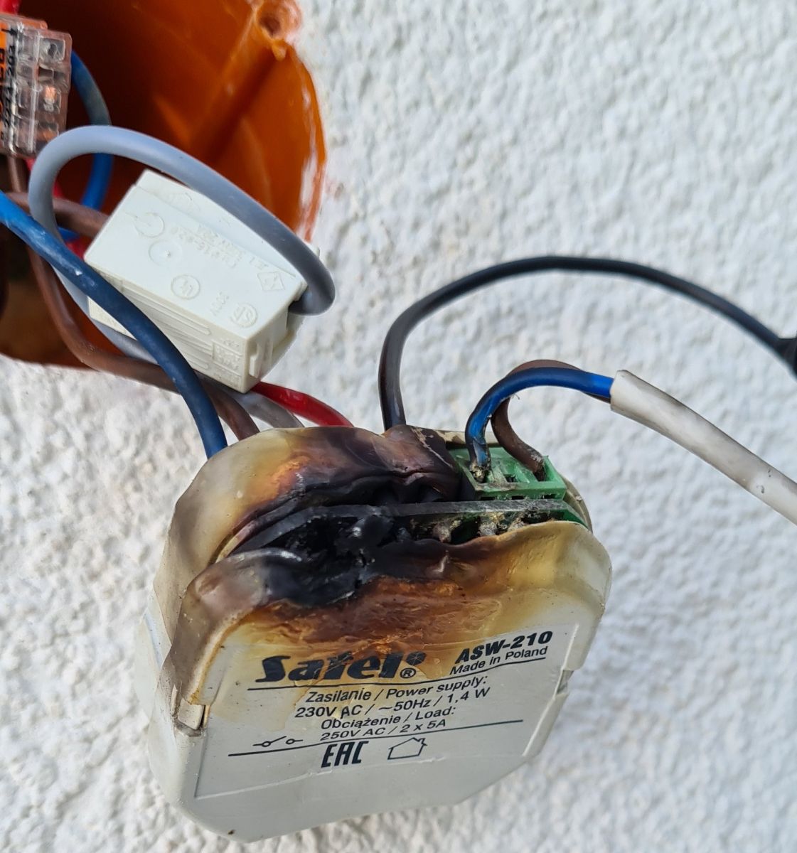

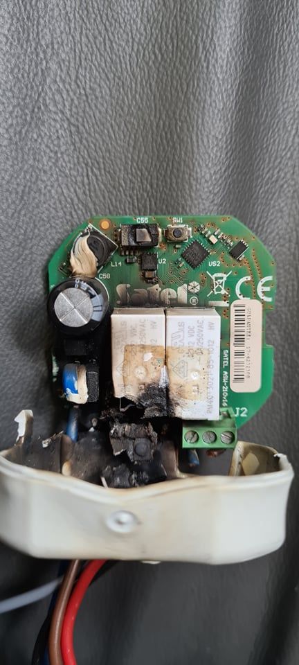

    Good morning!
    I would like to raise the following issue and get your opinions.
    There are two façade lighting lamps, in them 2 LED 230V GU10 bulbs of 10W each.

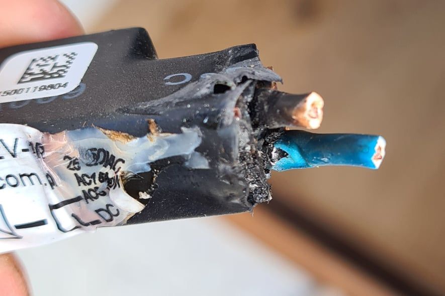

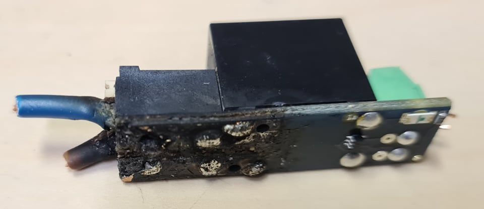

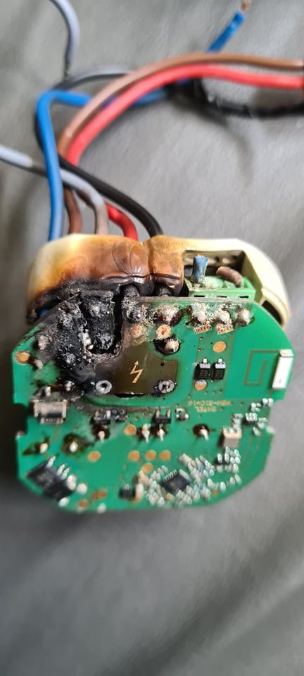

    Controlled from the integra by an ASW-210 relay and the other point by a Ropam RM5. Relays concealed in flush-mounted boxes.
    At both points the modules burned out as shown in the photo. The light was switched on from a timer at night time. It was not used excessively. The damage occurred non-simultaneously but fairly soon after the system was up and running i.e. 2-3 weeks. I would add that other points on Relpol RM85 relays are ok, same light sources everywhere.
    What could be at fault in this situation ?

    Atmospheric discharge or switching overvoltage in the installation?
    I assume that the N in the installation was not missing because the losses would have been more extensive....
    Another pathway is dampness/flooding of the controllers.
