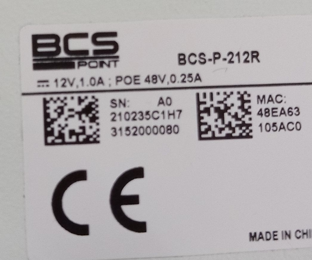

    Can anyone help me reset the password on the bcs point p 212r camera? The photo shows the serial number. Thank you in advance.

    gm811 wrote:
    Can someone help me reset my password
    You have the password at PW

    I do not sit tightly in the cameras, but is this practice not in conflict with what we are doing?
    Does it really have to be like that the first person will take a photo of the sticker, approaching the camera, then write on the forum and get the password? :)
    Of course, I'm not saying that the questioner should not be trusted, but on the other hand, this is probably not the place to make such data publicly available.
    I suggest you report to your equipment supplier (distributor), who will arrange the appropriate password (doing it consciously, knowing who he is dealing with).

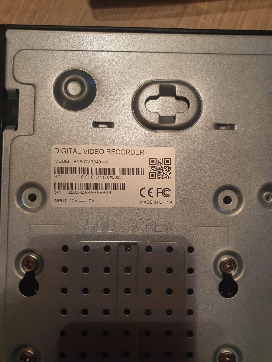

    Hello everybody. I need your help. I HAVE dvr:
    BCS
    MODEL : BCS-CVR0401-IV
    And I can't remember password. So ebone please help me how to reset this dvr.
