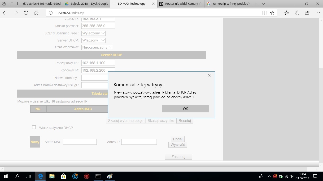

    The initial address is 192.168.2.100 and the final address is 192.168.2.200 and the camera address is 192.168.1.108 so it is out of range so what should I do in this case?
    And how should I do it?
    #6 17270430

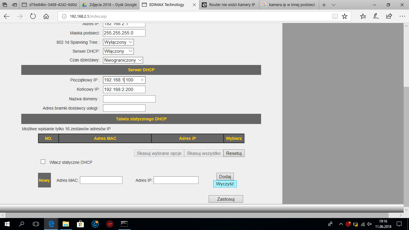

    Router Not Detecting BCS TIP-3300IR-E IP Camera with Edimax BR6478GN: Setup Issues & Tips Router Not Detecting BCS TIP-3300IR-E IP Camera with Edimax BR6478GN: Setup Issues & Tips
    Unfortunately, it can't be done.
    And this can be?

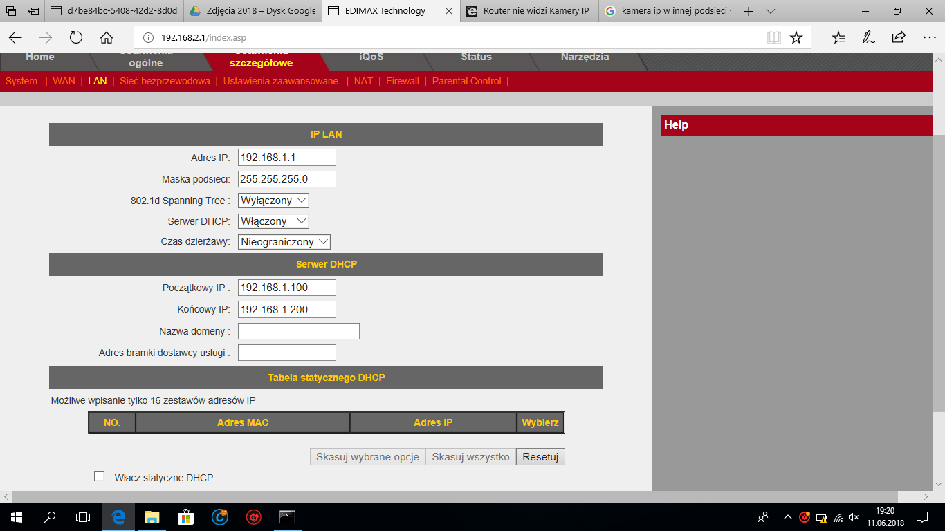

    I also changed the first item LAN IP Address.

    Thank you very much. The login page for the camera has been displayed but you cannot enter the login and password because it is just jamming at the moment.

    The problem was solved with the help of a colleague koderr. It was enough for the IP camera address to be in the range that includes the router address between the start and end addresses.
