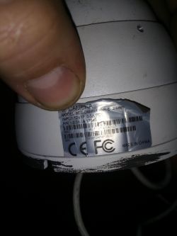

  • #14 17535375
    syntax83
    Jabtez, I could ask for a service password. I am sending the photo from s / n.
    Resetting Dome IP Camera BCS-P-212RWSA-G: Procedure to Find IP Address and Restore Factory Settings
  • #15 17539456
    BCSCCTV
    Level 19  
    Posts: 194
    Help: 40
    Rate: 114
    For this camera, the reset is mechanical.
    Make sure to shorten two points on the main board for 10 seconds while the device is on.
    In the attachment picture pins for short circuit

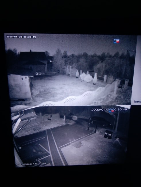

    Hello, I have a BCS P 464R3WSA webcam, I changed the address to 192.168.1.111 so for testing but that small children accidentally entered port 8080 at the moment the recorder sees it but I can not enter through IE, Mozilla and Opera browser, I can somehow restore it to factory settings this is one thing, the second thing is whether this camera in the night sees so poorly or something I have wrong positioning I attach a photo on the top BCS 4 mpx motozoom camera on the bottom budget Dahua 2 mpx fixed lens. For comparison, BCS 1420 PLN, Dahua 109 PLN

    @marniu Have you tried after 192.168.1.111 to add: 8080 or connect to it from a computer application?
    The picture could have given a larger one, can be seen at night - all the more so because you don't have any lighting in the area.

    The problem is that in the recorder he sees it as 192.168.1.111 port 8080, I can see the preview, but from the browser I can't enter the lighting, the camera at the bottom only lights ir, I don't have external lighting turned on at the moment and what view is this BCS tragedy , I will add that last week I had the Hikvision B640H Z and couldn't see better because I replaced it
