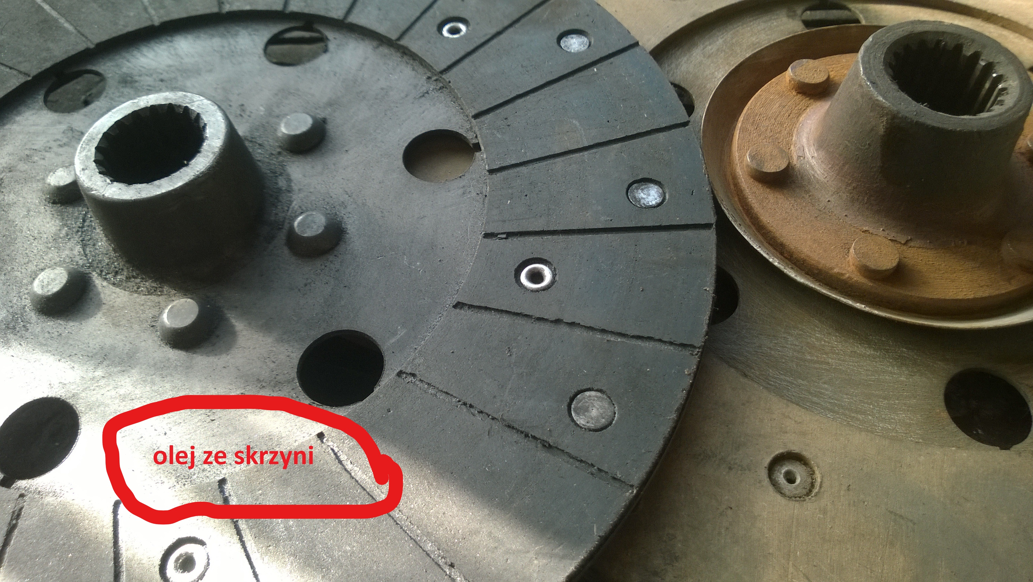

    I have 30 from 1987, supposedly M to the back of the parts with M I bought and I wanted to order the org ursus discs, just as there is a difference, I won't do anything until I drive over the front.
  • #22 17488714
    darekstrz
    Posts: 13
    Rate: 59
    hello, if i find such a shield, i will take a photo
  • #23 17534281

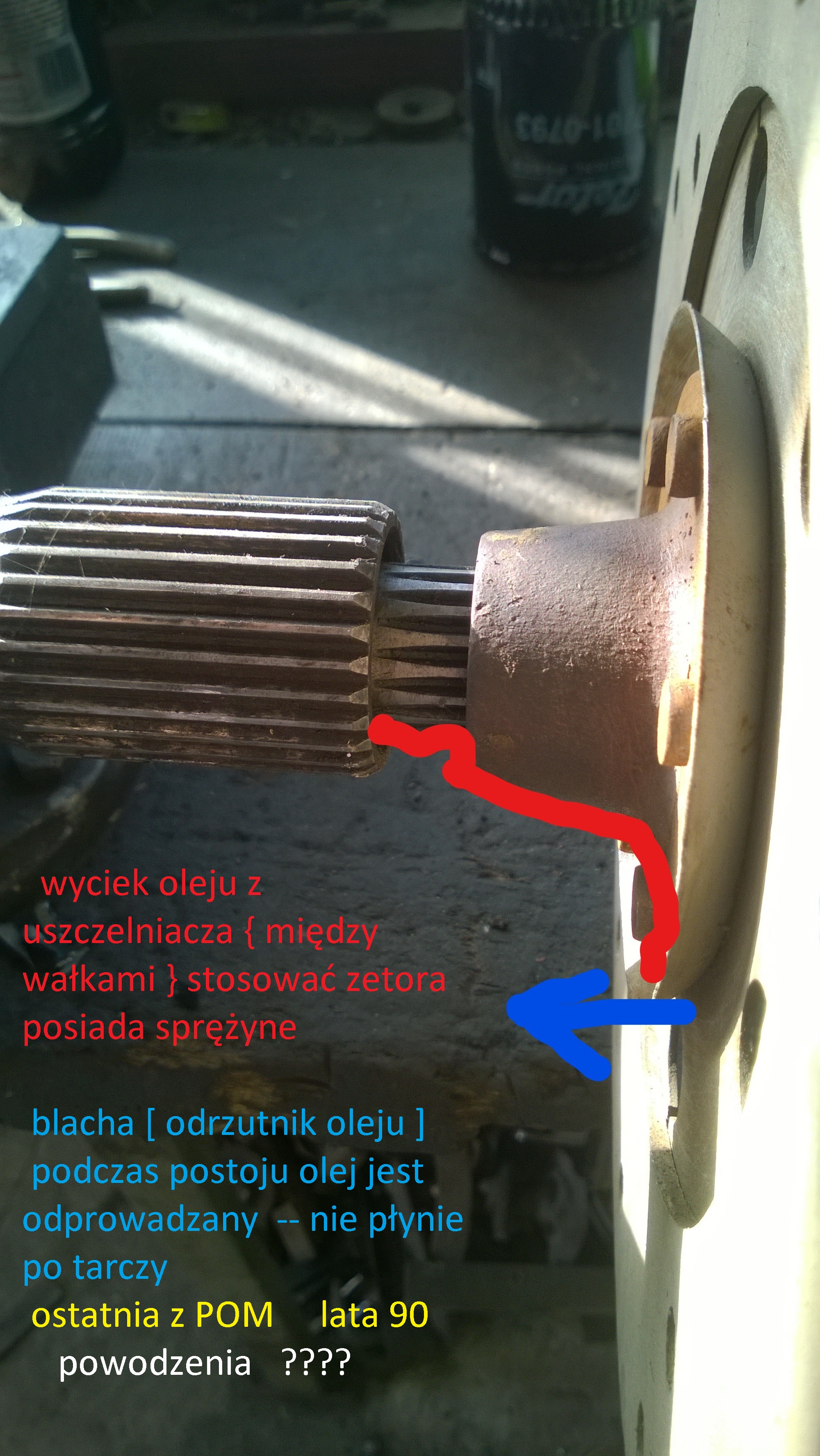

    darekstrz
    Posts: 13
    Rate: 59
    Hello and sorry for the time
    • Ursus c330 - Clutch Adjustment Guide, 1st & 2nd Degree Adjustments, Glow Plugs Location InkedWP_20181031_006_LI.jpg (4.59 MB) You must be logged in to download this attachment.
    • Ursus c330 - Clutch Adjustment Guide, 1st & 2nd Degree Adjustments, Glow Plugs Location InkedWP_20181031_005_LI.jpg (2.09 MB) You must be logged in to download this attachment.
  • #24 17534963
    BANANvanDYK
    Posts: 7813
    Help: 1167
    Rate: 2601
    In 1987, the diameter of the clutch discs was changed. Changing the diameter of the PTO disc from 224 mm to 225 mm / from tractor number 391570
    In 1989 clutch disc without oil slinger.
    In 1990, the "hand" parking brake, the change of the crankshaft and the labyrinth seal on the clutch side.
    I have an emka from 1990, my father explained to me that the masters once put on a clutch disc from the usual 30, it was impossible to drive because it had a larger diameter and just slipped.
    The only thing I've noticed is that the clutch paws are misaligned. It looks as if someone measured the service dimensions from the PTO disc and not from the pressure plate. I have an eye for 15 mm of clearance for the drive paws, and the pedal clearance is approx. 70 mm. What wrench is used to lock the locknut through the inspection window? Plus, they're heavily fucked.
    BTW. does anyone have scans of the above service information?
