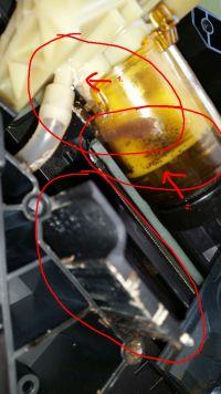

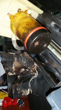

    No damn thing .. and because I like to fix everything myself I stripped the express. And here such a view after returning from the site. ECAM 23.460.S - Water in Grounds Container Returns: Hard Water, Clogged Nozzles, and Descaling
    I dismantled and now as you can see in the pictures there is a massacre (sometimes I had the impression that in the coffee grounds container one coffee half the water went into the cup half the container.) You can see that there is a leak or from a hose (from the heater side you can also see splashes of water everywhere) or from this yellow something (unless you are mistaken it is a thermoblock) I stand in the place I don't know what to order. Should there be water in this yellow container ??

    It should not be..
    The manufacturer recommends replacing the complete generator, however, unless it is cracked inside, which happens very rarely, you can replace it yourself in the middle of the O-ring, but this is a lot of work ..
    The water in the grounds container probably leaks from the brewing unit connection.

    The brewer looks quite good, only in those places where I marked 1 can you see a larger stone. So either he sprays water from this hose or I don't know anymore. I will also replace this red O-ring which is at the end of the generator and I will see that I can put on a hose clamp.

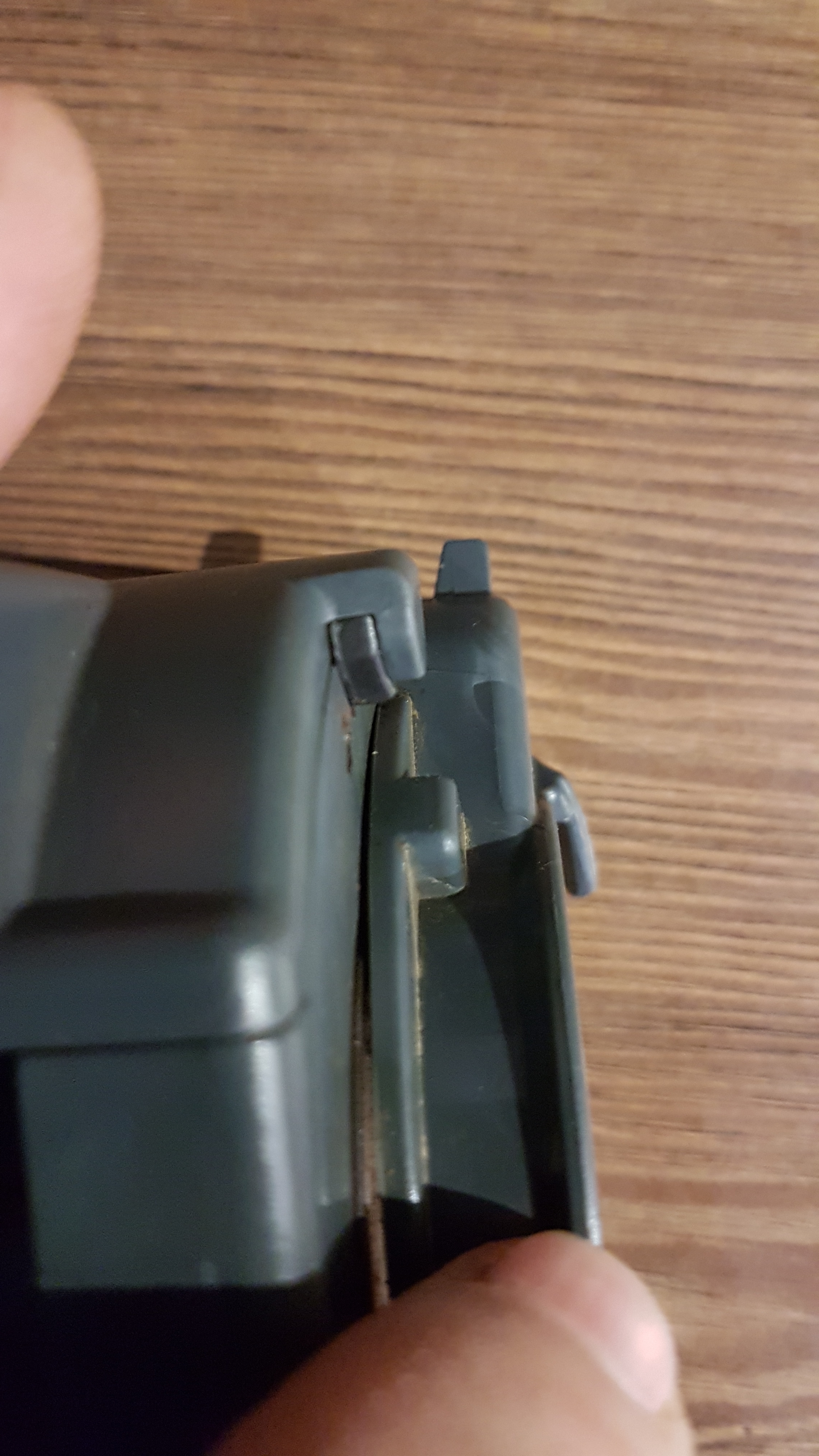

    I have a similar problem, but I see that when rinsing the coffee machine drips when it turns on the grounds container. The second thing is, if the brew unit turns up, it is inside a rubber band a few mm wide ECAM 23.460.S - Water in Grounds Container Returns: Hard Water, Clogged Nozzles, and Descaling
    I fell out and I don't know where to push it.

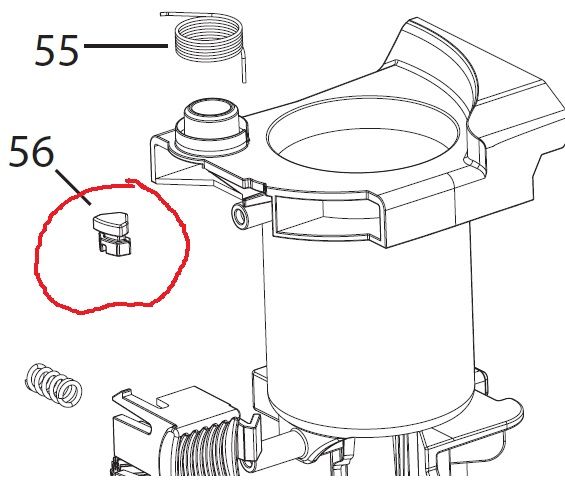

  • #5 17662513
    1piotrekost
    this eraser you push into the notch that you can see in the picture opposite this eraser ECAM 23.460.S - Water in Grounds Container Returns: Hard Water, Clogged Nozzles, and Descaling
