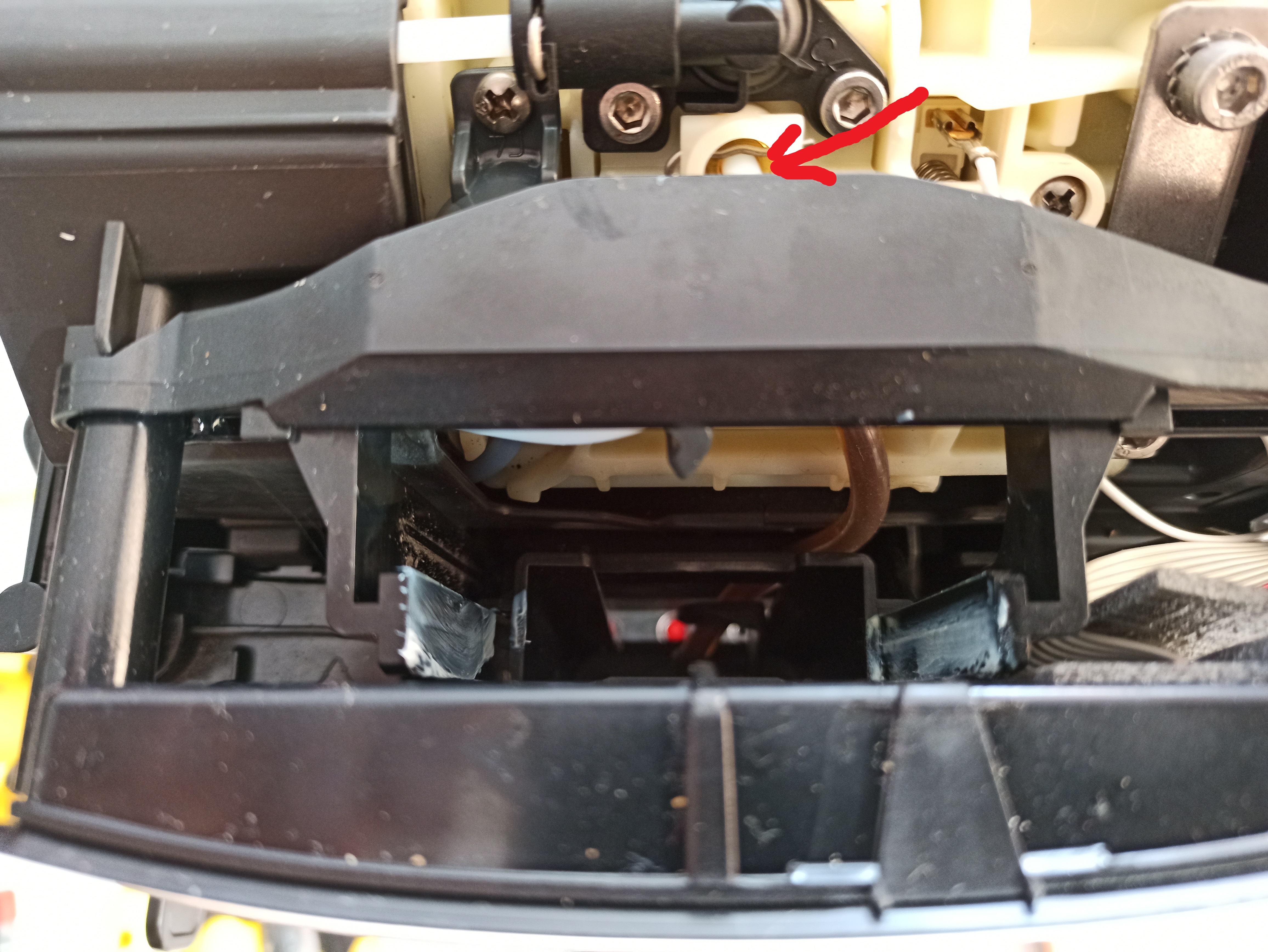

  • #10 18587478
    krzysztof.jask
    Posts: 39
    Rate: 20
    In test mode, the pump works as in the video. Or it starts loudly, which is probably fine, and then immediately chokes out. I checked the rubber hoses except the last one for coffee because I don`t have access to it. Are these hoses also thinner than water or only air?

  • #11 18587568
    sorier
    Level 30  
    Posts: 1099
    Help: 166
    Rate: 635
    All snakes are water.
    The pump is supposed to work this way, the higher the pressure, the quieter it is.
    Unfasten the hose at the boiler outlet and turn on the pump.

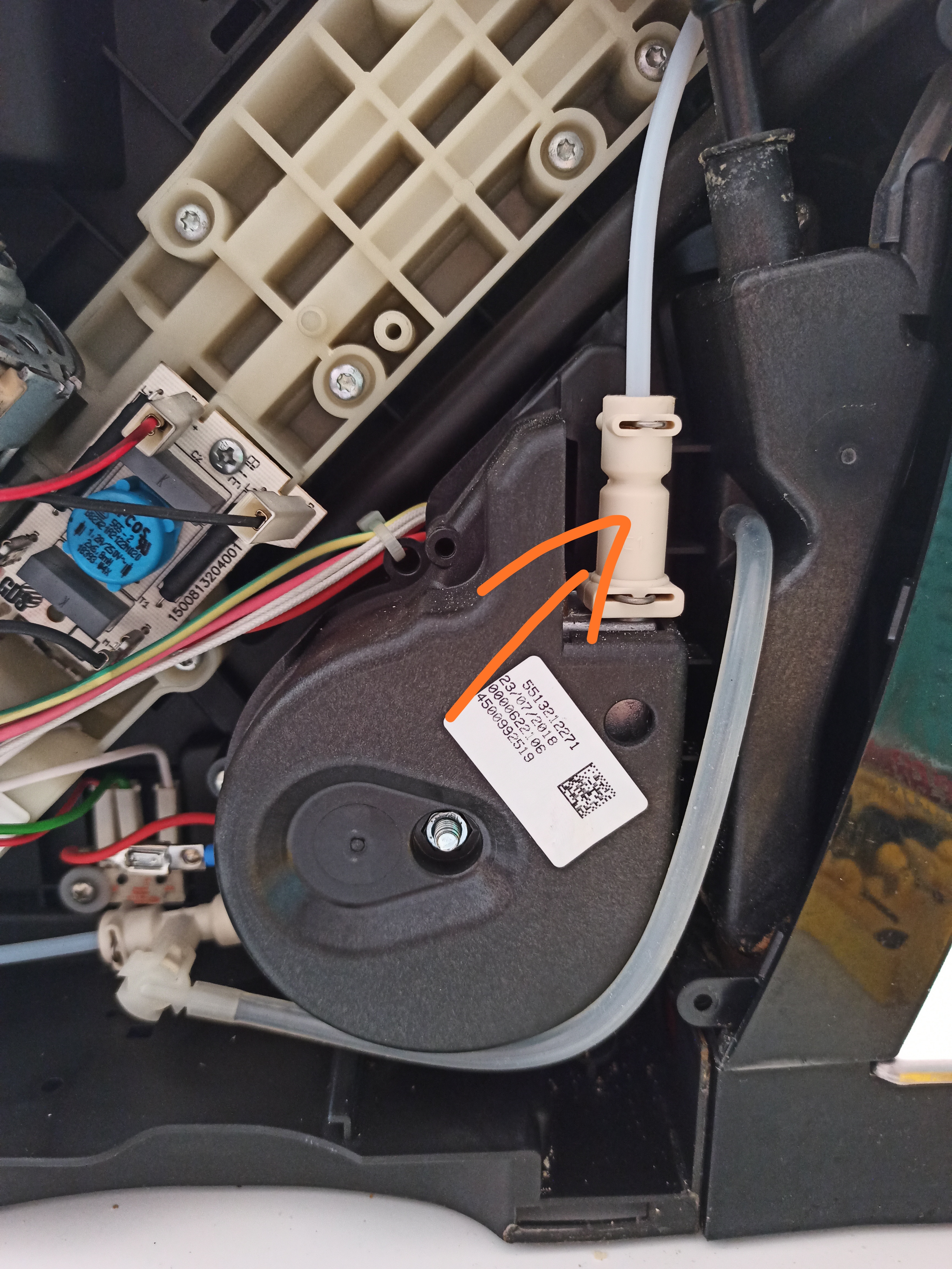

  • #12 18587723
    krzysztof.jask
    Posts: 39
    Rate: 20
    Is this about the snake?

  • #14 18633873
    krzysztof.jask
    Posts: 39
    Rate: 20
    After disconnecting the hose from the boiler outlet, water flowed. I pulled out all the hoses. I pushed one of the end hoses through with a needle and it works. The culprit in the attached photo. Thank you for your help.
