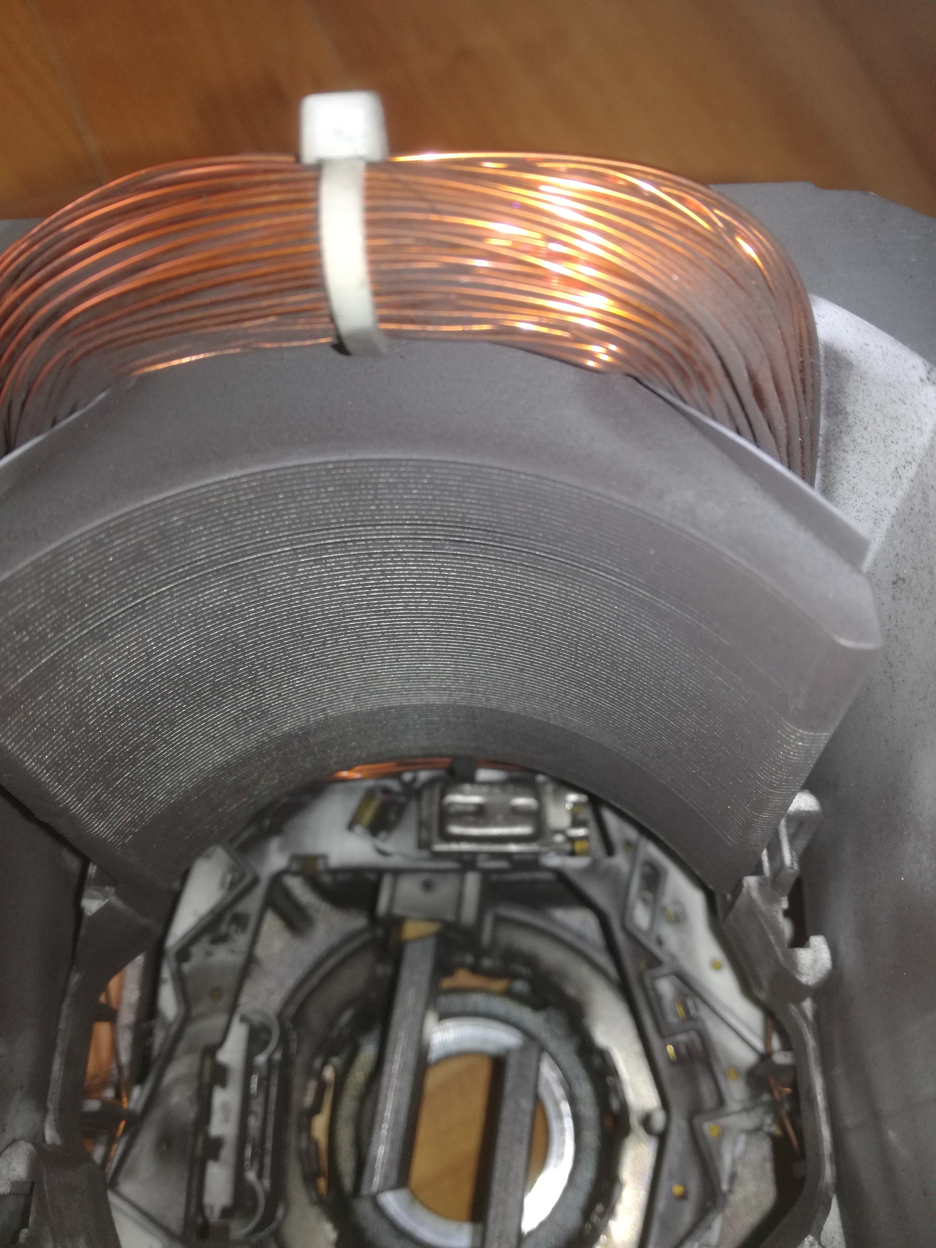

    I got into the module and there are burn marks on it.
    Is it possible to repair such a burned path, e.g. putting the person in charge of it for service?

    Hello. Send photos of the module from both sides, maybe these burns are really brush dust. I bet on the motor, after connecting to the battery, it should spin when it is well connected, we connect the windings in series. It's also worth taking a look at the commutator, you can also send its photos.

  • Photos show soot on control module and motor
    #8 16854403
    Mediv
    Posts: 6

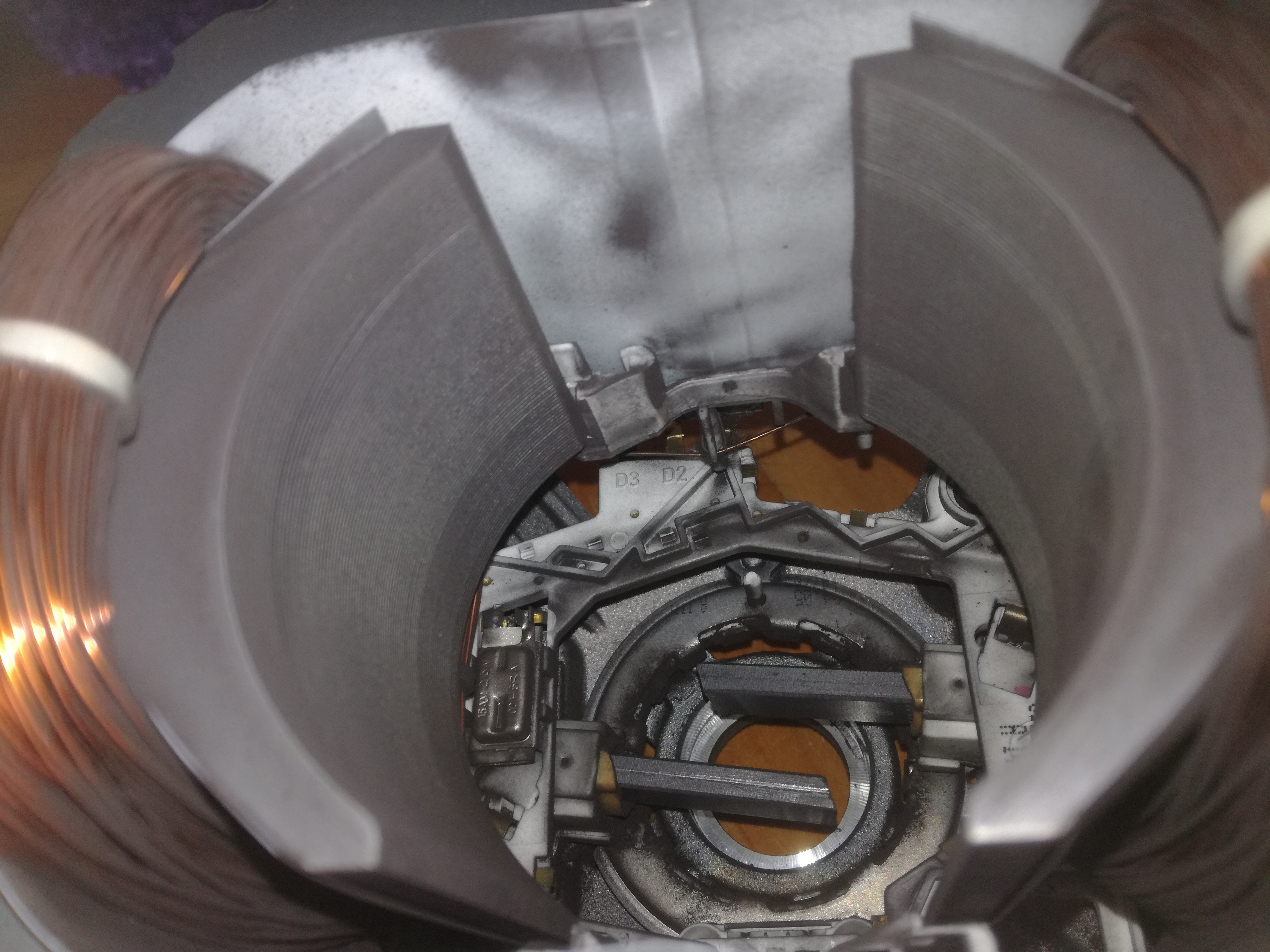

    Photos of the module, parts with visible soot.
    Spoiler:
    Bosch WAE24162 washing machine - does not spin, does not spin the drum Bosch WAE24162 washing machine - does not spin, does not spin the drum Bosch WAE24162 washing machine - does not spin, does not spin the drum Bosch WAE24162 washing machine - does not spin, does not spin the drum
    And here's the engine.
    Spoiler:
    I have corrected TONI_2003 :arrow: (don't have fun when you can't) :D

    Take photos from the print side.
    Smudging is not a damage. It is always done in such a way that the higher voltage current will be "blackened" due to the electrostatic action of the paths (an electric field is created around the paths).

    Thoroughly vacuum the module and motor. It is best to remove the brush holders.

    I thought that such an amount, let's call it soot, is a burnout as a result of some short circuit.
    It is enough to wipe it dry just to get rid of the raid?

    And in my eye it is probably a burnt rotor, the fourth photo from the end on the left. Rotor to be checked by the bank.

    Have you checked the thermic on the engine? It is located in the part where the brush holders (brass guides) are mounted.

    The engine was to blame, after installing the used replacement, the washing machine washes and spins.
    The thermic seems to be ok. I would like to diagnose exactly what was damaged there, but I don't think I can do it myself.
    I still have a question. The first thing I checked when the washing machine stopped spinning was the motor and the condition of the brushes. These were very short. I was sure that it would be enough to replace them and the trouble.
    Could the engine be damaged / burned because the brushes were too short (plugs fell out then) and there was a short circuit, engine overload and consequently damage?

    And in the old motor you cleaned the commutator?, It would be best to clean it and polish it with sandpaper. Then blow everything out with compressed air. But as written above, the rotor was probably damaged due to the weak pressure of the brushes, sparking and heating up the whole thing until it was punctured and short-circuited. But you can always try to recover.
