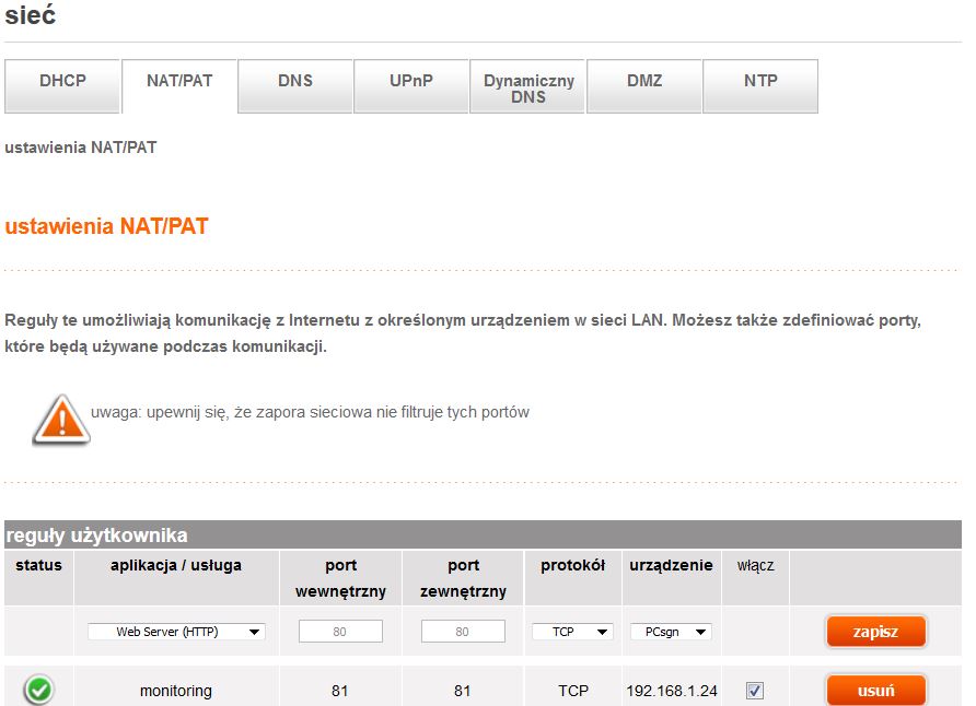

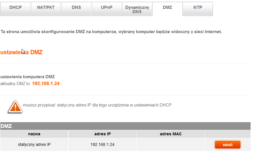

    I know that similar topics appeared but unfortunately I did not find an answer. After connecting the IP camera (Overmax camspot 3.3) to the Livebox via cable, port forwarding, DDNS setting, the camera image is visible from outside from any device (computer, telephone). The situation was complicated when I disconnected the LAN cable from the camera - then it is visible only inside the network. And the question arises - is it the fault of the camera or maybe I have set something wrong? I've included screenshots. I will be grateful for any help!

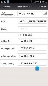

    Did you check if the camera's radio interface has no separate address? Because logic should be like that.

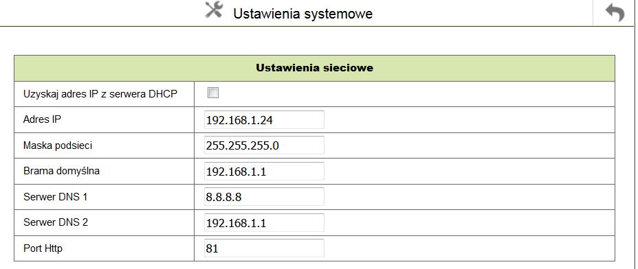

    jomaz
    Posts: 8
    I checked and found the camera settings just like in a screenshot. Only what's next? please forgive me but I am a little layman in this topic.

    But it's probably some network settings for the camera to act as an AP or "spreader" of a wireless network. There must be a configuration somewhere as a client or receiver so that you can connect to your wireless router.

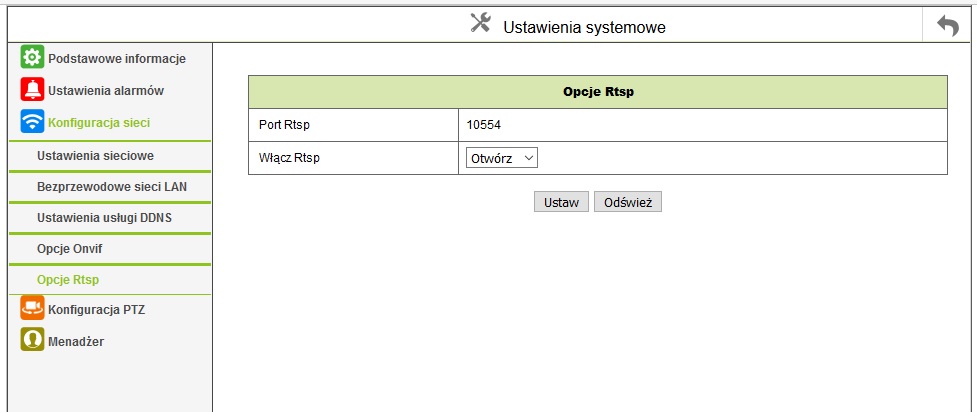

    I am afraid that this camera simply does not have this function. The only thing I got to is the RTSP option which is set as follows
    • Overmax Camspot 3.3 IP Camera: Accessing Live Feed Remotely via WIFI & DDNS on Livebox rtsp.jpg (55.95 KB) You must be logged in to download this attachment.
  • #6 16548282

    RTSP is a video stream that you can send on the network.

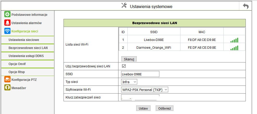

    What do you have in the Wireless LAN tab.

    You bought - you did not buy. This is how I start to realize my question from the beginning, whether the sense of further burying in the settings is meaning, because I can stay on the cable itself. Capture from wireless networks.

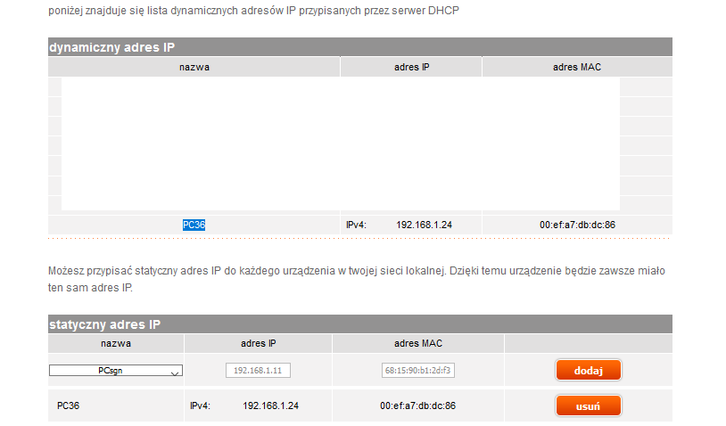

    Well, you click on the network with Livebox and enter the password to secure the wireless network and click Set, Did you do it?
    Also show network settings. Did you check if the camera got an address from the router's DHCP? It should be in clients.
  • #9 16548415
    jomaz
    Posts: 8
    1. I did it
    2. Like a webcam connected on a cable, it appeared in dynamic IP (PC36) and I assigned it permanently to IP. As it is on WIFI it disappears from the list of dynamic IPs.
    • Overmax Camspot 3.3 IP Camera: Accessing Live Feed Remotely via WIFI & DDNS on Livebox dhcp.png (17.86 KB) You must be logged in to download this attachment.

    Did you check if this permanently assigned IP address corresponds to?

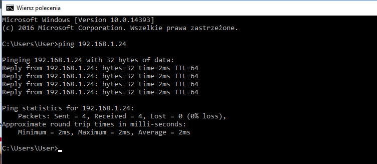

  • #11 16548477
    jomaz
    Posts: 8
    it seems so
    • Overmax Camspot 3.3 IP Camera: Accessing Live Feed Remotely via WIFI & DDNS on Livebox cmd.png (16.71 KB) You must be logged in to download this attachment.
