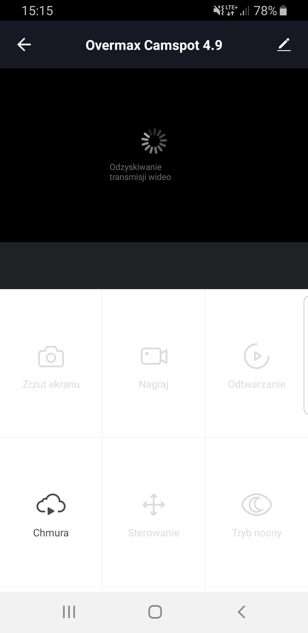

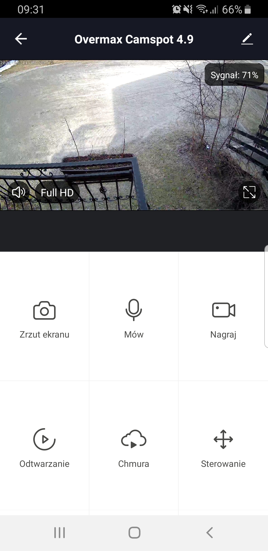

    I bought an outdoor IP camera overmax camspot 4.9.
    The problem is that in the overmax control application I sometimes have access to the live view and sometimes I don't. I've tried wired and wifi and it's the same. I called tech support and ISP. Ports 80 and 81 are unblocked. The internet provider claims that I need to have an external IP assigned, and I would have to pay PLN 5 monthly. But why does it sometimes hit the live preview and this preview is? Please help. Pictures add working preview and not working. Overmax Camspot 4.9: Inconsistent Live View Access in Control App (Wired & WiFi)

    How did you add the camera in the application using the QR code?

    If the cable is autoscan. If on wifi then via qr code. So I think it's correct.

    To have a preview from the outside, did you add it using a QR code? If so, it connects to the cloud (p2p) through the manufacturer's server.

    Now I have it back on the cable and gave it through the scan. Yesterday I was on wifi and scanned the qr code and the same thing happens.
    Once I had a cable and qr I scanned and it worked once, once not.
    Added after 37 [seconds]:
    You know what I gotta do? what do you advise?
    Added after 5 [minutes]:
    So I have to buy a cloud subscription to have a live view of what's going on?

    So the problem is the manufacturer's servers that work as they please.
    Take a look at Dahua IMOU.

    So it turns out that overmax is a crap company, i.e. I would have to buy another camera ... Because I can't do anything with this one?
    Added after 3 [minutes]:
    So if I bought a camera from this company Dahua IMOU, it should flash without a problem? And orllo company outdoor cameras would be good too?

    Unfortunately - Overmax is not a top-flight company.
    Dahua is one of the largest companies on the market and I am not the only one who installs them on a daily basis.
    Orllo is another invention like Overmax...
