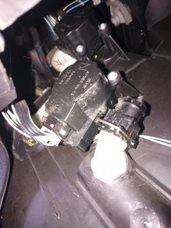

  • #11 16973869
    obadaw
    Posts: 83
    Rate: 18
    Do you have a manual how to get to such an actuator from the passenger side ??
    Added after 19 [hours] 27 [minutes]:
    Peugeot 307 2.0 16V 2003 - Warm air supply is working / not working
    A little update, I got to these modules. And both of the modules shown in the picture work properly after changing the heating.
    The photo does not show 3 which is even higher. But if this is this module, which one controls the temperature, which one to turn on?
  • #12 17070751
    obadaw
    Posts: 83
    Rate: 18
    Hello again, today I checked all the heater's motor regulators and they all work properly, they are not broken or the tips are machined.
    So it probably remains to replace the fuser, right?
  • #13 17070781
    Pedros050
    Posts: 17914
    Help: 2471
    Rate: 3927
    If it does not heat up, check what are the heater hoses, especially on the return, if hot, then rather functional. If it is summer, there is no circulation to replace it or it is stony and heats poorly.

  • #15 17087210
    obadaw
    Posts: 83
    Rate: 18
    The replaced heater with a new twin-pipe that goes directly to it. The heat returned :)
