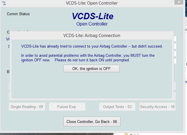

    I dismantled the vents grille, disconnected the airbag cable from it and then mistakenly turned on the ignition to check the radio. After the yellow light appeared on the board, I decided to clear the error. The most ordinary cable than viakena + vag-com. I do not remember whether the error was in the first tab or in 15 - airbag, but I deleted some error. Maybe a pillow error or maybe a throttle error (sporadically appears when driving lpg - never mind that).
    The error is cleared and the light stays on. Viakena cable in hand + vcds Lite ... And I can't get to the Airbag tab. When trying to communicate with the airbag controller, the following message appears:
    Golf V, 1.4BBCA - Clearing the airbag error - light on despite no errors
    Of course, I turned off the pillows with the key in the glove box. I followed this message. I turned the ignition off, confirmed the message, waited for the next window to count down 30 seconds, then information about turning the ignition on appeared - and then the same. No controller detected: /
    There are no errors when scanning all groups. Now the question ... what am I doing wrong?
    I turn on the ignition - the airbag indicator is on. It goes out for maybe half a second and then lights up again. Could I have damaged the driver while deleting the vag-comem error instead of vcds? I don't know anymore, help me: /

    With this cable you can remove errors in the engine, nothing more. You don't even know where or what you deleted -

    But there are also airbags and a K + line in the connector. I understand that I need a cable that supports CAN or K + CAN and Vag-COM or VCDS for this?

    exactly after can srs

    Beer for a friend. VAG002 dealt with the pillow error :)
