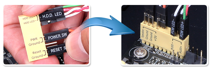

    Speaker, buzzer, system speaker - this can be translated from any PC, even an antique one. You connect the speaker to the output (in the manual you will find where it is together with the picture) On ASUS it is in the same place as the HDD LED or the power button connected. If you have the so-called quick connector on the disc, everything is described there as well. Computer Starts, Fans Spin, No Display: ASUS P5Q, Geforce 9600GT, DDR2 RAM, Tacens Radix V-550 PSU
    The layout has been the same for years - here you have it described as sound and grand. The width of the plug is typically 4 pins. I'm not sure if polarization matters, but if the speaker has colored cables, it's black to sound and red (or whatever) to 5V

    Unplug everything - leave the power, CPU, CPU cool and speaker. Start by shorting the PWR pins for a moment, e.g. with a screwdriver.
    If the speaker is still silent, the disc or power supply probably damaged. So you substitute a different power supply and the same test. If you are still silent, you can try to substitute another CPU (even the cheapest C2D) then you will be sure that the disc has fallen.

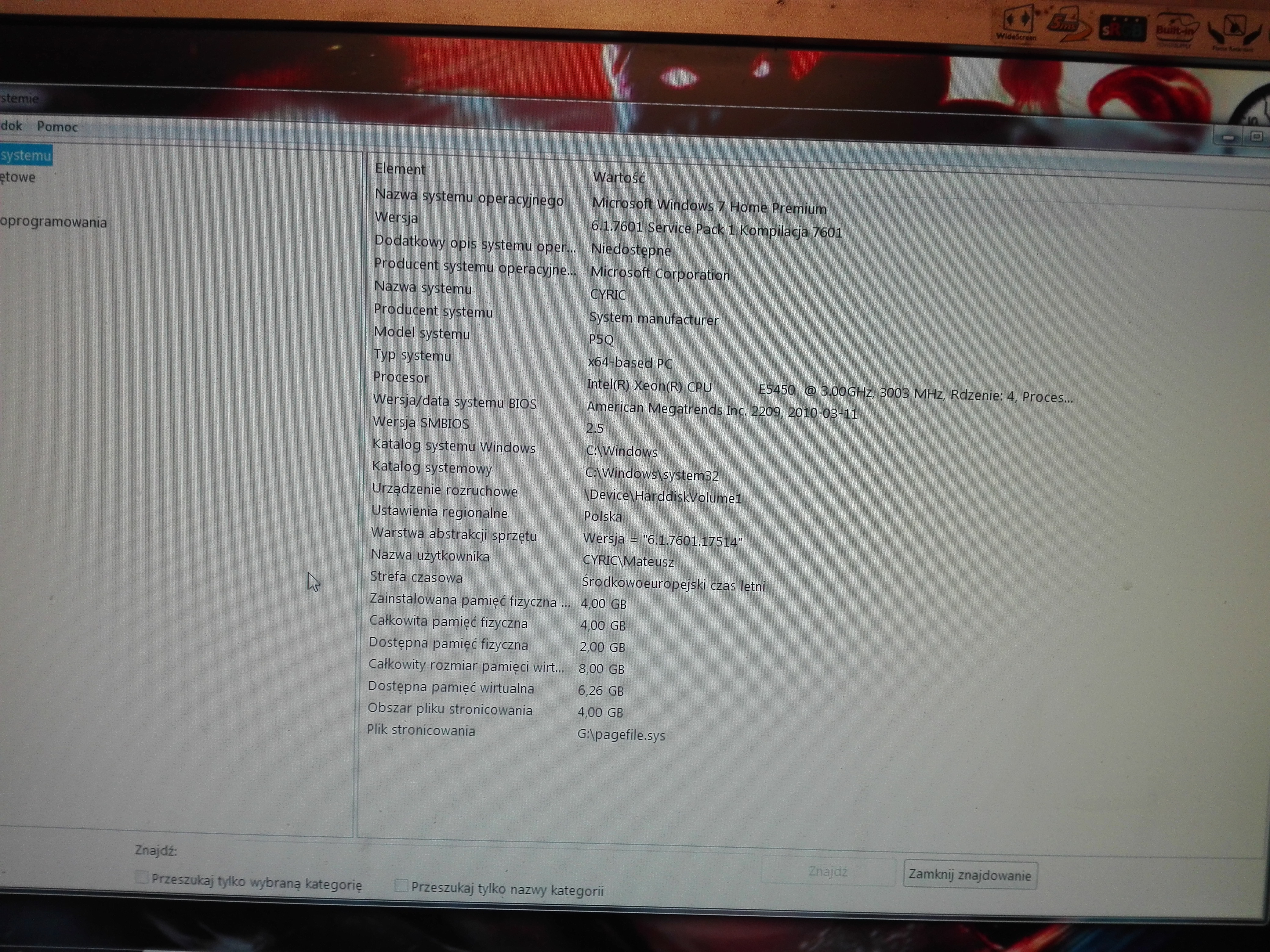

    After turning on it worked for 5 minutes and then it hung, so the reset and now works normally except that I have no sound. It turns on a little longer now, if you need a screen, I can send it.

    How do you arrange RAM? Two identical modules in one-color slots? Do I understand correctly that it only works with 2 different modules?

    And only half the memory works.
    Have you reset the BIOS?
    It looks like the motherboard has fallen. If you can run it somehow, give screen from HWiNFO from sensor only mode. Maybe something is warming up.

    Yes, I reset the bios at the beginning, yesterday I could fire up and today, like everything starts windows and suddenly freezes or there is a black screen and only the cursor flashes. I think I'll take it to check, cost 10-20 PLN and I will be sure what the reason is.
