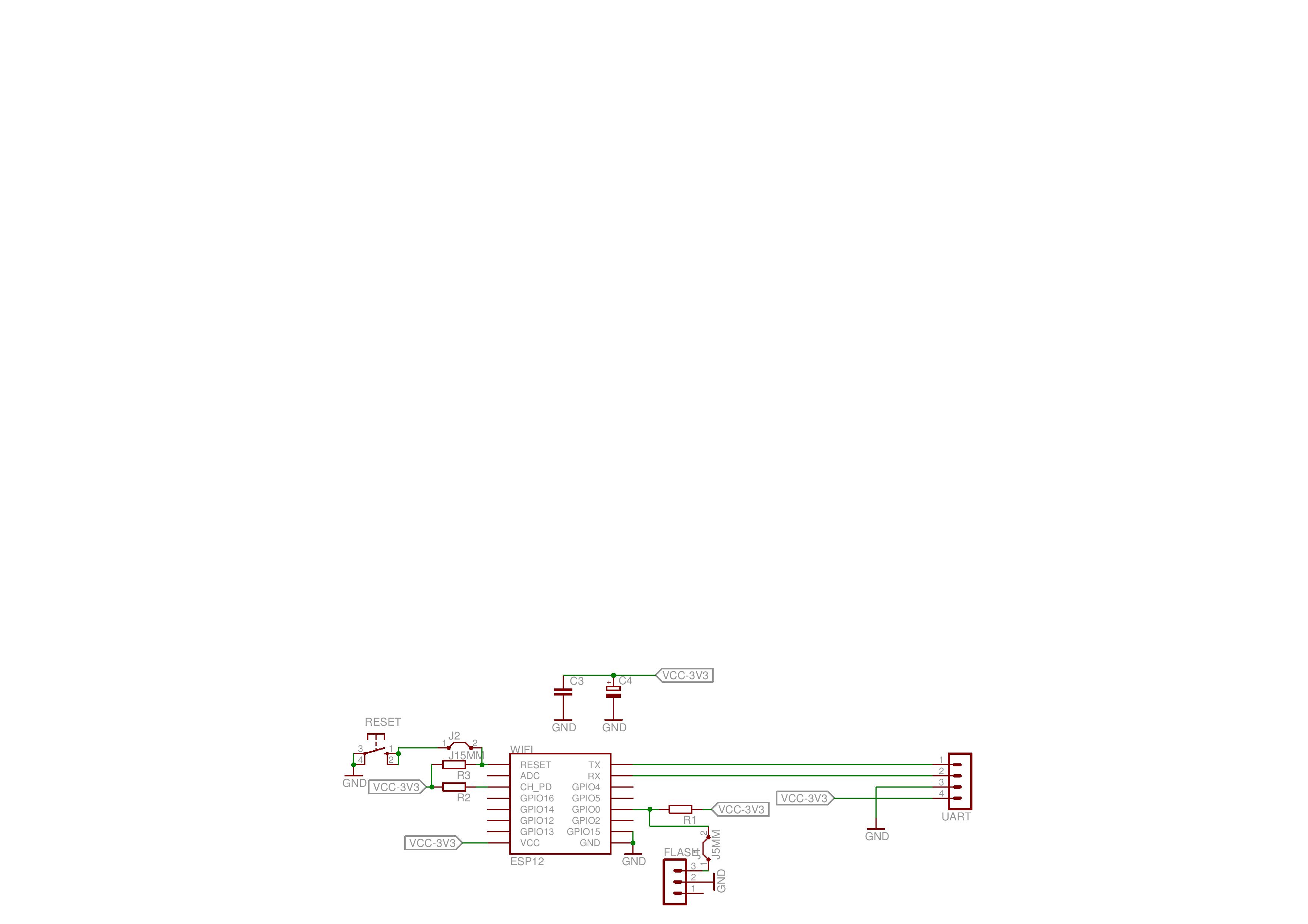

    I wanted to replace my ESP8266-01 connected on a "spider" with a board. The ESP8266 sends data to Thingspeak in the future to the Domoticz base. As I have more pieces of ESP8266-12 I made a board for it. The board according to the schematic below:
    ESP8266-12 crashes after sending data to Thingspeak - wiring diagram .
    Unfortunately, after swapping the spider for the board, the circuit crashes after the first send - always at the same time, after the send. You could blame it on the code, but the spider on the same code works. As for this simple schematic, I have seen several versions - I used the one that occurred most often. All the resistors are 10K.
    I have come across a version where CH_P is without a resistor to VCC, and GPIO15 via a resistor to GND.
  • #2 16566444
    marmon
    Posts: 317
    Help: 13
    Rate: 30
    try connecting GPIO16<>RST
