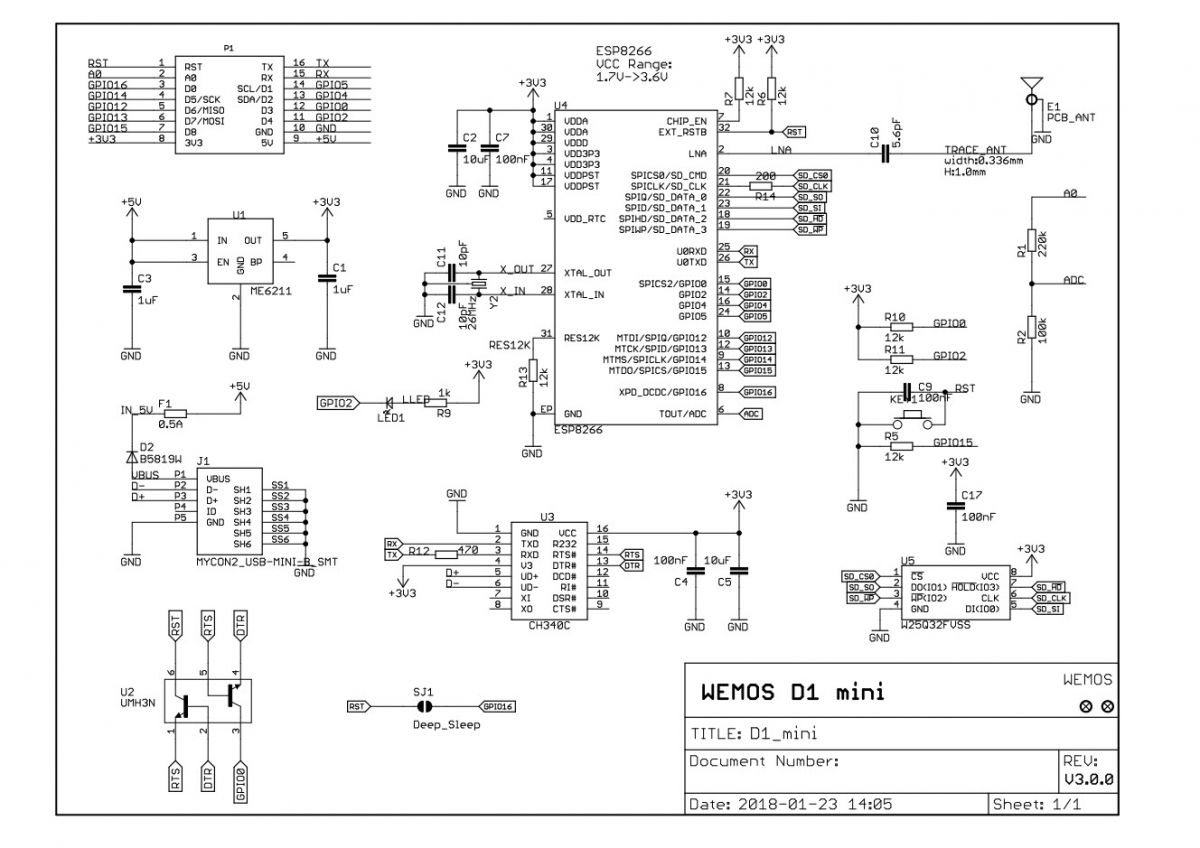

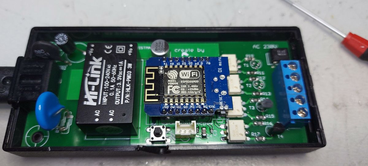

    Colleagues! I made such a controller (controls 4x LED strings on 230V). Controller with option: WiFi + IR - so for convenience.
    Some time ago a prototype was created on a universal board. And once I got to grips with the software, I decided to design the PCB. I ordered the boards from jlcpcb.com.
    When the boards arrived I assembled 1x copy and flopped. A whole Sunday wasted looking for a bug. Unfortunately I failed.
    Well, the problem is very strange. Assembled circuit:
    ESP8266 - no start-up after soldering resistors R3 and R4 in the LED driver .
    It does not want to start when resistors R3 and R4 are soldered in
    here is the schematic:
    At first I thought it was some error in the PCB design: a short circuit, missing ground, or a faulty component. So I checked the PCB for possible short circuits, replaced the thyristors, MOC3041 optotriacs and no improvement.
    I figured I would connect the Arduino serial monitor and eavesdrop on the transmission. Unfortunately no connection could be made.
    When I pull the ESP8266 out of the cradle, the module itself starts up and then draws 78mA (which is about the same as the working prototype) and works fine (connects to WiFi).
    But when I put the ESP8266 module back in the cradle and apply power, the chip draws about 46mA
    I conclude that it crashes on startup.
    I don't know what is!
    I have checked the power supply.
    The problem goes away when I unsolder R3(D3) and R4 (D4)
    The difference between the prototype is that in the prototype there were 4x Leds in place of the optotriacs and the power was taken from the USB of the computer. I also noticed that in the prototype the Leds at the output of D3 and D4 always flash briefly on start-up

    A mistake in the projection, as you have already pointed out. Check what the manual says about pulling down to ground these two pins during startup.

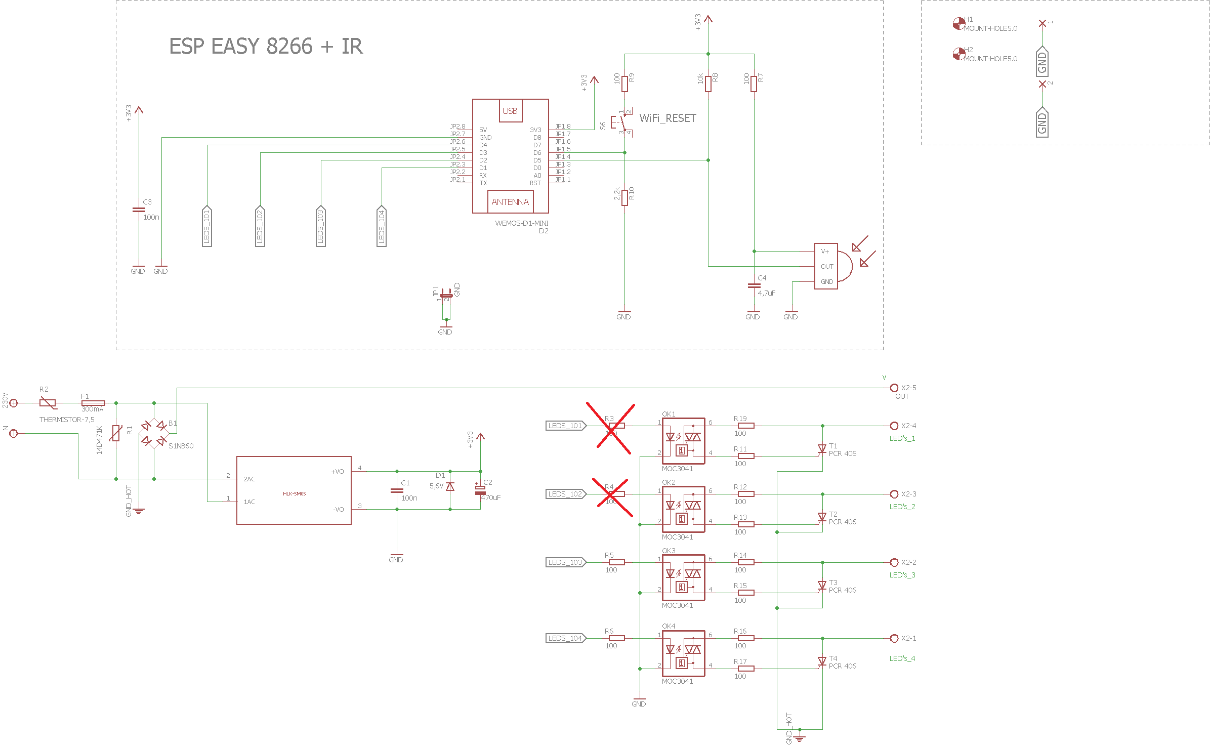

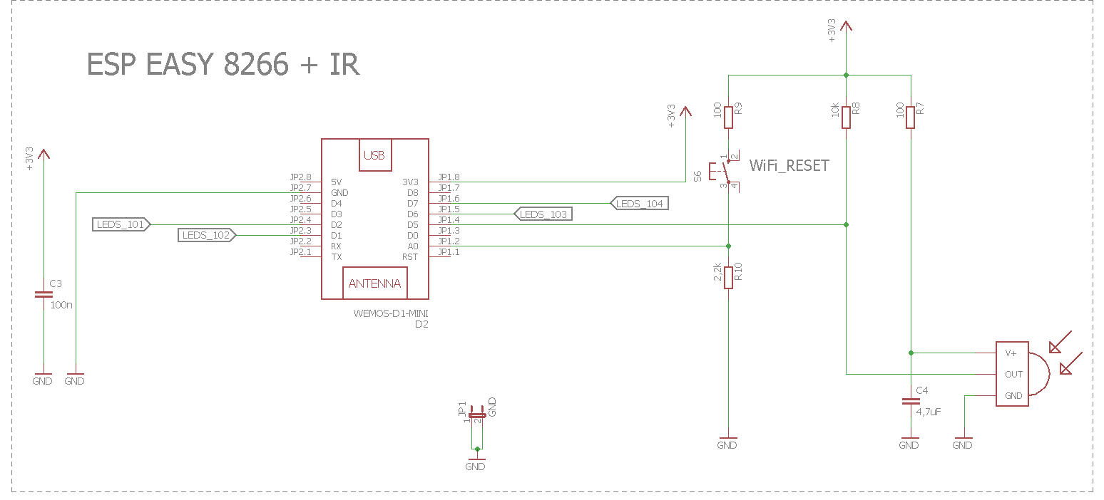

    Thank you all for your valuable comments.
    I actually changed the program and connections in the circuit and the whole thing started working properly.
    Unfortunately I used all GPIO outputs
    And I need to have WiFi RESET functionality. For this purpose I was using 1x PIN and when HIGH state appeared on it, the program was performing the function of resetting the settings from WiFi.
    Can I use PIN A0 in this situation?

    tos18
    Level 42  
    Posts: 7140
    Help: 1113
    Rate: 1870
    maystero wrote:
    Unfortunately I have used all GPIO outputs
    And I need to have the WiFi RESET functionality.
    You can reset the wifi with a command from the IR remote control

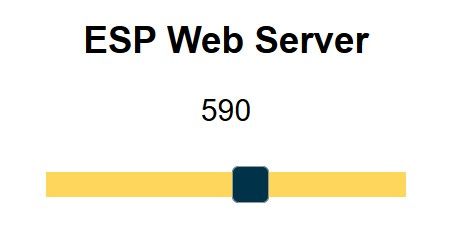

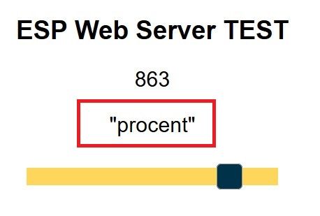

    Gentlemen again please help. I cannot get to grips with the code.
    I am rewriting,the code from the website:
    https://randomnerdtutorials.com/esp8266-nodemcu-web-server-slider-pwm/
    Nothing complicated, yet. The code after compiling and uploading to the ESP works immediately. Typing in the ESP8266 IP takes you to an interface with a slider where you can set yourself the PWM value. The result is displayed from: 0 to 1023
    I am trying to figure out how to make it display the result in %.
    e.g. 10% or 100%
    I got help on the forum and added a line like this
    Code: C / C++
    Unfortunately this does not work with my assumption. I wanted between
    Code: C / C++
    display the result of the variable "porcent"
    and it does not display
    in the serial port monitor shows correctly:
    Code: C / C++
    What am I doing wrong?
    How do I bite it?
    oh this is my code:
    Code: C / C++

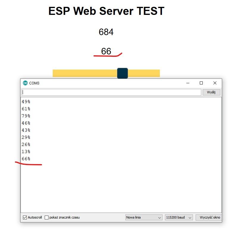

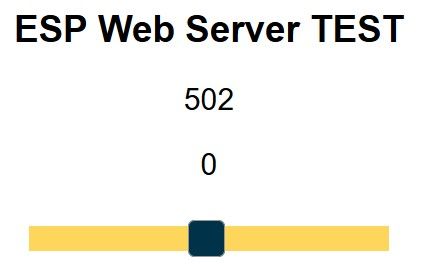

    I think I have poorly explained what the problem is....
    The problem is that EST is not displaying me the PWM value in %.
    Instead of displaying the wattage of the variable percentage it displays the text
    "percent"
    I don't know how to modify the part that is responsible for displaying this information.
    Template processor for SLIDERVALUE and procent placeholders
    Continues not to display string percentage
    constantly shows 0
    Added after 2 [hours] 4 [minutes]: .
    After testing the code some more and it looks like it works!
    The current percentage is shown when I refresh the page (F5)
    i.e. I think something still needs to be improved....
