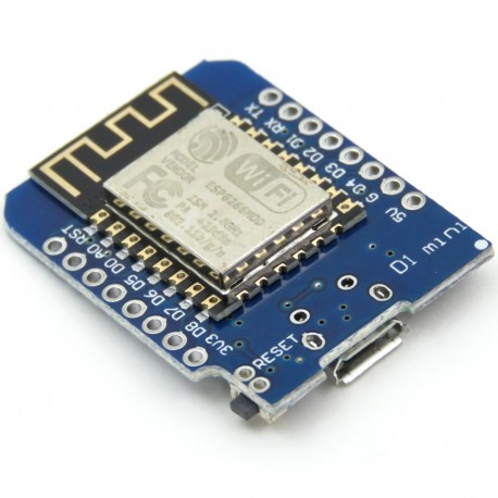

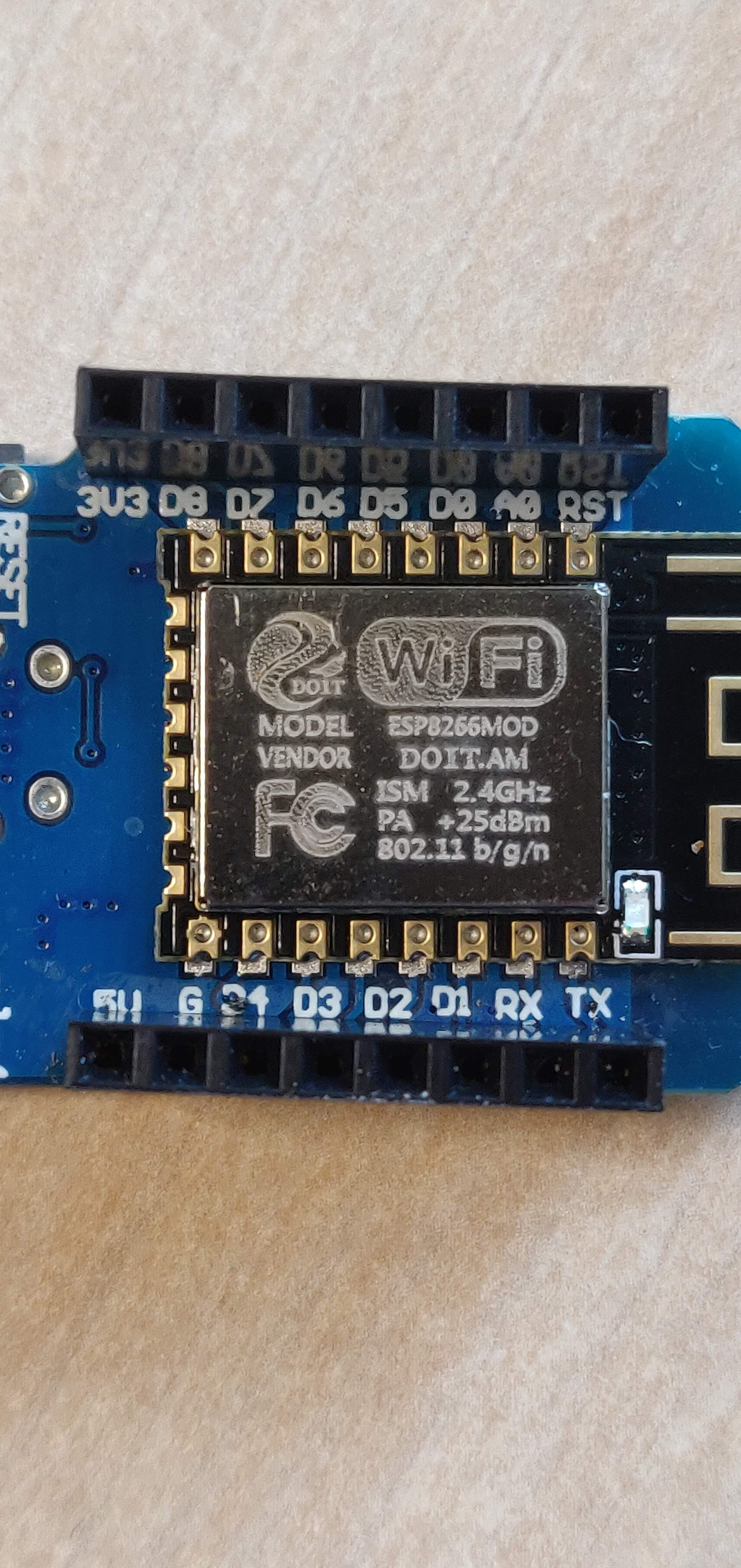

    sen_soltysa
    Posts: 10
    This is what the board looks like up close - can anyone take a peek: https://photos.app.goo.gl/tBWyDVT9Ks8JPHi86
    As for this WAKE_RFCAL I have taken it to a lower level ie it also doesn't wake up in an app where there is no wifi. As far as programming goes, obviously there is no D0/RST jumper when uploading the app,

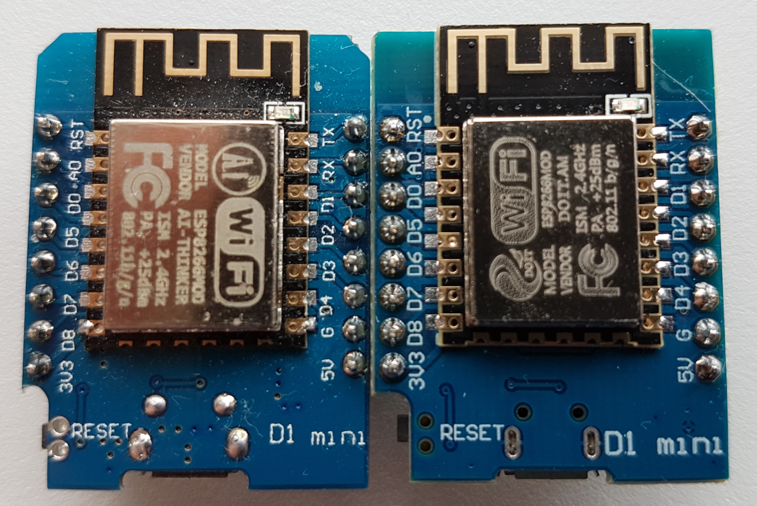

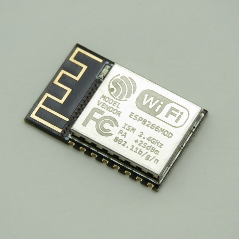

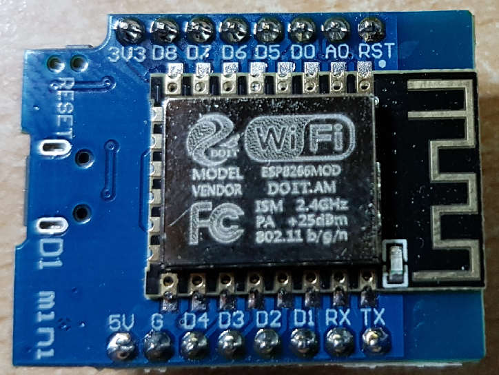

    You can't see much from your photo, but from what I've found out it's a hardware problem, take a peek if your ESP8266 looks like this:
    ESP8266 D1 mini fails to execute code after exiting deepsleep .
    well one of mine looks like this and there is the same problem with it. The reset signal from GPIO16 (D0) is too short and ineffective. Quite a few people have this problem, you will have to be careful when buying, https://github.com/esp8266/Arduino/issues/6007.
    Several people have replaced the Wemos mini board with the ESP module described DOIT - as in the photo above.

    sen_soltysa
    Posts: 10
    This is exactly the chip - DOIT.AM. I read the thread you provided and the same behaviour is described there.
    I can already see that I have to advertise this board to the dealer and look for another one.
    Thank you for providing this link!

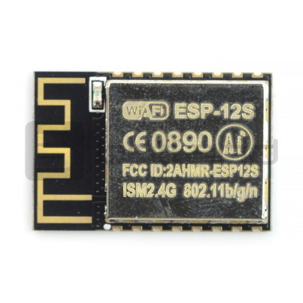

    It's not likely to apply only to the ESP-12S since people are reporting problems with the ESP-12F there (that's where the thread started). It's also hard to tell from the logo on the tin how the chip will behave, as you can probably order with your design ( and necessarily with FCC lettering). It's half bad as I ordered one Wemos module at all in the last year, but some people bought 100 chips there and don't know what to do with them. The ESP-12S module is immediately recognisable from the casing, the flash pins are not routed to the bottom edge. I still have a soldered module on an ESP-12 board and that didn't wake up either, but it was the first one I bought and I just figured that type had it that way.

    I don't know, do you mean that you can recognise it by its appearance in the shop window? I also have a Wemos like the one in photo #16 and the wake-up works OK. There are ESP-12S modules sold on Ali and they are more expensive than ESP-12E or ESP-12F, maybe the economic value is noticed on a larger scale....
    How do you know the one on the right won't work? The shape of the laminate because they saved will also not contribute anything, because I have one without cut corners and it also wake-up works.
    In addition, even if you look at it before you buy it, you still don't know what the module will actually look like. Also, he doesn't test the module immediately after unpacking, as with him with sleeping. But you will have to start.
