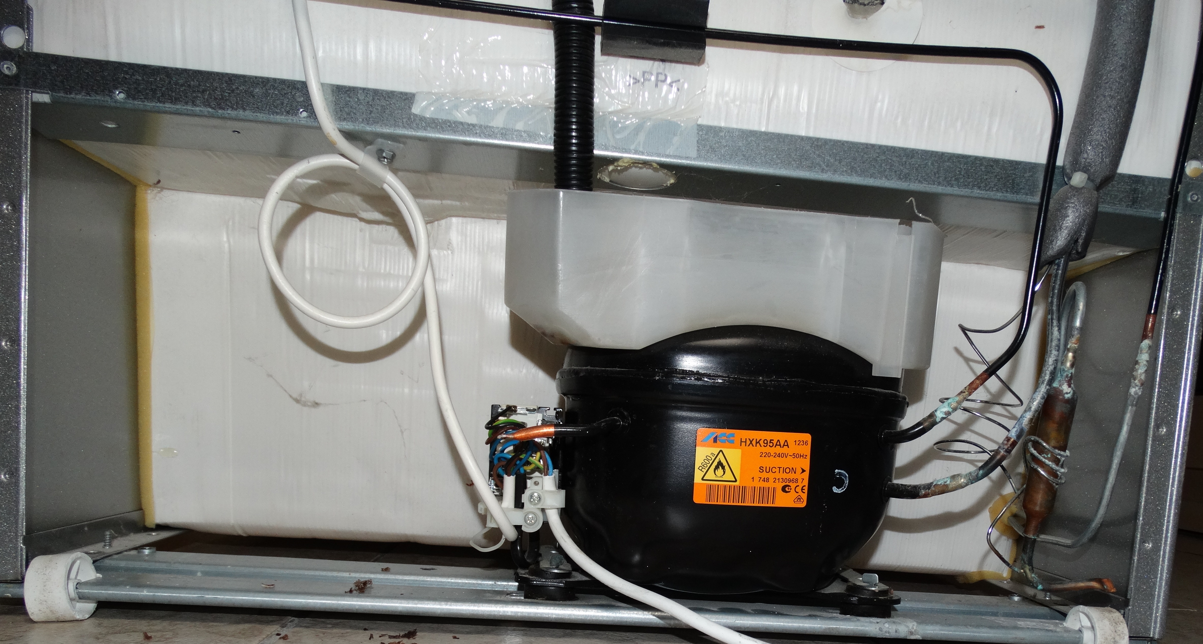

    I bought a used fridge-freezer, it was supposed to work ...
    The freezer works very well, the refrigerator almost at all.

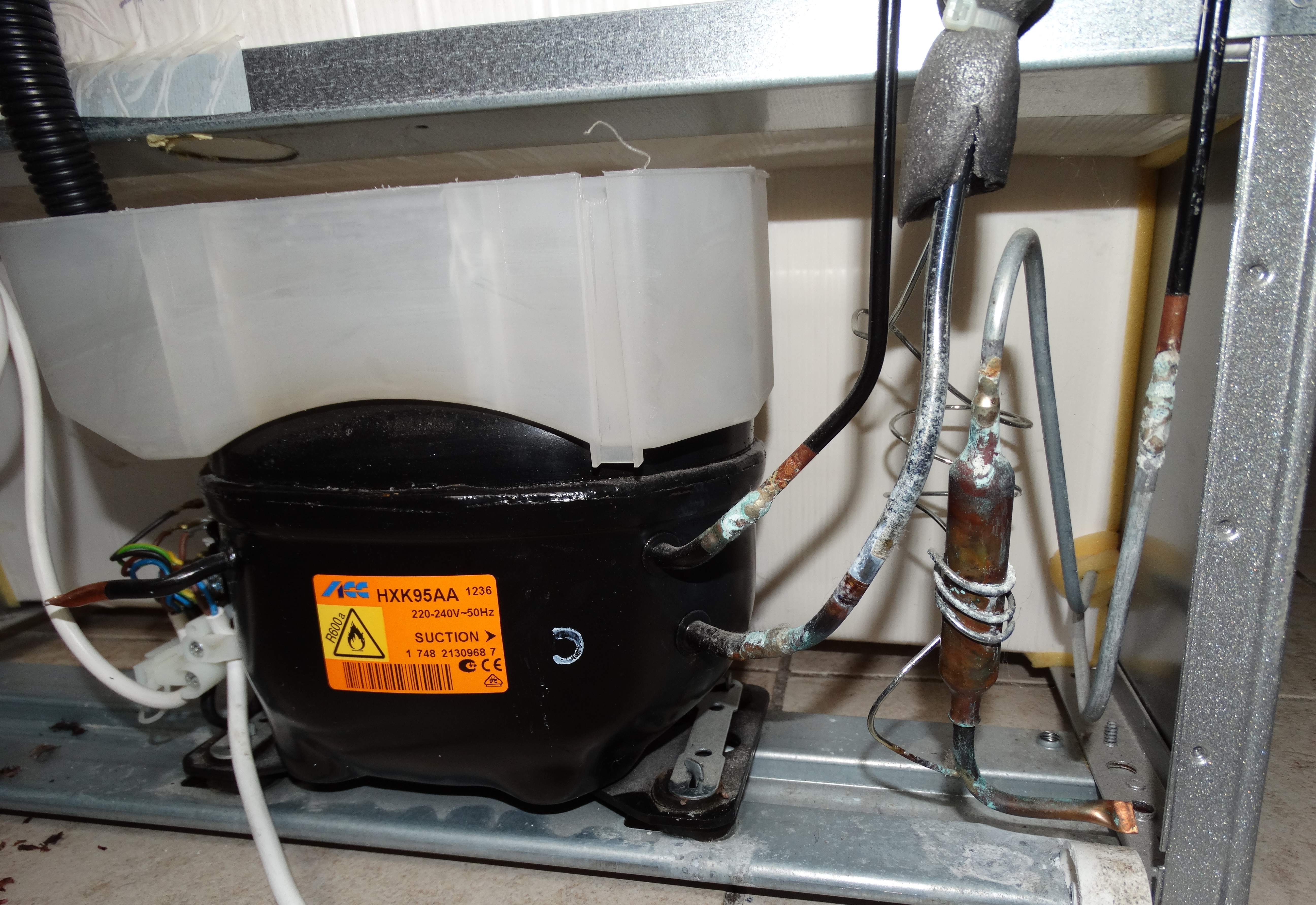

    I put a photo of the back with the compressor:
    AEG S53609CSS0 - The freezer works, the refrigerator does not work AEG S53609CSS0 - The freezer works, the refrigerator does not work
    Can I see that there is one cooling circuit? If so, why is not the fridge part working?
    Added after 5 [minutes]:
    I would like to add that the compressor has been running for 2 hours without interruption.

    You probably have a leaky refrigeration system and there is too little refrigerant to cool the upper compartment.
    A good cooler can be repaired.

    I turned off, waited a few minutes, turned on and the top part of the back panel in the refrigerator was cold, even the water condensed, so it's probably not too little factor?

    Today again after almost 24h I turned it on again and it freezes only part of the freezer ... And yesterday, as I wrote above - after switching it on again was the cold upper part in the refrigerator.

    You've got the most likely diagnosis.
    What more do you expect ???
