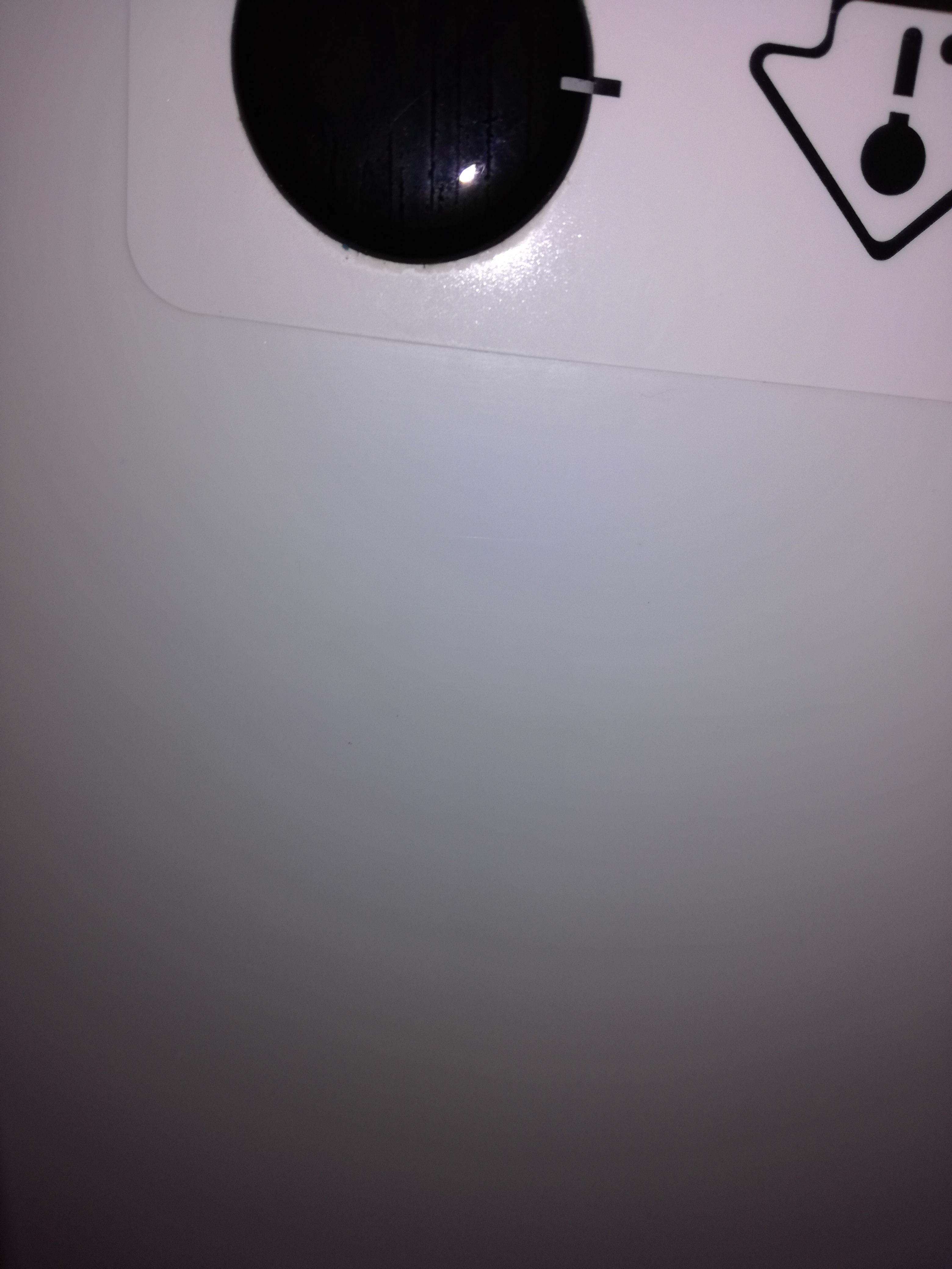

    SZP,
    It rained in the heat on Friday.
    The refrigerator is not cooling, the freezer is working.
    1 aggregate.
    Cleaned, there was no excess dust on the back.
    Defrosted> 24 h.
    Pics below.
    Such a little hollow sound from the refrigerator - a fan?
    Other factors?
    How to undress it and check it?
    Bought around 2007

    What do you understand after the defrost deadline?
    You thawed the entire freezer and turned the fridge back on?
    The freezer is frozen again and the fridge is not cooling at all?
    How long does the refrigerator work in one switch-on cycle?
    If the freezer is frozen, there is probably something in the cooling system and you can't help yourself here, you have to call a service technician.
    In general, very little can be done by yourself in refrigerators. You can replace the thermostat or the bulb yourself.

    According to the service, unsealing - not a profitable repair
    it operated for about 10 years ... maybe a bit less .... apparently such simple electroluxes fell even after 5 ...
    a somewhat deceptive service policy - because the person answering the phone got a description of the situation and probably guessed that 99% of freon leakage, etc., and despite this, he sends an employee who collects PLN 40 does nothing but says that the description of the situation shows that freon has escaped and that no it pays to repair ..
