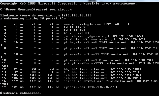

    All pages open to me and the ryanair airport site where I used to work once I bought a ticket and now I want to print this ticket and I can not, it's not the browser's fault because I tried different, a desktop computer connected by a cable to the router and it does not work with this router after wifi on the laptop, this site does not work on the phone, the wifi does not work, and if I turn on the internet on the phone, the mobile phone works and how do I do the router on the laptop also works so the wine is somewhere in my stationary internet or router, does anyone have an idea why this site will not open?
    the internet provider is probably the so-called I enter a flat network cable and I need this provider to provide the MAC address of the network card and now I gave him the address of the router and do not even check if this site works without a router because it feeds the cable directly to the network card is the internet does not work at all I'd like to call the cable TV and give the card's address and the router is netgear jnr1010

    And the message is shown in the browser?
    ping page
    tracert page
    and enter the results here

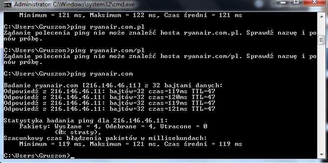

    something like that came out to me and how to enter so what is on the page and as it shows google or at the end of the address is that it did not go out this ping
     Unable to Access Ryanair Airport Site for Ticket Printing on Multiple Devices & Browsers
    no message shows only stands still
    Added after 6 [minutes]:
