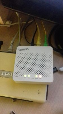

    Hello. Well, one sunny day, wanting to browse olx, it came to me that the site will not load. I thought that's fine. There are some system works and stuff like that. In the evening I wanted to watch the series on ipla.pl every day and here surprise. Nothing will start. Each video ONLY on ipla will turn on, order in 10 seconds and load, load, load. And then the message to change the browser. So I turned off chroma and started Mozille because apparently it is supported by iple, and here still the same error. I will add that ipla does not work on every device in the house connected via wifi. On 3G, the phone has no problem with ipla, olx and all other wonders. It's the same with my bank's application. I won't be able to connect to my account via wifi for a long time. Only by cellular data. Any ideas ? I changed my Dnsy to Google, but it did nothing and my IT skills end here :D

    in general I have an optical fiber that goes to the "box" - ultimode on the wall. from this goes the router cable (H665) from the company from which I have internet. And from their router goes to Tp link to have wifi.

    After doing DHCP on Disable there will be probably a problem connecting to the router now.
    Operation mode should be set to AP Router in this model, the default is AP Client Router.
    To properly set up this router after reset you would need to know the network parameters from Dasana. If you have a computer connected to it with a cable, run a command prompt on this computer, issue the command ipconfig / all and copy the connection information here with Dasan. Ignoring this information, we can do a collision of IP addresses, something will not work and you will not know why, so it's worth taking a moment to do so.

    with gameorplay is another topic, in the anti-virus department, upload logs from FRST and someone will probably help you.
    As for the router, from the reset state (default) you need to change the following things for it to work:
    - Operation mode: switch from AP Client router to AP router
    - Network -> LAN -> Ip Address: set to 192.168.100.10
    It is not necessary to disable DHCP at this stage, it is worth doing at the end. After restart, we enter the router configuration page at the new address: http://192.168.100.10
    Now it's worth configuring your wireless network:
    - Wireless -> Wireless Settings:
    --- Set the SSID to the network name you want to have
    --- Region: Poland
    --- The default channel is 6, blind can be switched to 8, or you can check with the appropriate tools which channel is worth switching to - you can quickly choose 8 and return to the topic a moment later.
    --- check Enable Wireless Security
    --- security type: WPA-PSK / WPA2-PSK
    --- security option: WPA2-PSK
    --- encryption: AES
    Save changes, we now disable DHCP:
    - DHCP -> DHCP Settings: DHCP Server: disabled
    After the TP-Link restart, plug the DASAN cable into any LAN port (not WAN!). After such connection Wifi should work, and at http://192.168.100.10 it will be possible to log in to TP-Link.

    Thank you very much for your help. It has worked and works fine :)
