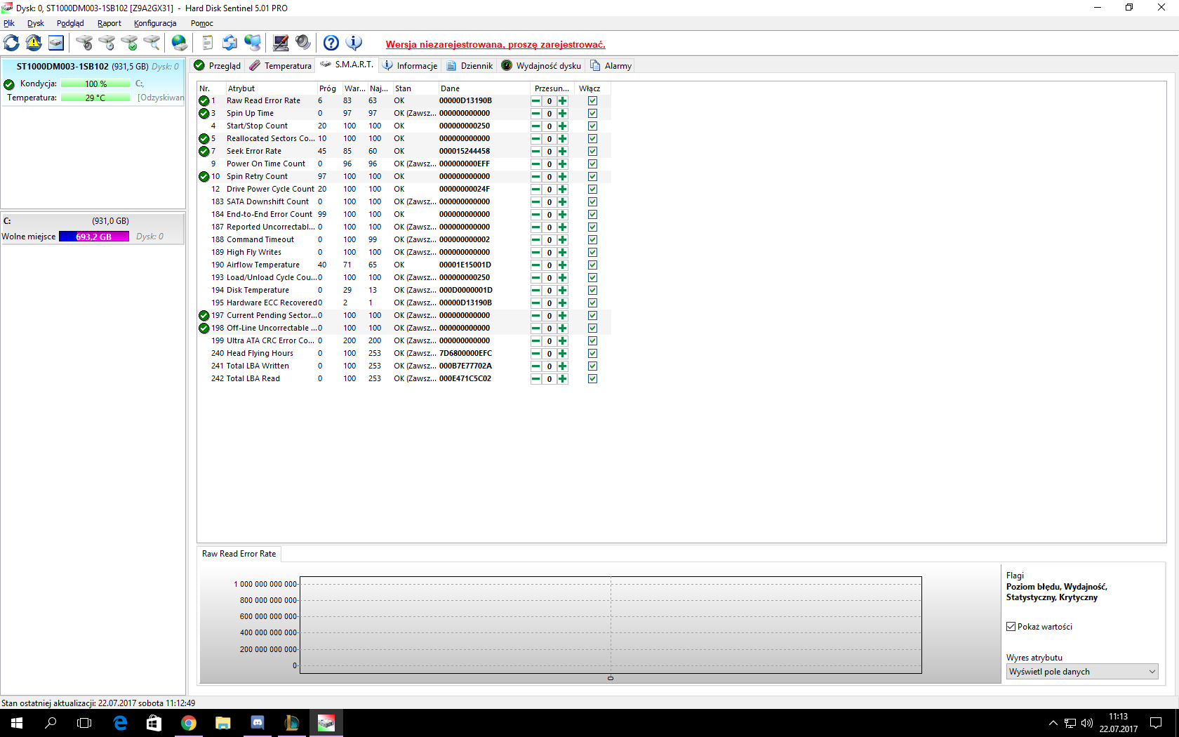

    I will present what my problem is. Well, sometimes my computer rebels and hangs - it does not react completely to anything, to commands, to a restart button, nothing at all. The only way out is to hold the power button (and thus the computer breaks down), what can it actually mean here?
    parameters:
    Processor - Intel (R) Core (TM) i5-6400 CPU @ 2.70GHz
    Motherboard - Asus H110M-K
    Graphics card - NVIDIA GeForce GTX 950
    Power supply (I think it's about the one under the desk) - PC-5ST, rated voltage - 230V, 50Hz, 10A. POWER CONTROL 5. (Date of manufacture 2002)
    RAM - 8GB

  • #9 16601959
    Jack Walker
    Posts: 8
    Rate: 8
    Robert B wrote:
    The format is not a cure.
    Show SMART disk:
    www.hdsentinel.com
    Memtest memory test (2 passes):
    www.memtest.org
    Condition of capacitors on the board:
    https://www.elektroda.pl/rtvforum/topic1221090.html
    SMART disk: (That's probably it, but I'm not sure)
    Intel Core i5-6400 & Asus H110M-K: Computer Freezes, Unresponsive to Commands
    Memtest: (That's probably it too)
    A kondestatorów can not find; /
  • #10 16601970
    Robert B
    Posts: 22594
    Help: 2027
    Rate: 1412
    Jack Walker wrote:
    And I can not find the conducers
    Swollen or no capacitors at all? One is at the PCI-E slot and the rest is not from those "swelling".
    Make another 20-minute Power Supply test in OCCT and insert all the graphs after finishing:
    www.ocbase.com
  • #11 16602499
    Lept_0n
    Posts: 13
    After the fact, everyone can write that.
    Not always damage to the computer can cause suspension, often it is the fault of the system / programs ...
    You did only 11% of the test, it's not enough, do 100%, if the memory turns out good and you do not have fused capacitors (although you probably do not even know what it is) (although now you are mounting polymer capacitors that do not swell) I would replace the power supply they are usually the cause of unexplained strange computer activities.
  • #12 16602596
    Robert B
    Posts: 22594
    Help: 2027
    Rate: 1412
    Before the fact also, because we have lovers of formatting, even damaged disks.
    Lept_0n wrote:
    You only made 11%
    11%, but already the second pass, however two courses are indicated.
