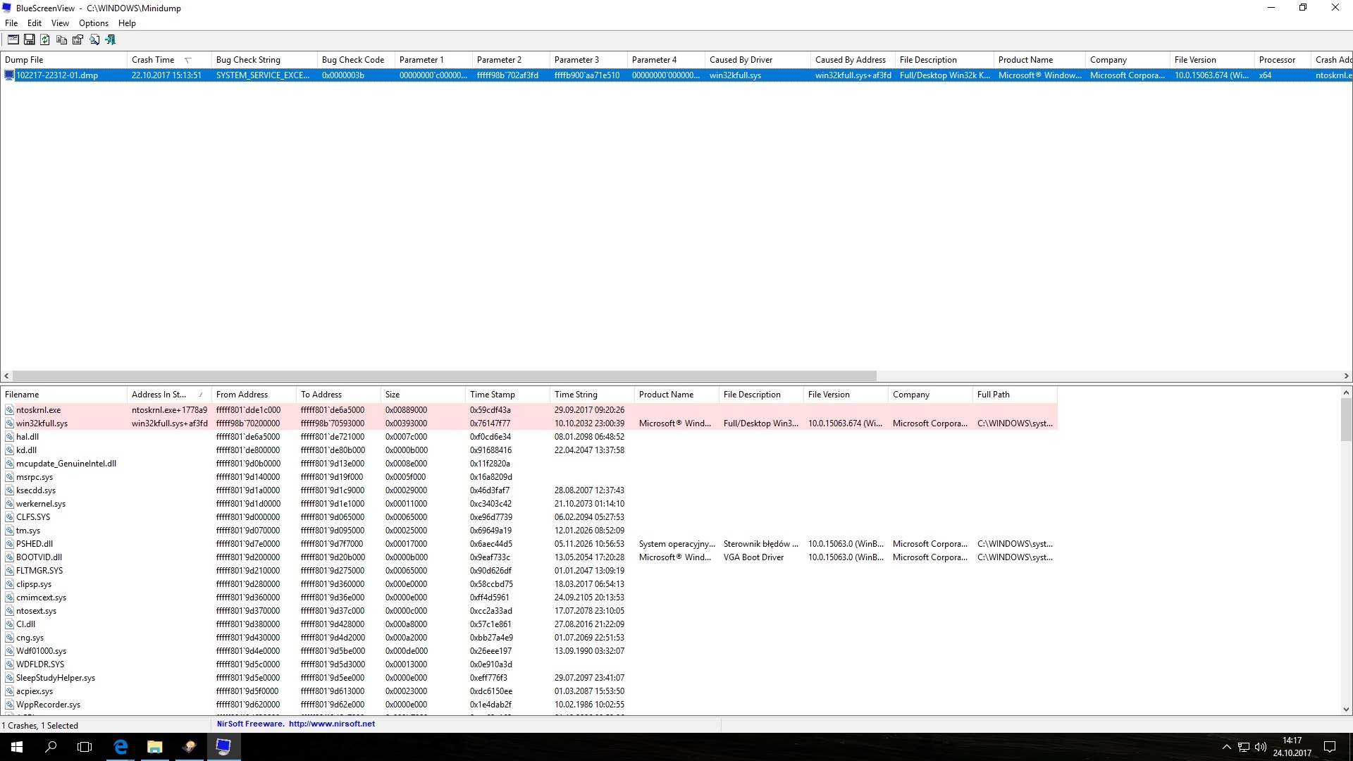

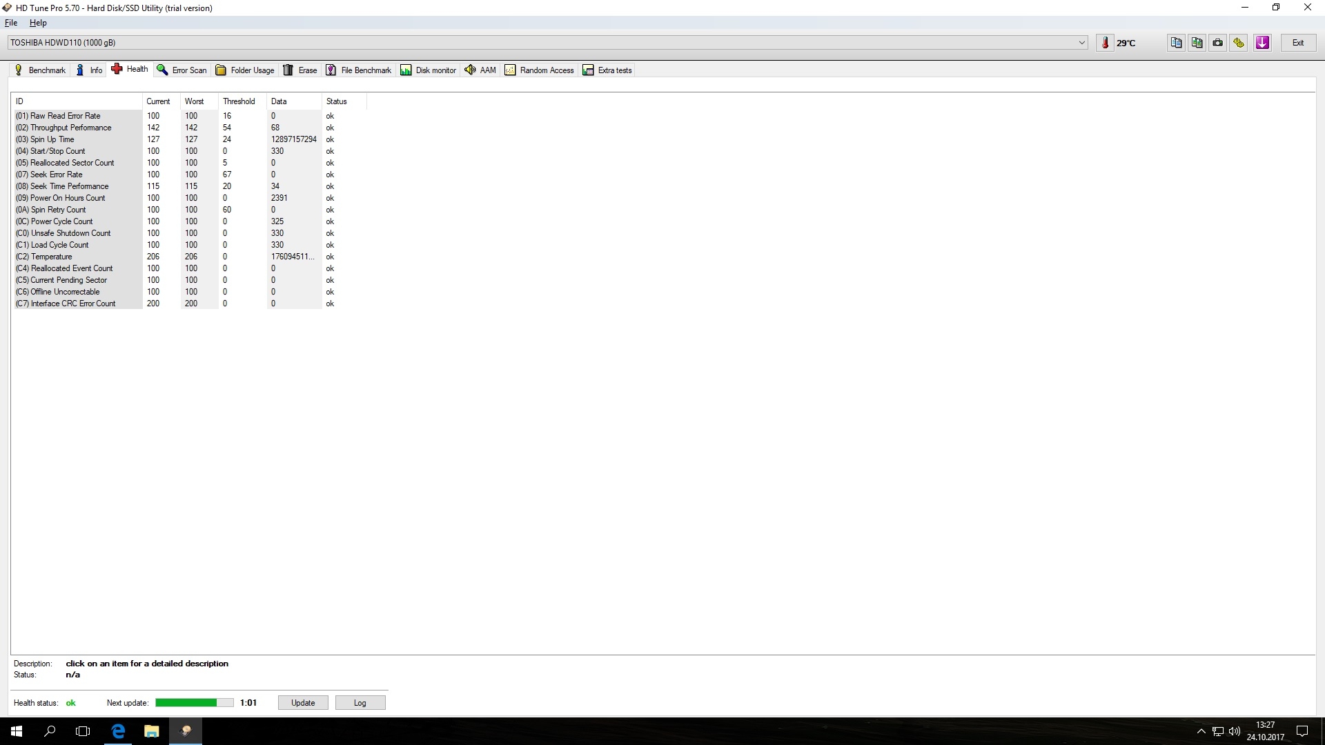

    Hello, My problem is caused by a constant crash to the desktop while playing with the message the program has stopped working due to a problem. Windows will close the program and notify you of the problem. The problem has been present for several months, in one game it crashes rarely, in another every hour and even for 10 minutes and in another not at all. I bought the computer in January and for about half a year everything was fine. From time to time there are also blue screens or unusual computer freezes (a red screen appears during the game without any information with stuttering sound). The specification of the comupter is:
    CPU: intel core i5-6400
    motherboard: AsRock H110M-HDV
    Socket: LGA 1151
    Chipset: Intel H110
    Audio: Realtek ALC-887
    graphics card: Gigabyte Rx 470 G1 Gaming
    RAM memory: 2x 4GB GoodRam 2133 MHZ CL15
    Hard Drive: Toshiba P300 1TB
    power supply: Thermaltake TR2 450W
    windows 10 64bit
    I did a reinstall of the system, won the latest drivers, etc. unfortunately it did not help. If setting up the system did not help, then problems with the system / software can be ruled out?
    I also checked the hard drive with HD tune pro, found no errors, bad sectors etc.
    I'm going to do a Ram Memtest tomorrow. If everything is fine with the frame, I have no ideas.
    Below I paste the hard disk test (disk is okay?) And the source of the dump problem.
    Persistent Game Crashes on Desktop PC: Intel Core i5-6400, AsRock H110M-HDV, Gigabyte Rx 470
    If you need any more information, write to us and thanks in advance for any help :)

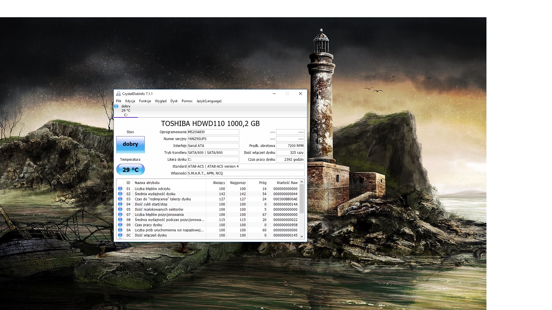

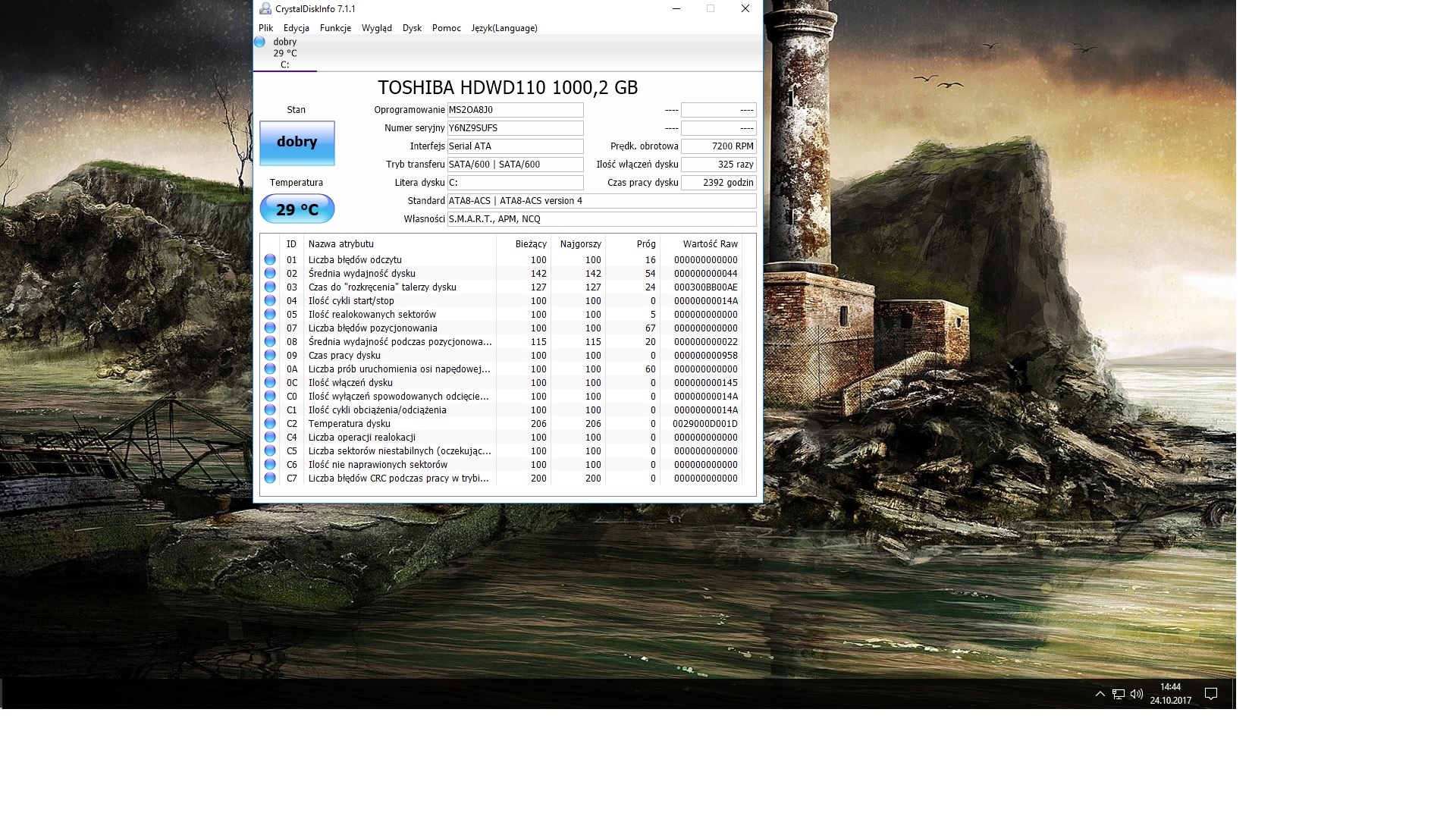

    Check the disk with Cristaldiskifnfo SMART.
  • #3 16776261
    Turunt26
    Posts: 11
    This is it?
    edit: I paste it again, because you can't see everything on that one :)
  • #4 16776318
    RADU23
    Posts: 20717
    Help: 2427
    Rate: 1728
    SMART does not communicate anything disturbing. The disk is ok.

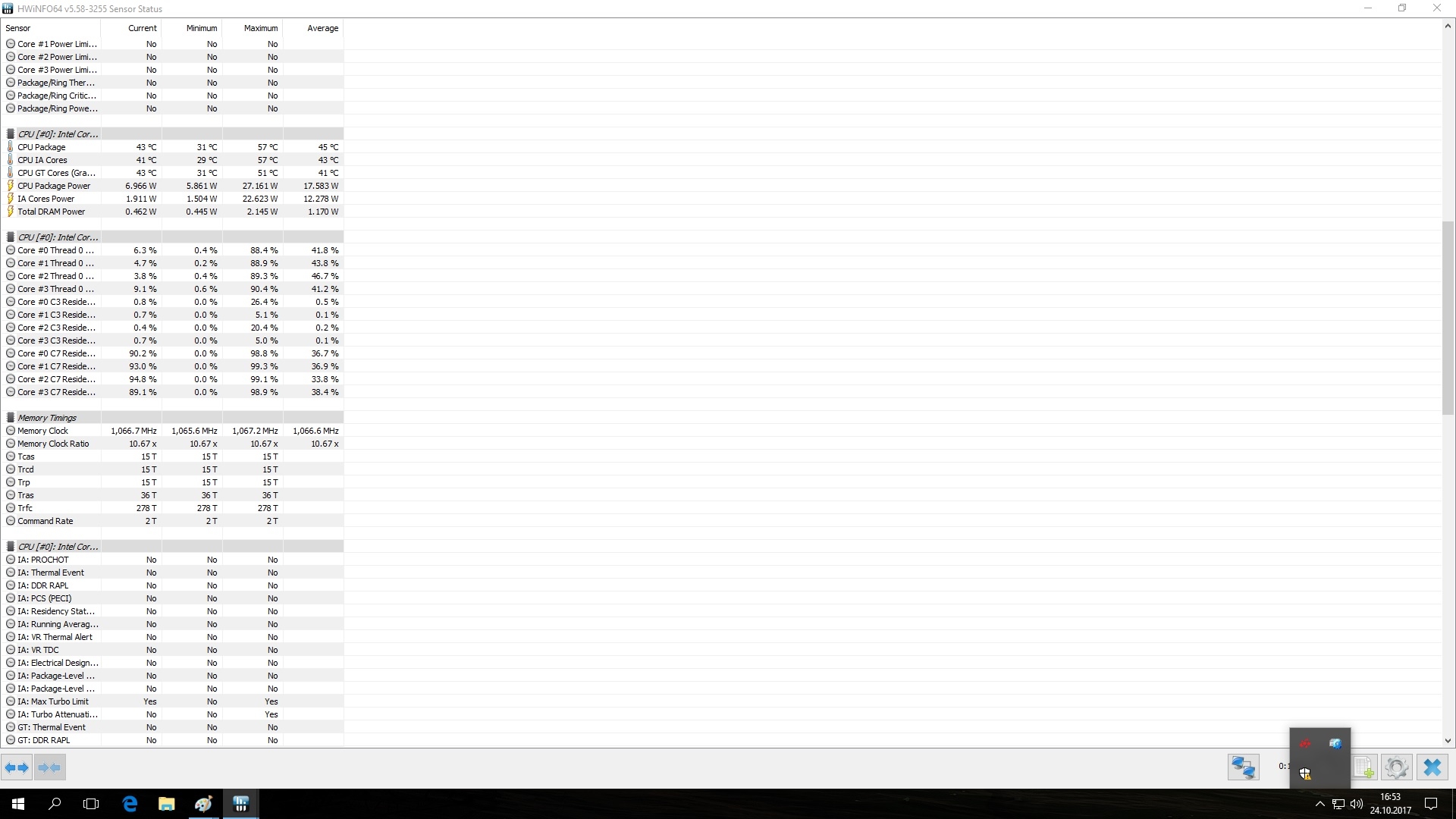

    Download and run HWiNFO =>
    www.hwinfo.com
    Leave it running in the background and play for 10 minutes. Then post the screen from the "sensors" tab.
    If the computer shows BSOD or reboots, you will be able to read logs from the program.

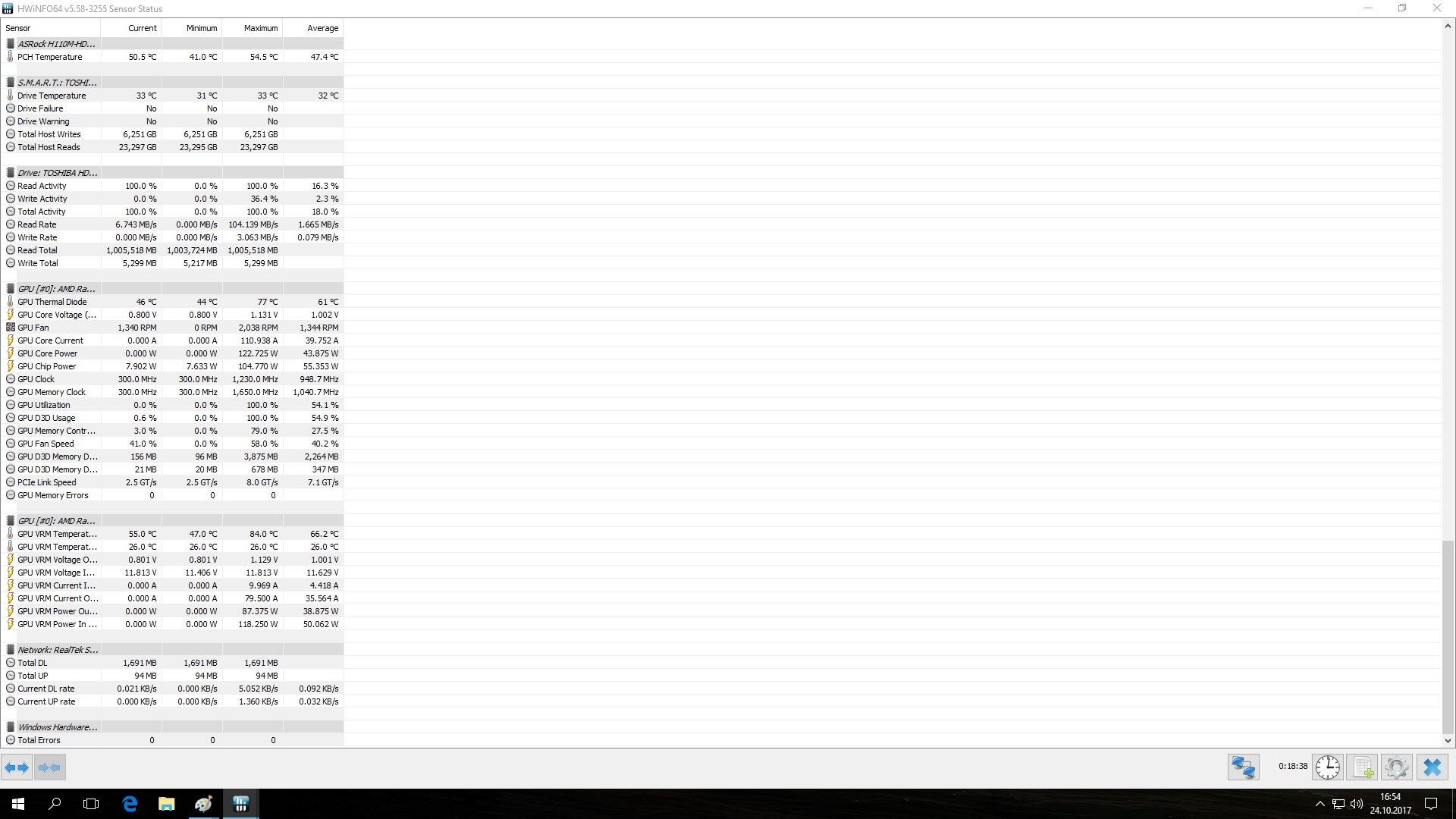

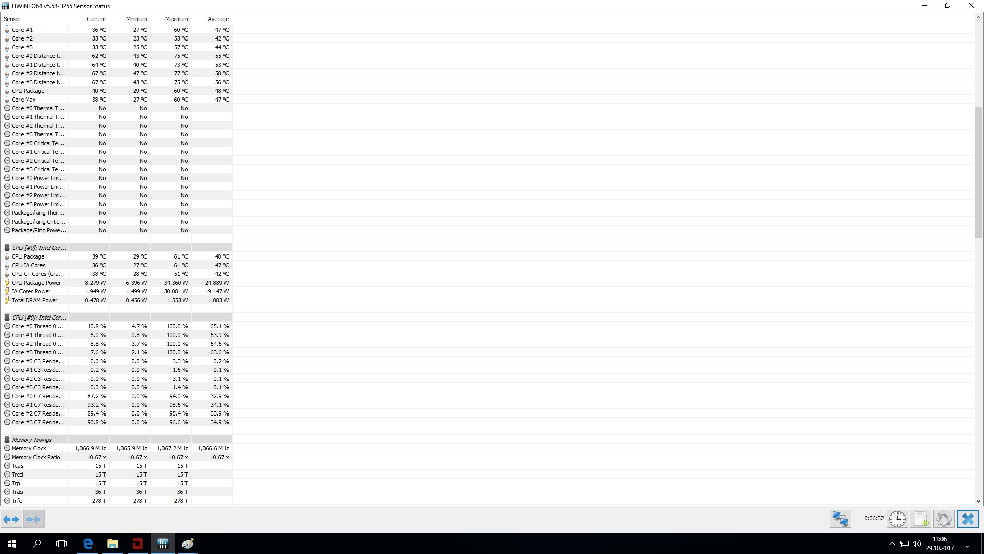

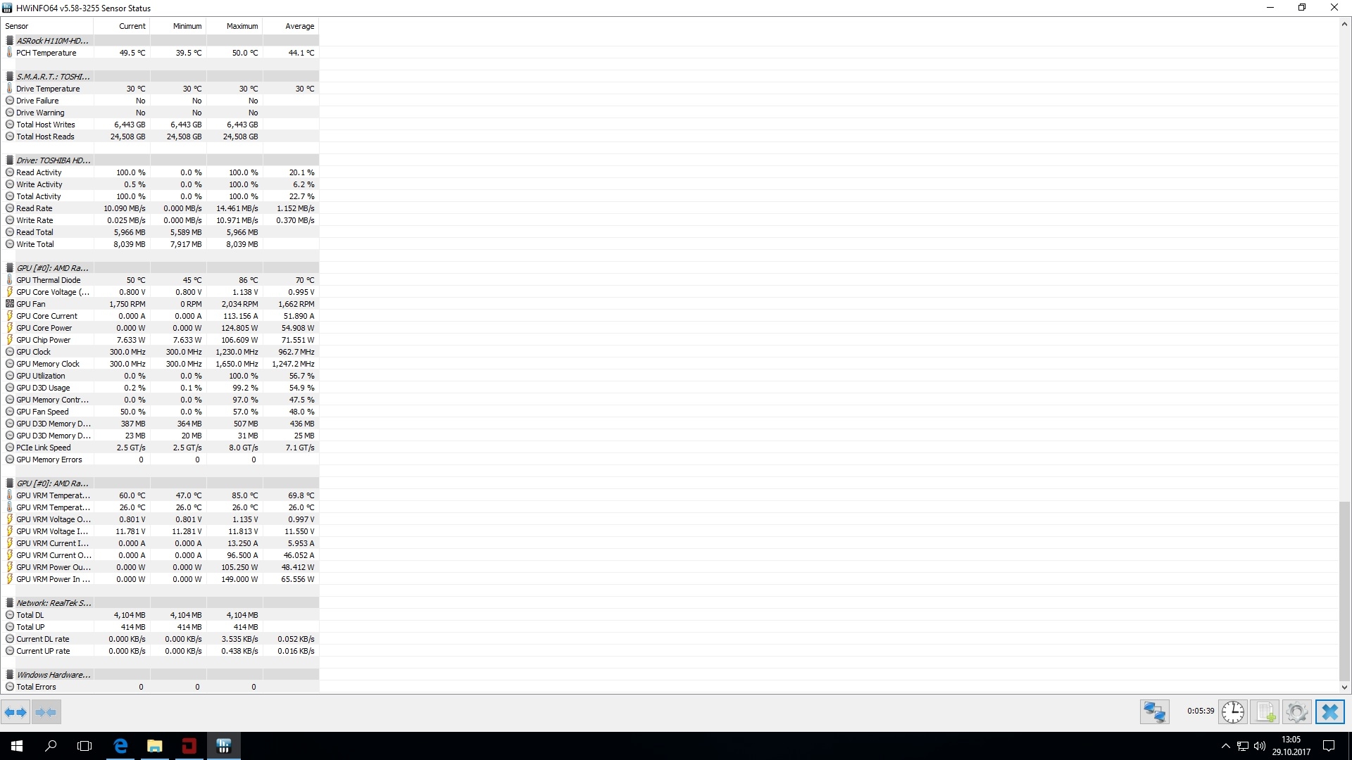

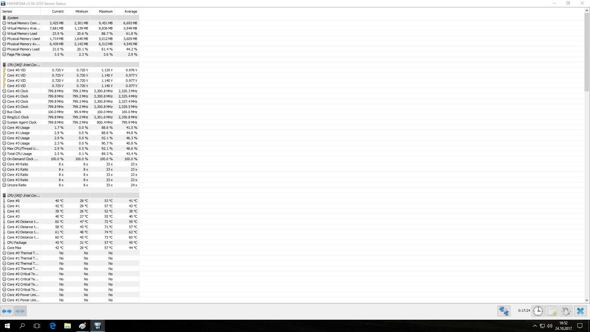

  • #5 16776437
    Turunt26
    Posts: 11

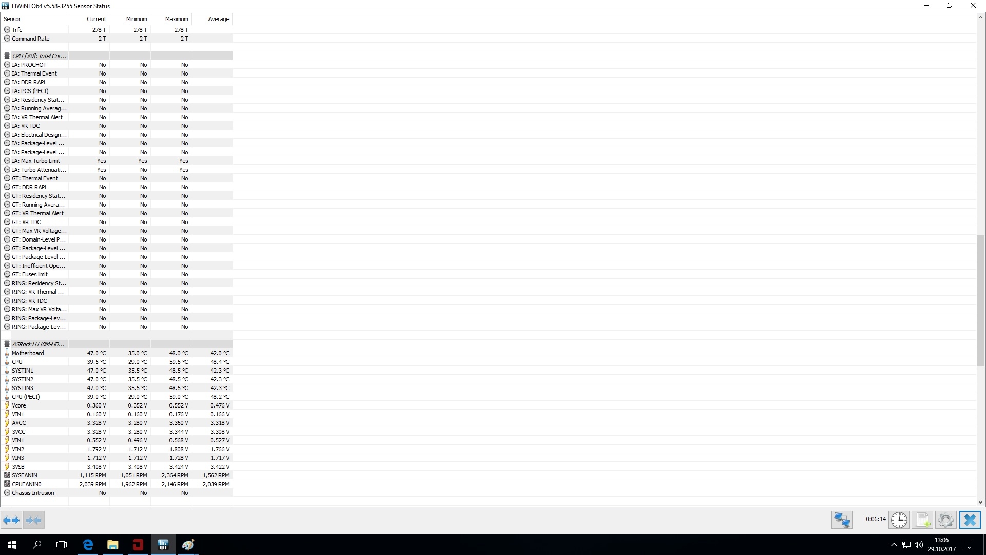

    Ok tomorrow I will post the results of the ram test. Still to be sure I will ask the memtest version is important? because you gave a link to the 2013 version, version v5.1 and on the internet I managed to find version 7.4.
    I include ss from the HWiNFO64 program:
    Persistent Game Crashes on Desktop PC: Intel Core i5-6400, AsRock H110M-HDV, Gigabyte Rx 470 Persistent Game Crashes on Desktop PC: Intel Core i5-6400, AsRock H110M-HDV, Gigabyte Rx 470 Persistent Game Crashes on Desktop PC: Intel Core i5-6400, AsRock H110M-HDV, Gigabyte Rx 470

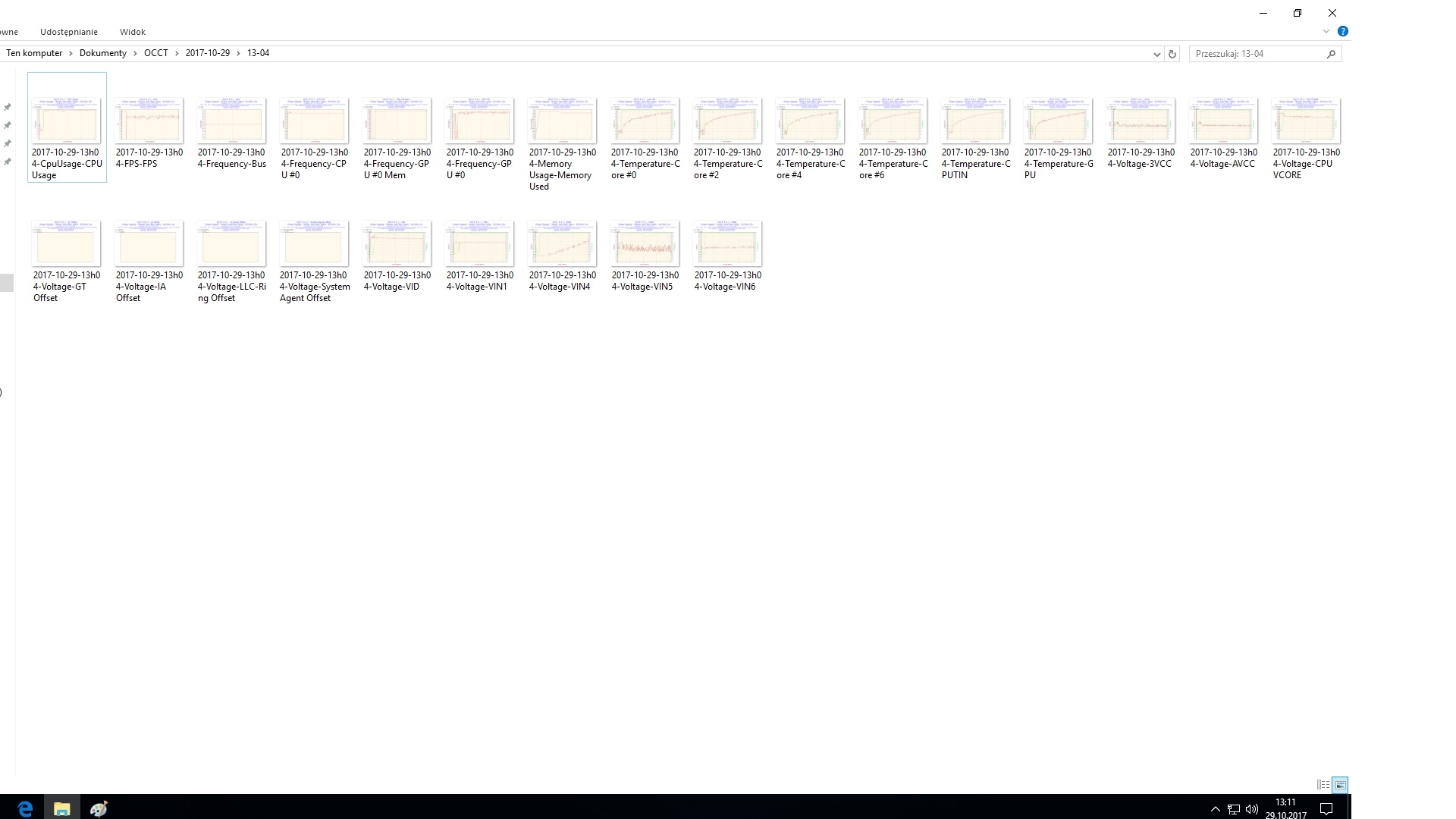

    Run HWiNFO in sensor only mode. Then run a 10-minute power supply test in the OCCT. After the test, give the screen from HWiNFO.

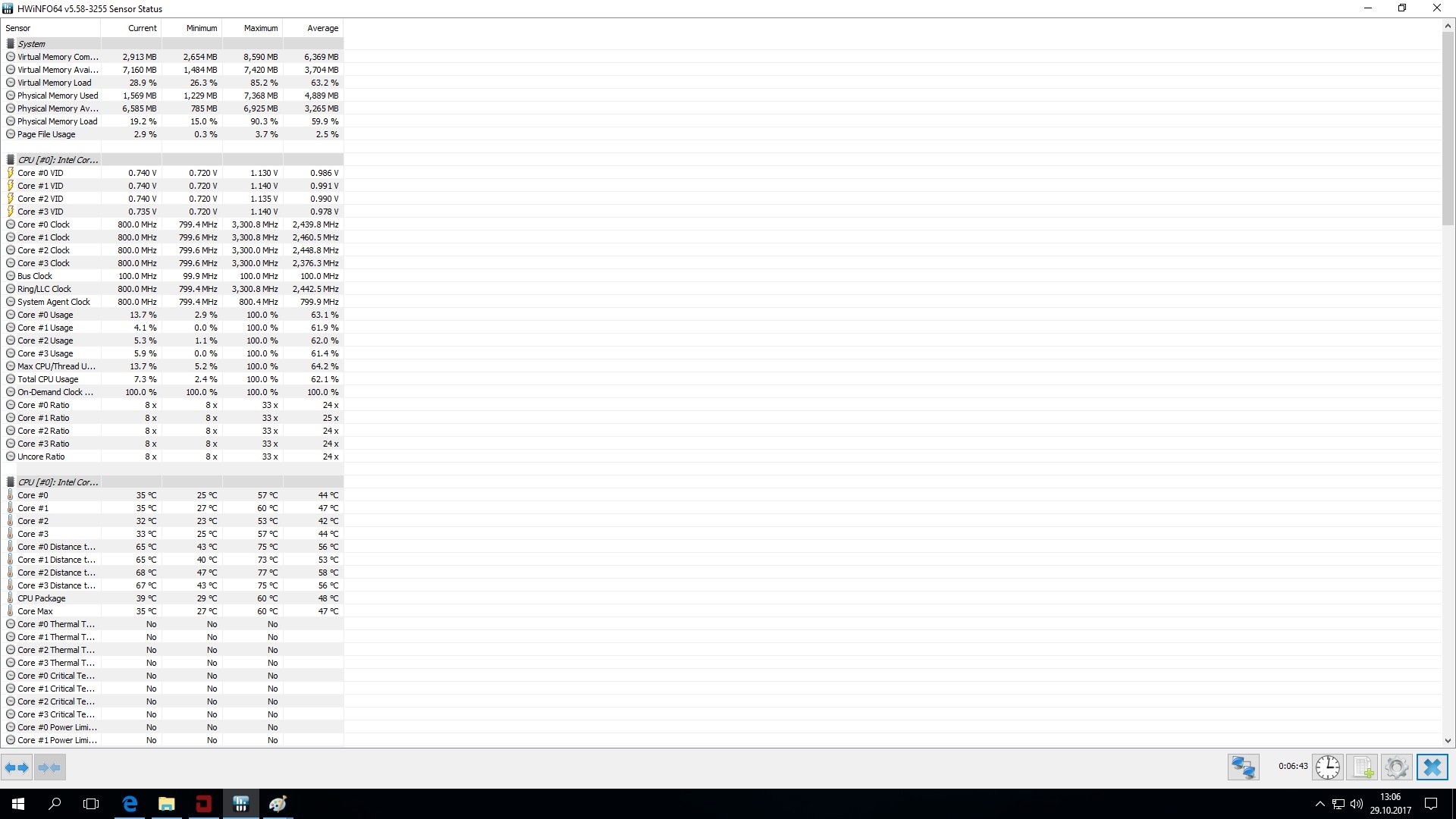

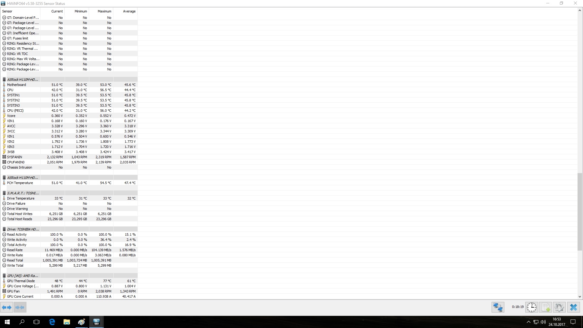

  • #10 16786828
    Turunt26
    Posts: 11

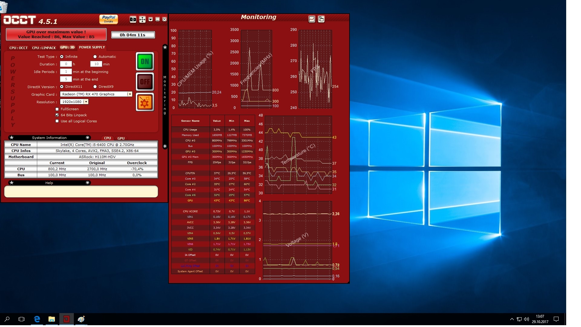

    So that's how I did the occt test. I turned on the power supply test for 10 minutes. After about 4 minutes, the program turned itself off. Something like this popped up: Persistent Game Crashes on Desktop PC: Intel Core i5-6400, AsRock H110M-HDV, Gigabyte Rx 470
    And at OCCT, something like this:
    And in the HWiNFO program in the sensor only mode, these results after 4 minutes:
    Persistent Game Crashes on Desktop PC: Intel Core i5-6400, AsRock H110M-HDV, Gigabyte Rx 470 Persistent Game Crashes on Desktop PC: Intel Core i5-6400, AsRock H110M-HDV, Gigabyte Rx 470 Persistent Game Crashes on Desktop PC: Intel Core i5-6400, AsRock H110M-HDV, Gigabyte Rx 470 Persistent Game Crashes on Desktop PC: Intel Core i5-6400, AsRock H110M-HDV, Gigabyte Rx 470
    Anyone know what this may be about? It turns out that something is wrong if it does not withstand the 10-minute test or I did something wrong :) I don't know, maybe I set something wrong in this program?
    edit I did the test again setting the time to 15 minutes (just in case, because before that I had idle periods set to 1 and 5 minutes and the total time to 10 minutes, so the program could close after 4 minutes), but the second time I set the time to 15 minutes, the program it should close after 9 minutes and it closed after 5 minutes, when gpu temperatures started to approach 86 degrees, so i still have no idea if it was supposed to be like this or something wrong with the power supply / graphics card. I am counting on someone who knows each other and will explain to me if this test shows anything.
  • #11 16788371
    310artur
    Posts: 9002
    Help: 980
    Rate: 670
    In the program, you set the thresholds at which the test is to be interrupted. He interrupts your test because the graphics reach 85 degrees.
    How are your graphics connected to the power supply? Any spells mary adapters? The power supply for the measurement with the meter, the plugs powering the card to be checked are the beginning. I would also check the cleanliness of the heat sink on the graphics or turn up the fan speed there because something strange that at 85 degrees is not yet accelerating.
    As for the OCCT test itself - the temperature limit on the graphics card can be raised to 95, but only for a moment - if you feel constantly hot, you have something wrong. In normal use, I'd rather keep it below 80 degrees or at least try ;)

    I checked carefully and the message the program stopped working ... appears when the temperatures do not exceed even 70 degrees, so this is not the source of the problem. I have graphics connected to the power supply. And the fans in the watman are automatically set to the maximum speed of 2020, but this won't solve the problem because the temperatures are good during the game.
