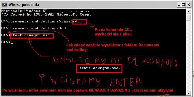

    faza12f wrote:
    Try to start your computer in safe mode and remove unnecessary devices.
    Tell your friend how to do it if the computer does not start ?.
