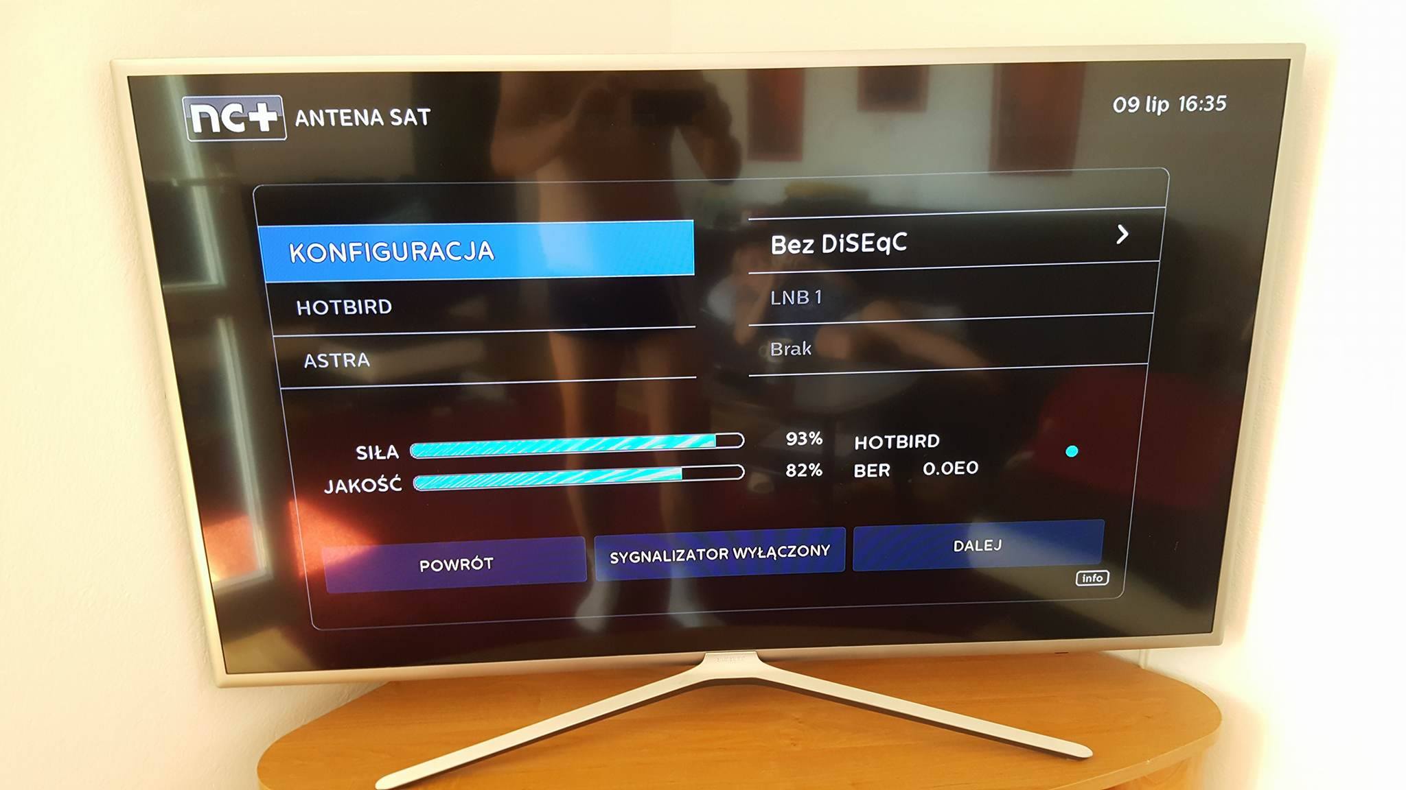

    Hello. I bought NC + TV with 80cm dish :) I set up the antenna for the first time alone and I was able to set the quality to 100% :) I was very happy because I was doing it for the first time, I turned the antenna and turned off the TV in anticipation of activation.
    I turn on the tv in an hour and the quality is already 70%
    (antenna well bolted) since then, the television receives well,
    but when it rains it loses its signal. Do I have to set it up again? NC+ TV Reception Issues: Signal Loss during Rain with 80cm Dish - Antenna Setup & Adjustment
    Added after 19 [minutes]:
    e.g. now I have as much as on the photo, but during yesterday downpour it dropped to 40%: / NC+ TV Reception Issues: Signal Loss during Rain with 80cm Dish - Antenna Setup & Adjustment

    Check the attachment of the plugs, set again. In the antenna's field of view, are there any trees, buildings, etc. stuff?

    Sometimes, after turning, a slight movement changes the quality. Can be shifted slightly.

    It seems that is right. Remember to set the converter.
    The converter also requires adjustment of the so-called twist

    What decoder is it? Generally, with the 80cm antenna you should take into account the disappearances. The weather is getting more and more extreme. For me, the 115cm canopy also unfortunately disappears more and more often.

    This 82% is a very decent result. 100% is probably a decoder error. He probably still had old software. You have to come to terms with the rainfall at the downpours.

    With a "normal" rain, on a well-set 80's, there should be no signal losses, but quality loss as much as possible. Anyway, there doesn't have to be rain to degrade quality - just a simple cloud. The thicker its layer - the greater the quality decrease.
    Showbiz32 wrote:
    yesterday there was a severe downpour and the program disappeared more than once
    This is a normal symptom. On my 105 I also sometimes have momentary decays. See what antennas it has nc + uplink station , and even on them with large downpours may be signal loss. Sometimes, on some channels, you may experience a complete loss of signal in nice weather, when a storm is raging over the transceiver.
