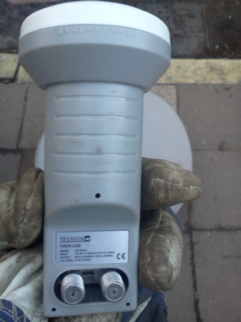

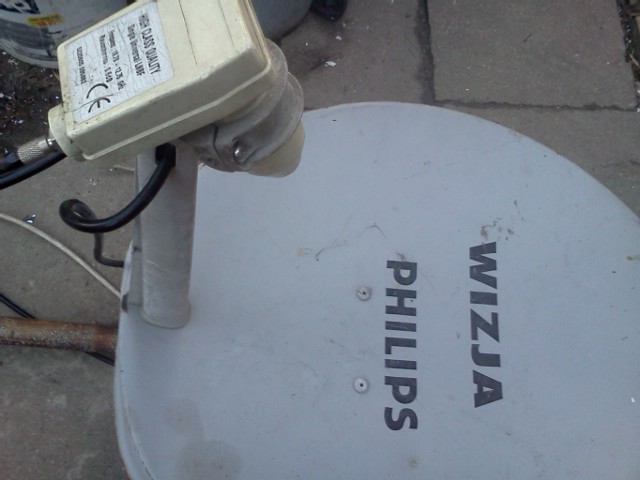

    Hello, I bought today a pre-paid decoder in nc + link:
    http://www.mediaexpert.pl/tune...-5800sxrec-z-dyskiem,id-268531
    And in the previous post I asked if you can replace the satellite dish with a regular one. One user replied "Antenna with converter needed, twin converter indicated." so i bought a twin converter. I set the antenna: elevation angle: 31 azimuth: 193 deflection angle half: 8 I'm not sure if the converter deflection angle is set correctly (I'm from Zamość). I look and there is only 35% of signal strength and 0% quality, in each direction it is 0% quality (on the twin converter it is like the gray one in the picture). The platter was originally on a Single converter and this converter has 70% power and 0% quality. Did I pick something wrong?

    Help: 170
    Rate: 324
    Badly positioned antenna. Please do not worry when setting the tuner meter. It's best to use an external meter. Regards artur

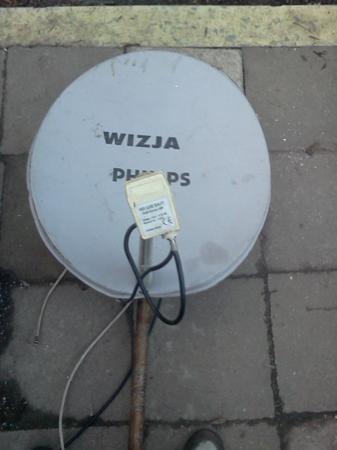

    The antenna is too small, even if you manage to align it, in worse weather conditions there will be a problem with reception.
    Invest in a new one, at least 80 cm, and someone who will position it carefully.

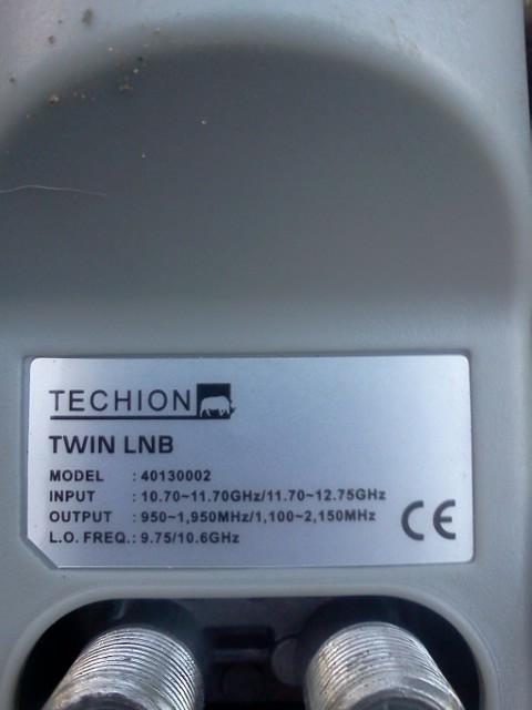

    I have a twin converter and one cable had 65% of the antenna power and the other 55% of the power. But I set the antenna on one cable, because I checked how the decoder would behave on two cables (at home).
    Added after 4 [minutes]:
    I have a twin converter because one of the forum users recommended me a twin converter because channels that are in hd will work better or something.

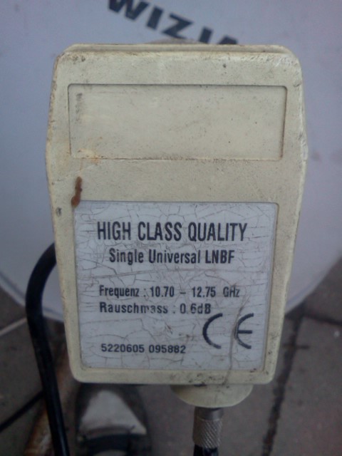

    Antenna Signal Quality Issues with NC+ Decoder, Twin Converter & Sat Dish Alignment
    But this plate is completely crooked. You can see the deformation from the bottom (after a fall?) And from the side.
    nowy.zielony.pczątku wrote:
    Aaa, I had to add that the signal strength is the same when the converter is placed in front of the platter and removed. Does that mean something?
    This, among others, may be the effect that the converter does not "look" at the focus of the antenna.
