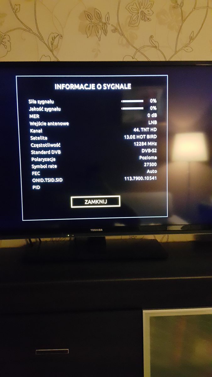

    Hello, I have a similar problem as the author of this thread, except that there is no channel for me and it only happens when it rains harder. It looks like a cable has got wet, but the cable insulation is not helping, the connections seem ok and the signal strength at the time of this message is 0%. The question is what is going on here? Wrong LNB in the antenna? The decoder has been replaced with a new one, and the converter also has the problem.

    What is the signal quality and strength while the reception is okay?

    More or less like this Cyfrowy Polsat Channels Lost During Rain: Wet Cable, LNB, or Decoder Issue?
    Depending on the channel that is turned on, it varies around 1-2% in minus or plus.

    Weak signal. Small or misaligned antenna.

    Cyfrowy Polsat Channels Lost During Rain: Wet Cable, LNB, or Decoder Issue? .
    This is a picture of the signal strength from 10 minutes ago during the rain. Currently the rain is the same and the signal strength is 0 and what is the point? :/

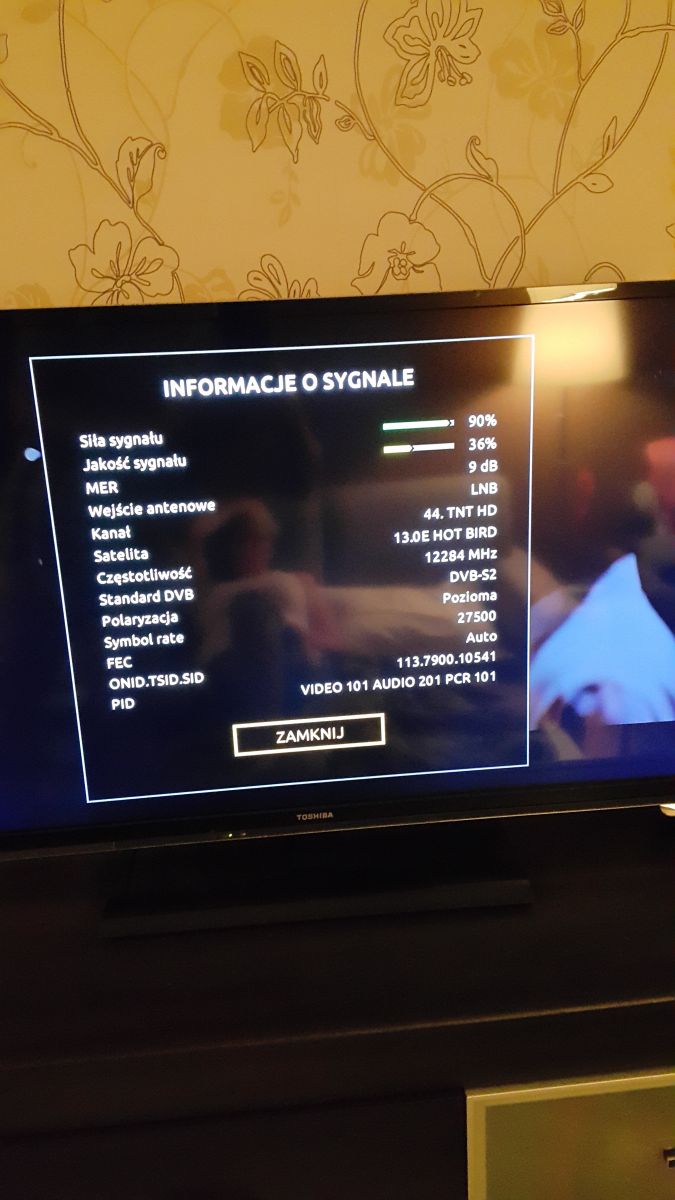

    Added after 4 [minutes]:
    e1afbb41e .
    This is a picture of the signal from a minute ago.

    9 dB is the tripping threshold of the decoder. Just a drop more and the signal is gone. Imagine that just now at my place on a 115 cm antenna there was no reception at all. :D .
