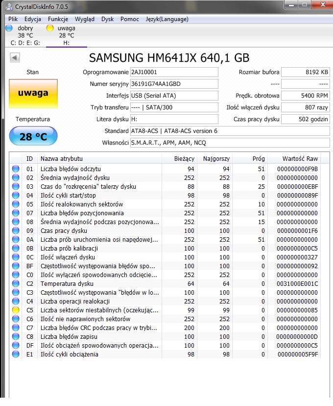

    Some time ago I was configuring my drive to work as a network drive (plugged into the netgear WNDR3700v4 router in the ReadySHARE service)
    everything worked, I unplugged the drive from the router and went to the shelf.
    It was some time ago ... now after connecting it to the laptop it is not detected, I can see it in the computer management panel but instead of NTFS it has RAW
    How can I "fix" it without losing data ...

    I used to have a similar problem, the reason was badsectory.

    Post the screen from CrystalDiskInfo.

    here is the prtsc from CrystalDidkInfo

    You can remap yourself according to the procedure =>
    https://www.elektroda.pl/rtvforum/topic1550200.html
    Remap does not delete data as it does resetting.
    The disc is generally not good.
    There are a lot of falls / bumps / shocks (BF) recorded.
    For this (01) (0B) (C8).
    I bet the disk has mechanical problems.
    After the remap is done, upload the surface scan with the MHDD sector access times (you need to take a photo and post it here).
