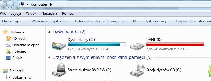

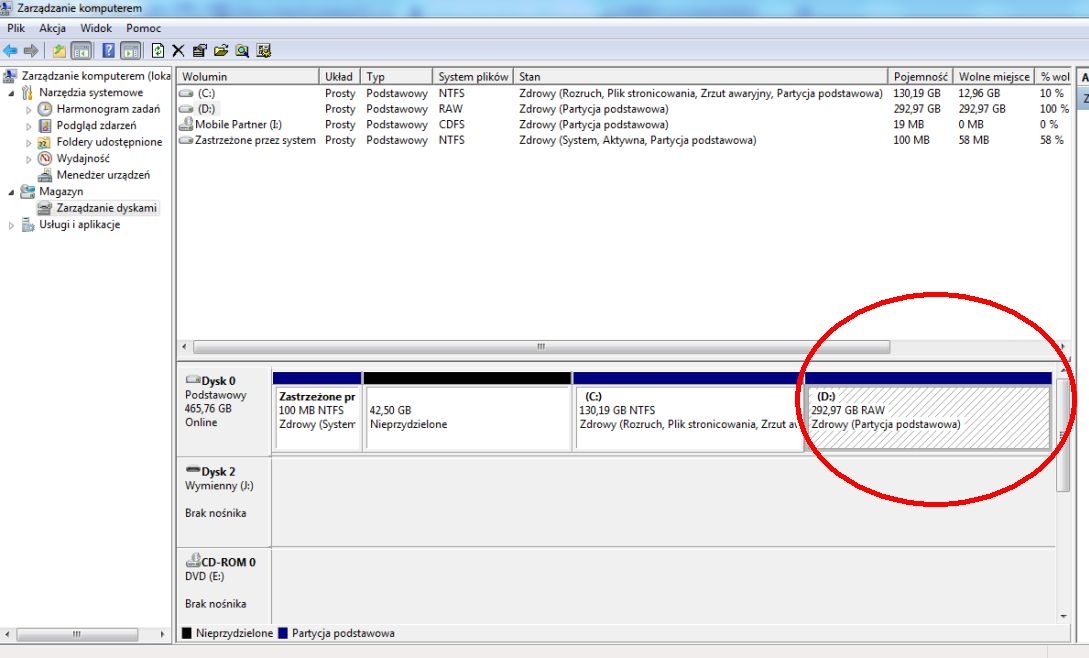

    The D partition has become a RAW system, so I can't open it because a message pops up to format it. I have a lot of data on it.
    How to restore NTFS without losing data on partition D? I don't remember exactly how it happened, I know that I wanted to check something in the partition copy program and I pointed this partition D and since then it has changed to RAW and I can't open it. I know that you can recover data from it and then format it, copy the data again but it requires space and a lot of time.

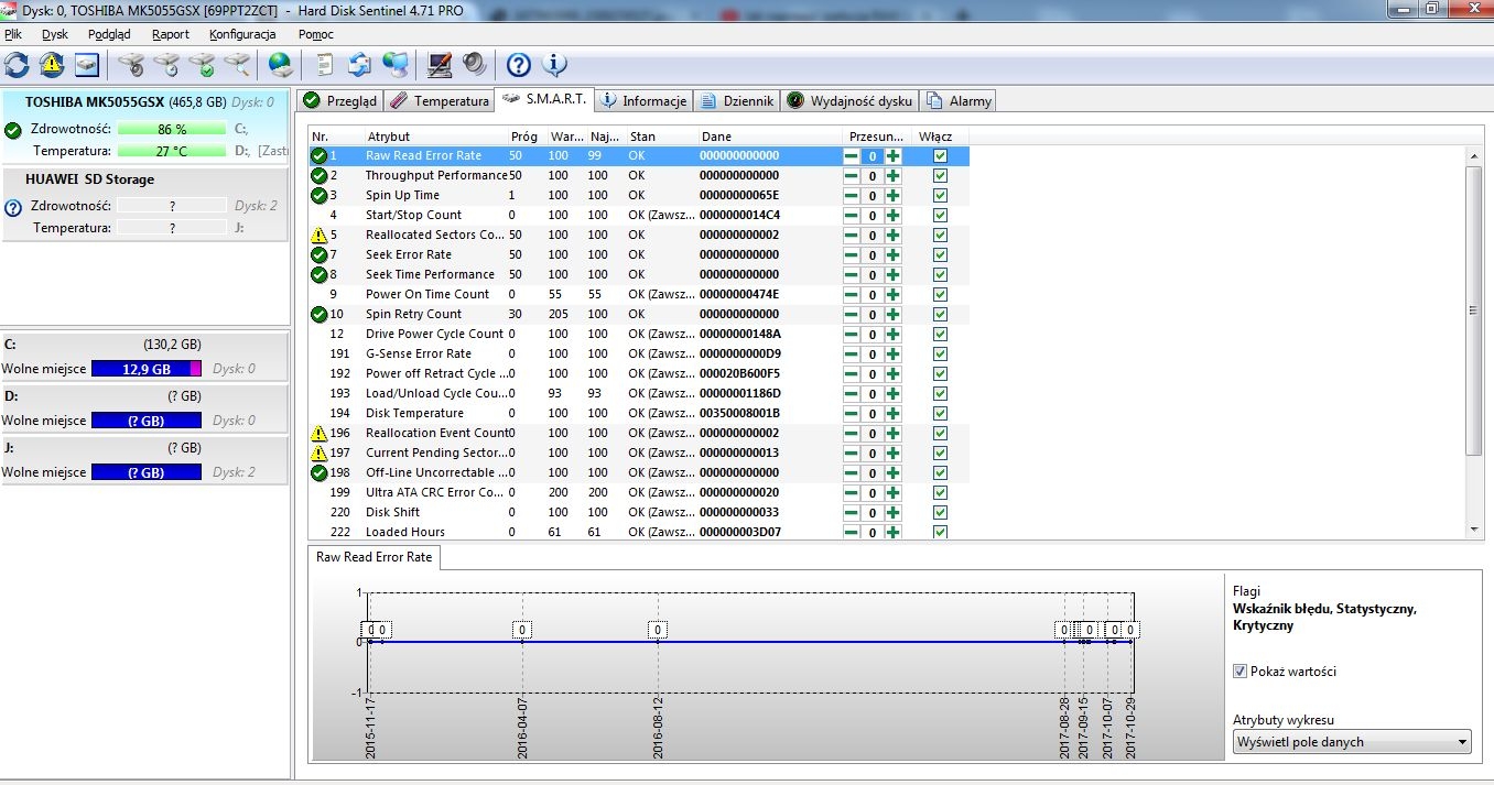

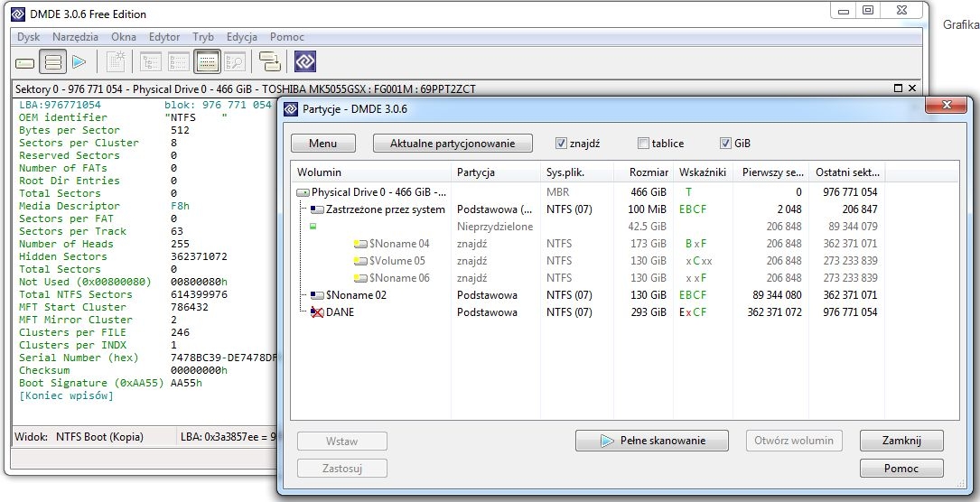

    Show the partition layout from DMDE.
    Show SMART disk.

    xuebi wrote:
    SMART
    As you can see the disk is falling apart (05, 196, 197)
    217 unacceptable blows during work could have contributed to this (191) .
    First of all, a post-sector copy and recovery of files from the copy:
    https://www.elektroda.pl/rtvforum/topic1330304.html

    To be honest, the disk is damaged and it's better not to do anything with it at the moment.
    If you need this data, first get a working, no smaller disk and make a post-sectoral copy.

    Partition checking is the worst thing you can do in this situation. No boot sector and therefore RAW. In DMDE, after clicking on the DATA partition from the menu select -> Restoring the boot sector from the boot copy and confirm. Then, if necessary, apply, save the rollback file and restart.
    ATTENTION This operation should be performed on a copy of the original only after purchasing a new disk and making a post-sectoral copy directly on it. The original disk is damaged and is not suitable for system or important data. Buying a new disk will unfortunately not miss you. By performing these operations on this disk and using it further you expose yourself to data loss. Furthermore, it is better not to use this computer until the disk has been replaced and the data has been secured.
    It went without a problem. Thanks a lot.
