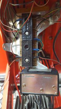

    Hello, I know that the topic has been raised many times, however, in none of the threads, although they addressed my problem I did not find a solution.
    Well, I have a Simson SR50 I mentioned "Magneto" and what is under it, that is the whole system of coils and the pulse generator or the magneto I do not know how it is determined. and after this exchange I do not have a spark, help me how to connect these 5 cables, the diagrams are black magic for me, the installation is unstretched regarding the cable.
    I have decoded the symbols on the switchboard as colors, but the diagrams, e.g. "bolt" are drawn in series and I have 4 cross-shaped holes,
    can anyone help me i'm far from home with my sim because NL, I can't fix it for a long time ..... save. I add photos to the post, with the diagrams, for example, the colors of the cables do not rip me. It is important for me to have a spark ...

    5 wires come out of the magnet: blue connects to the ignition module terminal 3, red connects to module terminal 14; terminal 31 of the module with a brown wire to the scooter ground, terminal 15 of the module with contact 15 of the ignition coil, and the other coil terminal to ground. Pin 2 of the module with a brown and white wire to the ignition switch. You already have a spark and putting out the engine. Now red and white with a magnet with the same ignition. You already have a headlight. Red-yellow and red-gray for a bridge rectifier under terminals marked "~"; "-" ground bridge, "+" to terminal 59 of the controller. Terminal 31 of the regulator for ground, 49a with a gray-black wire to the indicator lamp switch, and 49 with a black wire to terminal 15 of the ignition switch. While the ignition 30 terminal (red-green wire) is connected to the battery, you already have charging. You probably can handle the lights. If you don't write it.

    The coil is always 6V, regardless of the voltage of the rest of the installation. I wrote you what and how to connect so what's the problem? I hope you know that these 2 connectors have different contact layouts? Some are joined in pairs and some in fours.

    hey i took off these black cubes under them the description of this distribution is as in the picture, Simson SR50 Magneto & Coils System Installation: Connecting 5 Cables for Spark Restoration
    I will take more photos because I can see that people have an idea here, I didn't even know that there were so many versions of Simons, for me there were 3 :P enduro, ordinary and scooter :)

    Then you have the set. Color coding of the wires in the diagram. ro Rot or red; ge is GELB or yellow, b is Blau or blue, sw is Schwarz or black, gn is grun or green, br is brown (i.e. mass, minus the Germans
