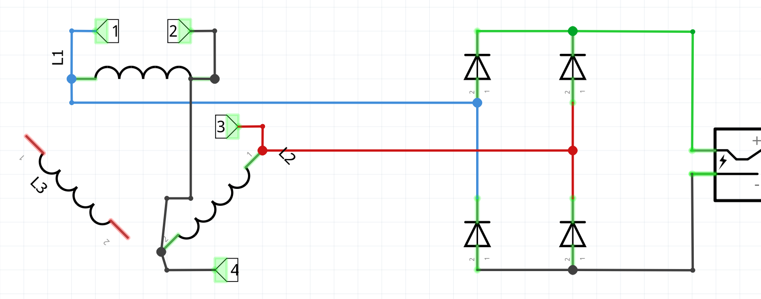

    I have a little dim light in the front so I decided to use the coil from the rear lamp for this. and I connected it like this:
    Connecting Coils in Simson Magnetic Wheel for Simson S50: Optimizing LED Lights & 6V Installation

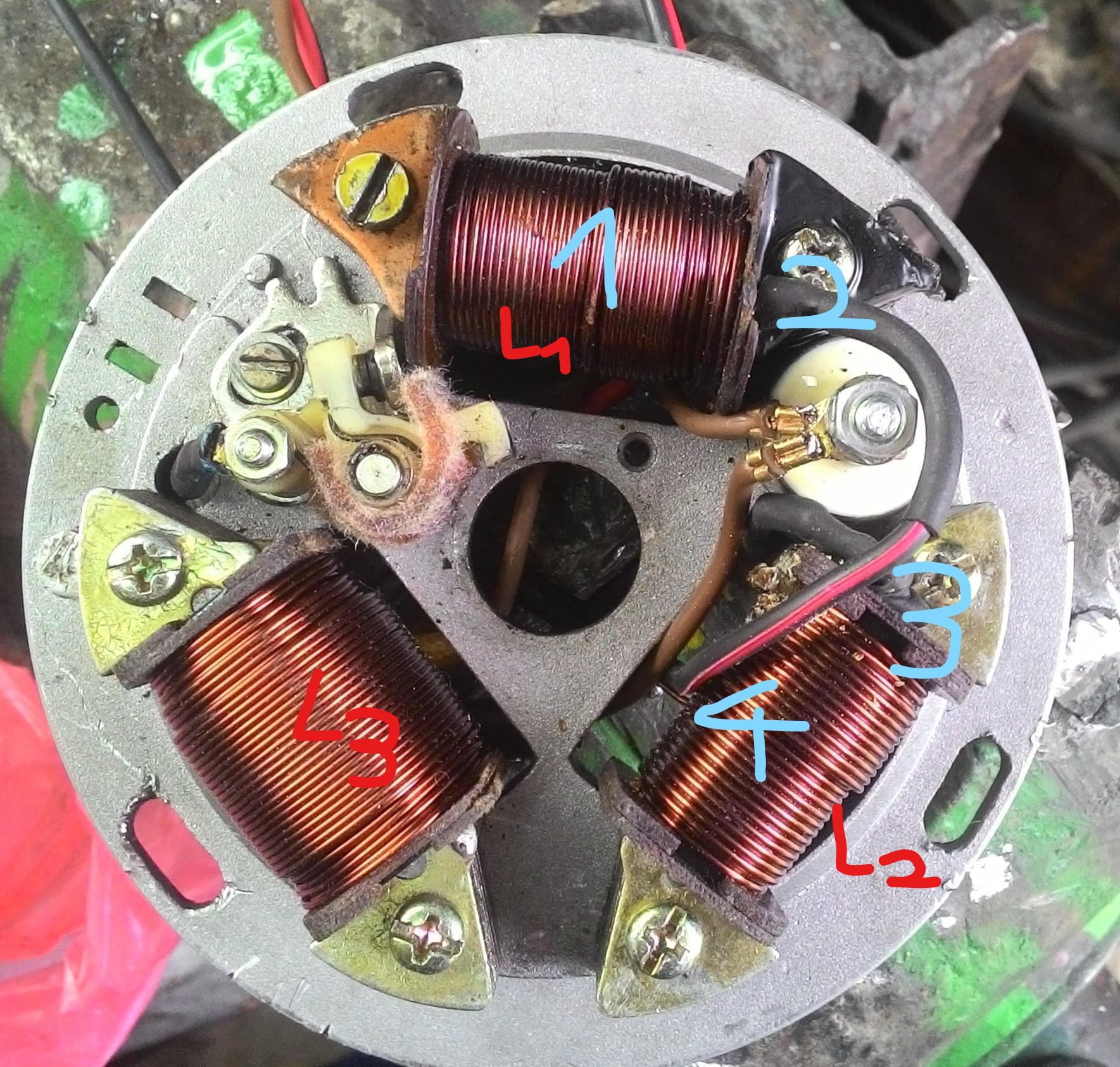

    I massaged both coils, and they are both charging only one (on the coil tappets) shows 6V and the other 3V (Resistances have the same)
    But:
    L1 1 tap is outside, L2 3 tap is inside
    L1 2 tap is inside, L2 4 tap is outside
    After connecting the coils in this way as in the diagram above, I have 20V DC at low speed, after connecting the strain relief (6V 21W bulb) Not lit, the voltage drops to zero.
    I have a question: Do the taps on the beginning (or ends) of the L1 and L2 coils have to be either outside or inside?
    Should this be the connection of coils in a system based on a 3 phase 6 diode rectifier?
    // The direction of the magnet wheel is clockwise

    Try to change the beginning and end of one coil, i.e. connect one coil upside down and measure the alternating voltage.

    You must have the matching of the winding ends and the windings, the reverse connections will generate zero voltage.
    It makes little sense to make this change.
    In the platinum chain you put on two 12V light coils, connect the ends with each other and you have an alternator that will supposedly pull even H4. By using a lower headlight bulb, a voltage regulator from the scooter, charging from the regulator, as a result, you have a trouble-free installation.
