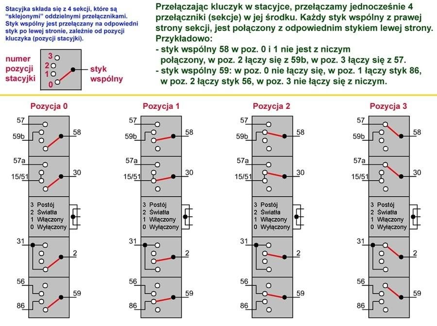

    Hello, I have a Simson S51 on 6V platinum, I have connected a new installation, but there are no lights, please help, thanks in advance. Below is the diagram from which I connected.
    Simson S51 6V Wiring Diagram—No Lights After New Installation, What to Check?

    Start the engine, pin no.59 on the ignition switch and check if there is voltage with a bulb. How is it, turn the ignition switch to the "light" position and check with the bulb on pin56 if there is voltage.

    The voltage is at 59, and not at 56, I will add that I bought a new ignition.
    Or maybe this pattern is wrong. Unless there must be a battery for the lights that I do not have yet.

    No, how does it not power these lights. Only parking, if I'm not mistaken. So make a bridge from 59 to 56 for now and check if it lights up. Then look for another pin at the ignition that gives power from pin 59. Maybe on another pin this voltage appears after turning, if I'm not mistaken, it is twice.

    I made a bridge and the lights are on but all the time. Other pins also do not work, what should I do to make the lights in the second position?

    It has to work. After turning the ignition switch to the second position, there is to be a contact. I don't know why it's not there. I analyzed several diagrams.

    this is the ignition switch jek is in the 2nd picture

    Either these ignition switches are faulty and return them, or you connect something wrong. I suppose this ignition switch is a Chinese product. Because DDR costs about PLN 54. There is to be a transition in position 2 of the key from 59 to 56. If you have a friend who has such a simson, check with him. But I am 100% sure that it should be like that. Give them back and buy the original. Because it is not possible.
