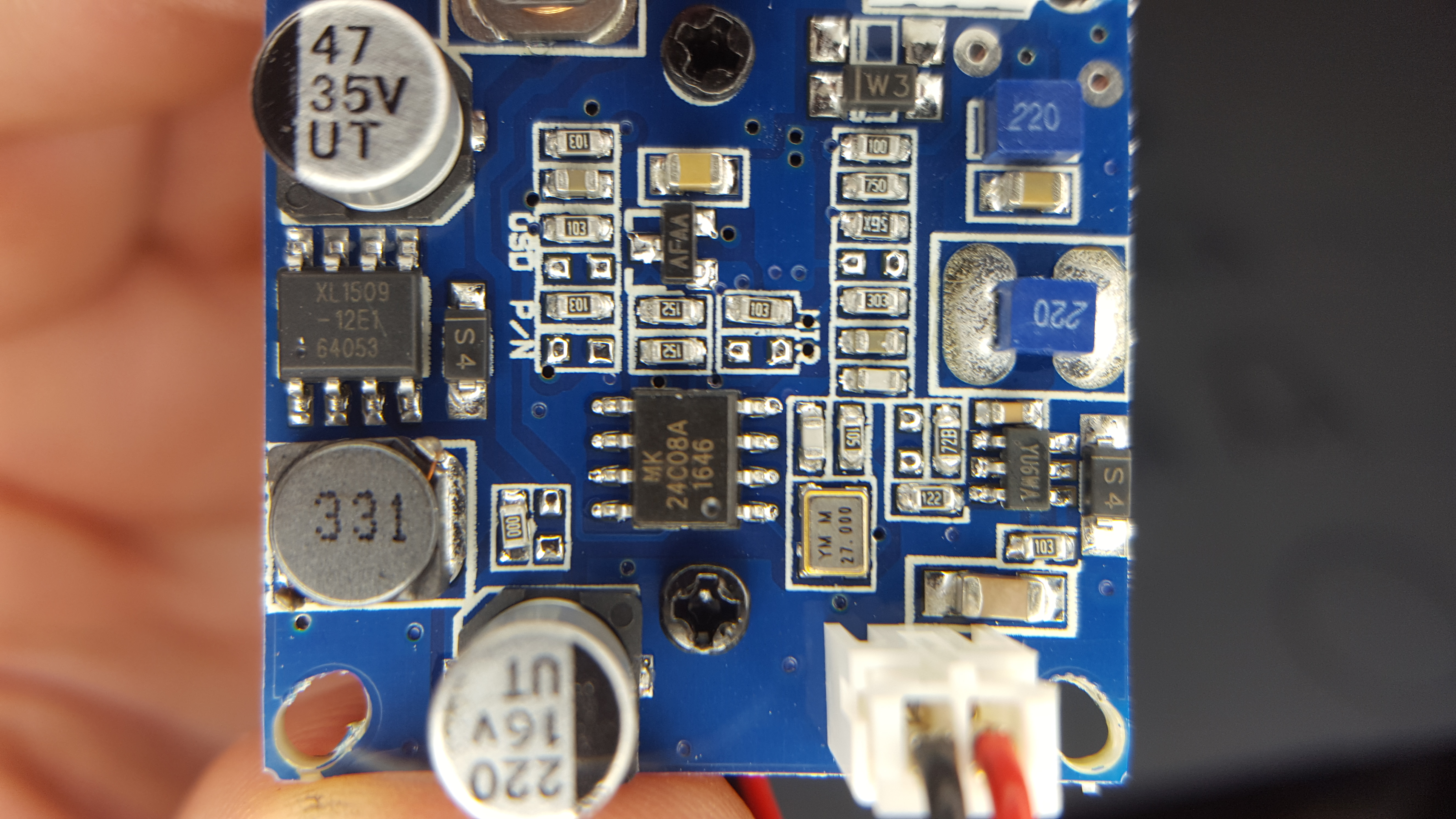

    As in the topic, I was looking for and found one similar topic but on a completely different IC.
    I want to use the webcam in agricultural equipment, and no guide lines are needed there.
    Below photo:

    It is written in the software. There may be a problem with the change. If you want without guide lines, buy a normal webcam. There are many available on the market, for example cars.
  • Auxiliary lines likely controlled in camera firmware

    Podpucha728i
    The thing is that I have two such webcams completely new from Aliexpress and there is no question of returns, the price of such cameras is 3x higher with us. I hope that someone will recognize the chip, because in a similar topic it was enough to cut off the power on one leg and the webcam started without a line.

    The 24c08 chip is an I2C memory. You can try to buy a clean cube and insert it, maybe the CPU will load the default settings and the lines will disappear. Erasing the original will also help, but without the programmer it will not work. You can also read this memory and see what's sitting there.
