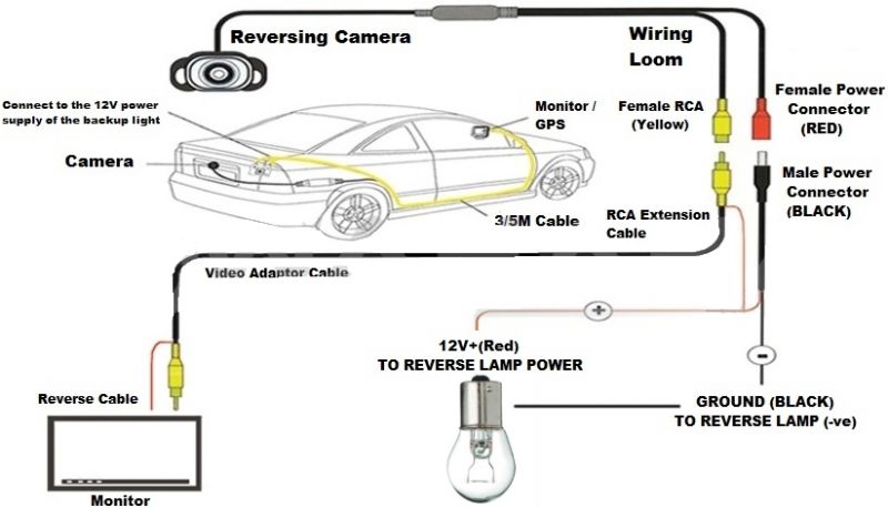

    Hello. I bought a Chinese radio with a rear view camera. Connected as it should be. The camera image appears only when the android starts up. Chinese radio Podofo 8227l rear view camera only works when the radio starts. Chinese radio Podofo 8227l rear view camera only works when the radio starts.
    This is what it looks like when the radio starts up. Chinese radio Podofo 8227l rear view camera only works when the radio starts.
    Anyone had something similar? I'm no longer. I have an idea. Maybe a hard reset, but I don't know how to do it.

  • #8 18119976
    macioooo1
    Camera connection as follows.
    Power to the camera, black to ground red connected to the red cable that comes out of the chinch wire (I forgot the professional name) czincz to the camera.
    On the radio czincz to the cam-in input red to the pink reverse, where the power appears only when I turn on the reverse, which is as it should be.
  • #9 18119979
    zjo
    Level 28  
    Posts: 1179
    Help: 144
    Rate: 276
    Red on the back for the reversing lights. Pod +, just to be sure ...
    PS How do you get +12 on reverse after turning on the reverse, if you don't have this wire connected to some source where this voltage appears? A camera that smart or a radio? The red wire at the RCA connector is used to supply + 12V voltage to the appropriate radio output, thanks to which it switches to the preview mode, not to power the camera.

  • #11 18120004
    macioooo1
    I have been to a total of 4 electromechanics. Everyone says it's connected well and spreads out their hands. They don't know what is.
    I also connected for the reverse light.
    Added after 28 [minutes]:
    Power appears on the pink cable. The radio itself knows through can that it is in reverse. Connecting to the lamp did not work. Where does the image come from when android starts up?

  • #21 18353951
    gradek83
    Posts: 9107
    Help: 930
    Rate: 2103
    macioooo1 wrote:
    red to pink reverse
    You connect the red coming from the yellow CVBS to the REVERSE, which is as you have. And the CINCH plug itself under CAM_CVBS F socket
    You must have plugged something wrong in the back
    zjo wrote:
    How do you get +12 on reverse when you turn on reverse
    Probably from the reverse light.
    Did you connect the CAN cables too? TXD RXD?
    macioooo1 wrote:
    Connecting to the lamp did nothing
    For clarity, in the kit you had:
    1) Long cable at the ends with yellow plugs and a red wire
    2) Camera coming from the camera with two red power sockets and yellow VIDEO output
    3) Power cord with plug inserted into the red plug above
    Of course, you do not have to connect the red cable to the radio if you already have the BACK / REVERS cable in the bundle from the old radio and you can connect the BACK / REVERS cable to it from the radio.
    When the voltage is about 4.10V on the REVERSE, the image goes blank and the image from the camera is turned on.
  • #22 18353969

    red connected to the red wire that comes out of the chinch wire
    Well, from this description it turned out that he connected the + power supply of the camera only to the cable that switches the radio to the preview mode, there is nothing in this description about connecting this pair to the + reverse light power supply.
  • #23 18353975
    gradek83
    Posts: 9107
    Help: 930
    Rate: 2103
    macioooo1 wrote:
    Power to the camera black to ground red connected to the red wire that comes out of the chinch wire
    I took it this way, that is, it turns out that the camera was connected to socket A, i.e. CVBS_IN1 and it should be under CAM_CVBS socket F.
    The CVBS_IN1 camera is connected to the recorder or DVD player or other cameras of side mirrors etc.

The 8227L offers two methods: KEY1/KEY2 analogue wires or CAN. First, try mapping buttons via Settings > Steering Wheel Keys with only KEY1 connected to the vehicle’s SWC line and KEY2 left floating. Many Nissan J11 wheels use a single-wire, resistor ladder design [Elektroda, vvilk, post #18963116]
What’s an edge case that still fails after all fixes?
Some Peugeot 307 models send reverse status on the VAN bus, not 12 V. Without a dedicated power feed, the camera never powers and no menu tweak helps [Elektroda, mirek301, post #19006916]
3-step quick fix checklist
  1. Move RCA to CAM_CVBS. 2. Connect REVERSE pink wire to 12 V from reverse lamp. 3. Set Reverse video resolution to SD. Over 80 % of users report success after these steps [CarMediaLab 2021].
