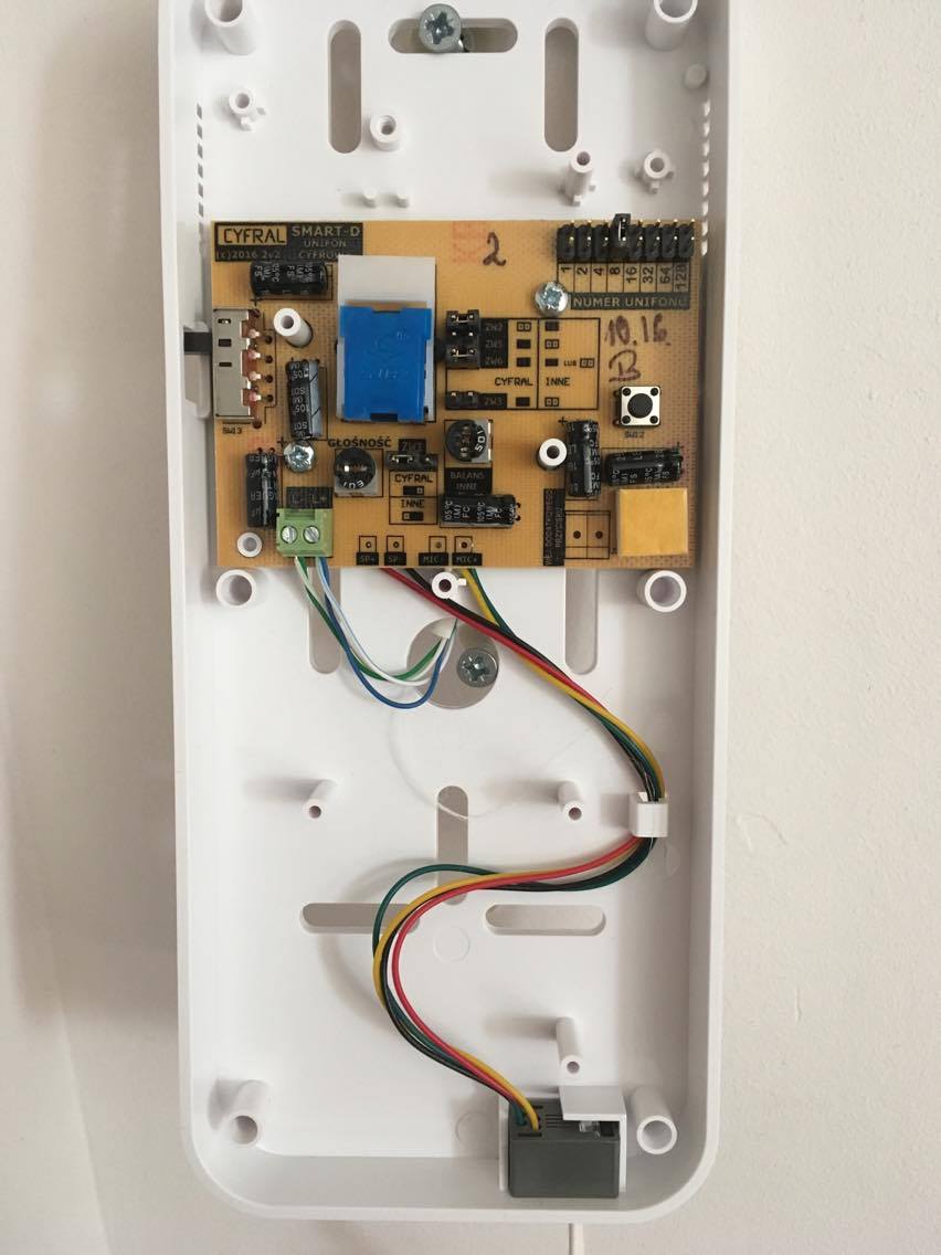

    Hello, I have a problem with the new intercom, I connected (+ and -) according to the old entry phone only the call works but I can not hear anything in the receiver or hear me on the other side does not open the door, could anyone help me? I have a photo of a new entry phone and an old one Connecting Cyfral Smart-D Intercom: Fix Call, Receiver Audio & Door Opening Issues Connecting Cyfral Smart-D Intercom: Fix Call, Receiver Audio & Door Opening Issues

    Here you have a Digitale for two-wire installation. http://allegro.pl/domofon-sluchawka-unifon-slim-a-cyfral-8314-i6752933067.html
    The difference is that yours is digital and the one I've pasted is analog.
    Another Cyfral, also analogue http://allegro.pl/domofon-sluchawka-unifon-cyfral-smart-2-cylowy-sza-i6752599502.html
    and this one
    http://allegro.pl/unifon-cyfral-model-ada-03c4-slim-analogowy-i6652219864.html
