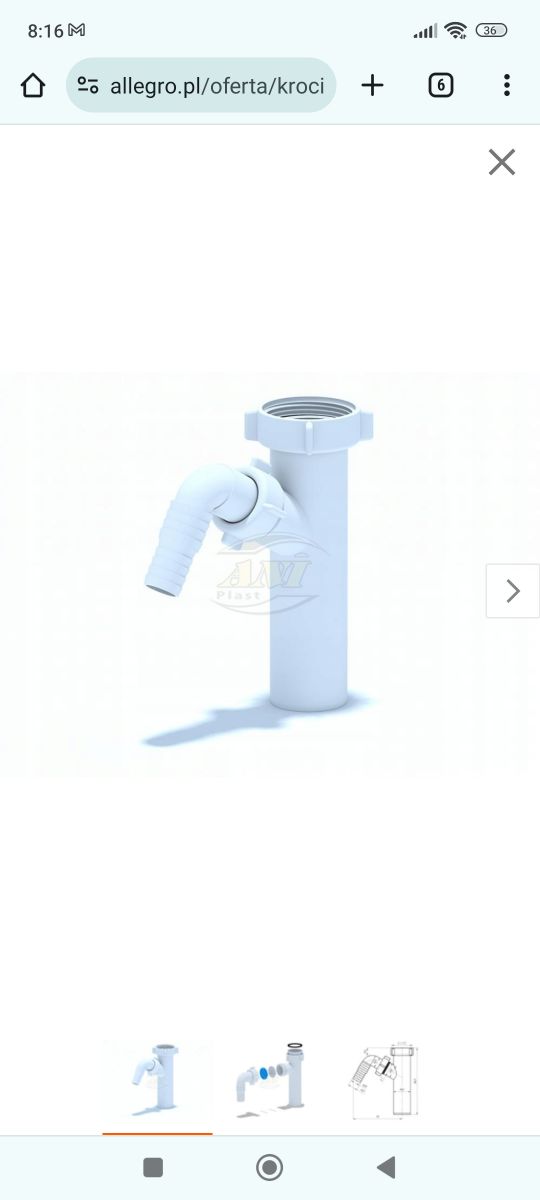

    Don't listen to these pseudo-advisors, because the bricklayers have read a lot and are throwing out dimensions here, the drain should be above half of the drum, standard washing machines are 85 cm high and the drum is approximately 45.46 cm from the floor to the axis, so if you make the drain 50 cm, it will be lux😉
    Added after 8 [minutes]:
    >>16599533
    So why would this be a problem?
    You install something like this and the problem is solved.
    White plastic drain siphon with a flexible hose, seen on a white background.
