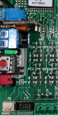

    I have a FAAC740 drive with magnetic sensors, a photocell and a remote control. The drive has been operating for two years, but recently at
    closing, it stops responding to the magnetic limit switch - it reaches a post and a beech. You have to stop it with a remote control.
    I read some of the posts and it seemed the problem was with the reed switch or the magnets.
    During the tests, I noticed that the FCC LED goes out when opening, but the FCA does not go out when closing.
    However, after dismantling and disconnecting the sensor (J5) and checking it with a meter, it turns out that everything is OK: one contact reacts to one magnet, the other to the other. However, when the reed switch is connected to the drive, only the FCC LED goes out and the FCA does not react.
    However, I noticed that after removing the reed switch from connector J5, both LEDs are on - should they not go out then?
    When I short the middle pin with one of the extreme pins, the FCC goes out, but when I short the middle pin with the other FCA pin, it still lights.
    The tile is clean and dry. Logic set to EP, I checked the settings - everything seems to be OK.
    The gate also works without any problem.
    Does anyone have an idea what could be the reason?

    The board can be clean and dry, but remove the terminal block and remove the green plastic from the pins. Very often, under this green stand, the tracks corrode and get short circuits or interruptions (if there is a connection - patch it, and to be sure, correct the February pins) - and the drive behavior indicates a break.
    If nothing else - follow the whole way from the FCA terminal to the Prock leg - and check especially the condition of the resistors R46, R47 and R48 (all 47kOhm).
    There is a schematic for 740 on the forum - look for it.
    No - the active input is shorted to ground and as you wrote in the next sentence - the LEDs should be on in the free state (without the magnet - the gate in the middle - similarly with a disconnected switch) and go out when the appropriate magnet is brought closer - or the corresponding pin is shorted to ground, i.e. to the middle leg of the connector. If it does not go out - indicates a break from the FCA entrance somewhere on the way to the prock (or damage to the prock entrance itself - rare but possible).

    I removed the plate and looked at it - everything is clean, fresh, also under the plastic of the connectors.
    So I measured the path from FCA to the CPU and got stupid:
    first, the resistors are 32k each, although 473 are described, i.e. 47k according to the diagram.
    second: the resistance between points TP41 and TP40 is 36k and yet it should be a sum, i.e. about 65k
    it is similar on the FCC line: each of the R40 and R41 resistors is about 34k, but between the TP35 and TP34 points I measure 42k
    And there is 32k between FCA and FCC inputs.
    Resistance between pins of connector J5: extreme left to middle: 11k, extreme right-middle 22k.
    Board measured on a table without power and all connectors disconnected.
    And now the best:
    I decided to check how the drive will react when I change the sensor operation by inverting the J5 plug (possible after removing the plastic on the connector).
    But first, I connected everything normally and ... it goes!
    Although the FCA LED still does not go out, when the end magnet on the gate is approaching the code changes from 06 to 00 and the gate politely stops.
    For now, I have no idea what this could be about. But because the drive works, I leave it as it is until some insight or suggestion from someone else's side.
    Thank you for your help, but if anyone else has an idea, please.
    greetings
    Jarek
    PS I could not find a schematic diagram on the forum, but I found it on the network - maybe someone will need it, so I am enclosing it.

    As for resistance measurements - measuring the soldered resistors gives strange values because apart from them, other things are also attached from the outside - for example, there is a stabilizer between the ground and the 24V plus, which probably shows some resistance, on the other hand there is a proccess that will probably show something on the ohmmeter and that everything is connected in parallel ...
    In fact, for the measurements, you would have to cut off the entire diode-resistor input circuit from power, ground and prock and then measure.
    It's probably easier on TP 40 and 42 to measure the voltage to ground when shorted to ground (it should be at the digital 0 level, i.e. below 0.8 V), and in the unconnected state - digital one (above 2.4V).
    As for the lighting of the diodes on the disconnected limit switch - in fact (I wrote incorrectly earlier) they should not light up (maybe there is some leakage after all - for peace of mind, I would rinse the input circuits with IPA or spirt and soldered everything). They should work as NC, that is, the attached limit switch in the passive state shortens FCA and FCC to ground, and only the magnetic run-on opens the appropriate direction (the same as NC STOP and EDGE inputs work - short circuit to ground - passive state - LED is on, open - active state, LED goes out). Check it manually - short-circuit both switches of the limit switch to ground, the gate moving in the given direction, when opened from the ground of the pin, of the respective switches, should stop.
    However, I would bet on a damaged magnetic limit switch - a classic problem in the 741.

    Maybe a relay, and for now check the condition of the board under the limit switch connector and the circuit leading from the limit switch pins above for moisture, tar and corrosion (the LED is connected to the input - you can say - for a short time, only through passive elements - without the use of digital circuits and not necessarily will correctly map the input state). To be sure, check the voltage on the 14th pin of the processor - (or on the test point 34 - the control unit diagram is on the electrode) - when the limit switch is closed (i.e. on the LED - the gate status during movement) it should be 0V, and when closed - high - i.e. above 2 -2.5V.
    As if a relay - there is RL2 from the direction, and it is controlled by the T6 transistor (BC817 SMD)
    The FCC diode goes out so I exclude the reed switch
    Do not exclude so quickly and nevertheless check manually - on the closing gate, remove the limit switch plug (the input is NC - closed at rest) - the gate should stop.
    PS - in this drive the reed switches operate atypically - the sensor has built-in small magnets supporting the reed switches and the magnets on the toothed bar, when approached, cancel the magnetic field of the reed switch and the reed switch opens - it works "in reverse" (NC).
    Thanks to this, it is also possible to identify which magnet reaches the sensor.
    But hence (I suspect) the constant failures of magnetic sensors - reed switches when closed permanently for a few years like to stick together, and after these few years, poor quality magnets like to weaken.

    The relay may have a working coil and control, and the contacts are stuck, on the other hand, they are not relays - the drive stops opening - so the relay works, the gate moves when closing and opening - so the direction relay works too.
    Check - as I wrote earlier - the gate's reaction (not the LED) to manual closing and opening of the pins in the limit switch connector (the middle one is COM, the COMA short with the corresponding direction means the switch is at rest - i.e. with both pins shorted to the middle one, the gate should be able to go both ways side, opening one from COMa should simulate a working limit switch - and stop the gate moving towards the simulated limit switch).
    And check the transitions carefully - in the fig is marked in blue and red and the resistance (94 Kohm) is marked in black.

    I wrote as you wrote J5 and nothing, the same phenomenon, the transitions are checked ok. It turned out that there was no transition between the two 47 Kohm resistors. I corrected February and the meter showed 42 Kohm (not 2x47 as you wrote). As the next resistors at Open A and Open B showed the same, I decided to check the pd board with voltage.
    I connected the disc to the drive and it started to work.
    Conclusions:
    thin tracks, where there are soldered joints, will corrode over time and the tin will oxidize, these are such imperceptible cases that it is impossible to see. I cleaned the IPA after corrosion (white powder that precipitated, and what I noticed was that I improved the paths and connections of the components where I noticed corrosion. The connections between these two resistors I must admit that I did not check, just now, as you wrote to check the resistance there.
    When the closing magnet was brought closer, the FCC diode turned off and that confused me.

    As for the resistors - I do not know what they are, but according to the diagram and on the photos from the net (I do not have a comparison on the original, I can see the drive only for a few days or hours, then it is already installed), both resistors have 47K, the lower value is read may result from the fact that it is connected to the rest of the circuit - e.g. there is a current loop through a chip with LED and a processor, both of which are connected to a common power supply ...
    But that's a detail.
    The LED was working because on the one hand it is powered (through the passive system) from 24V, and on the other, when the limit switch is shorted, it is massaged by 2 10K resistors connected with the contact of the limit switch to the ground - just before the said 2x47K resistors, and the break was just between them.
    In general, all input LEDs are similarly connected - and likewise completely independent of the prock. Prock's life is evidenced by a properly working display.
    As for invisible corrosion - there is one more (if what) place - paths under the green pin caps. In the case of strange drive behavior, the first move is to remove all overlays and check the situation under them.
