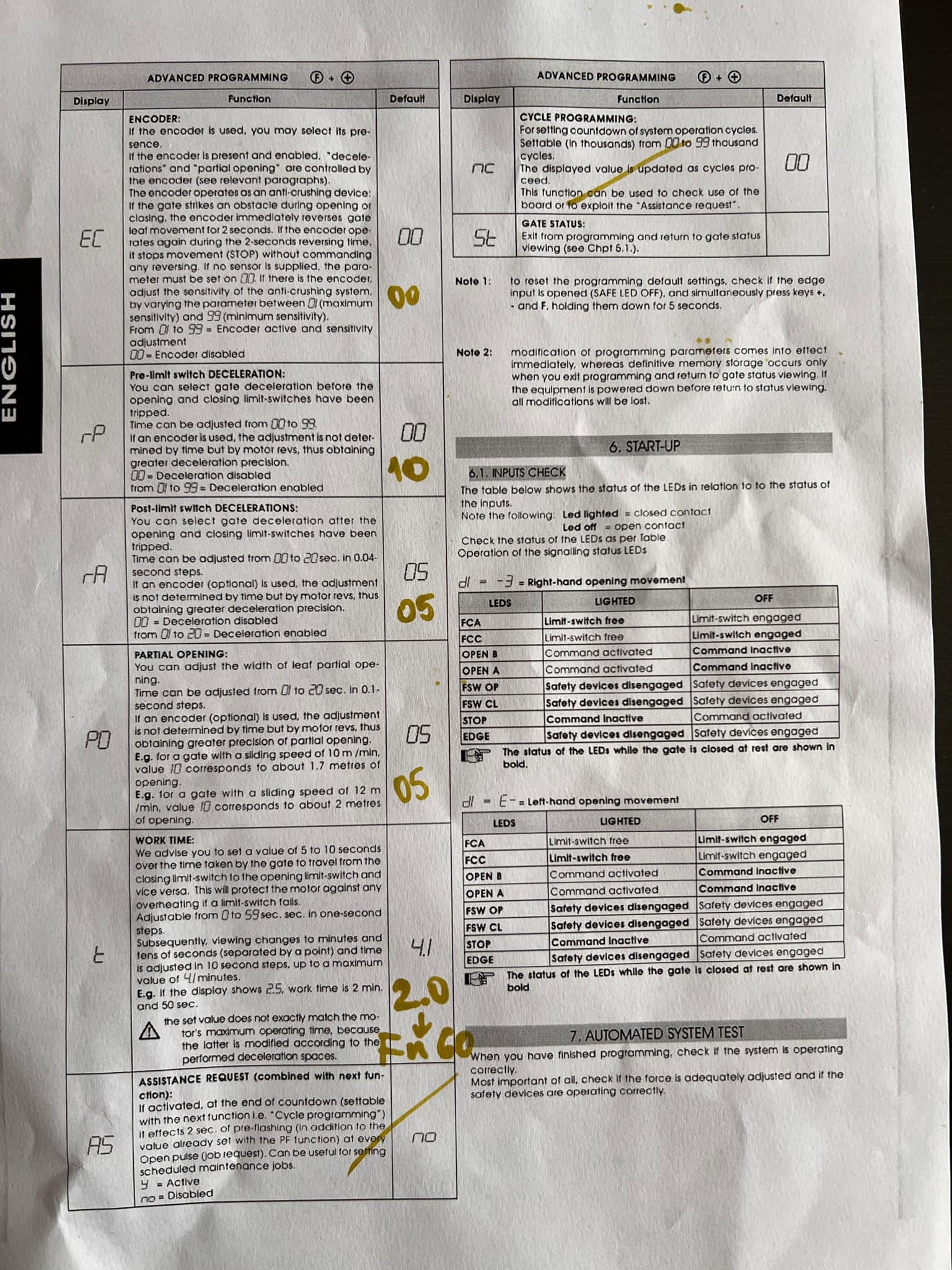

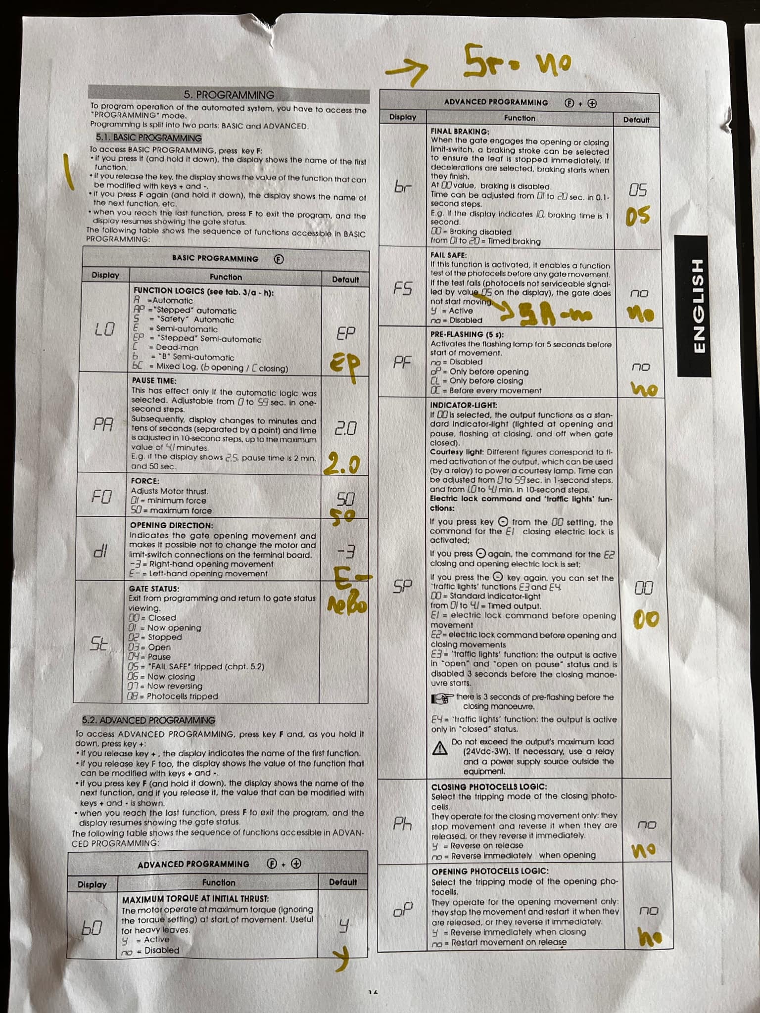

    zlatkovmsb
    oh I'm new here, and I just saw that you answered my problem even though I wrote you a private message a while ago. But here I will try to summarize my problem once again with videos - please watch all three videos: the first video is where the motor behaves strangely, but the characteristic is that if I turn off the power supply and turn it on again like in the second video - the motor immediately continues to work normally. Yes I have an encoder but the values are 00! In the third video I removed the motor's protective mask and made another video with the problem. Please give me specific suggestions for the values of WORK TIME? rP? rA? And still keep in mind that if the values of rP and rA are 00 the motor will suffer in the long run. The door in the video weighs about 200 kg
    Added after 11 [hours] 39 [minutes]:
    To have whole picture
    I will add a photos of how my motor is set on basic and advanced parametars
    Faac 740 Gate Opener Malfunction: Troubleshooting Steps Needed61c8e982-8...13c87e.jpg (430.89 kB)You must be logged in to download this attachment.
    Faac 740 Gate Opener Malfunction: Troubleshooting Steps Neededd9c51d55-4...cfdd41.jpg (424.81 kB)You must be logged in to download this attachment.
