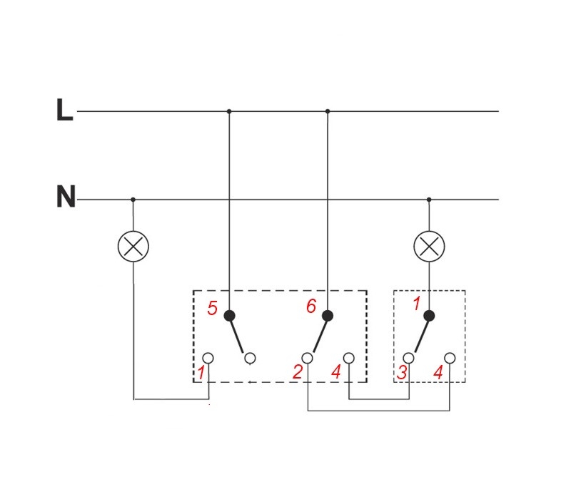

    I would like to connect a double stair switch for two circuits, but one of these circuits also wants to control a single stair switch, something like below:
    Connecting a Double Stair Switch for Two Circuits with a Single Stair Switch Integration
    I tried several connections, but whenever the button from circuit 2 is in the off position (down) there is no phase in a single one ...

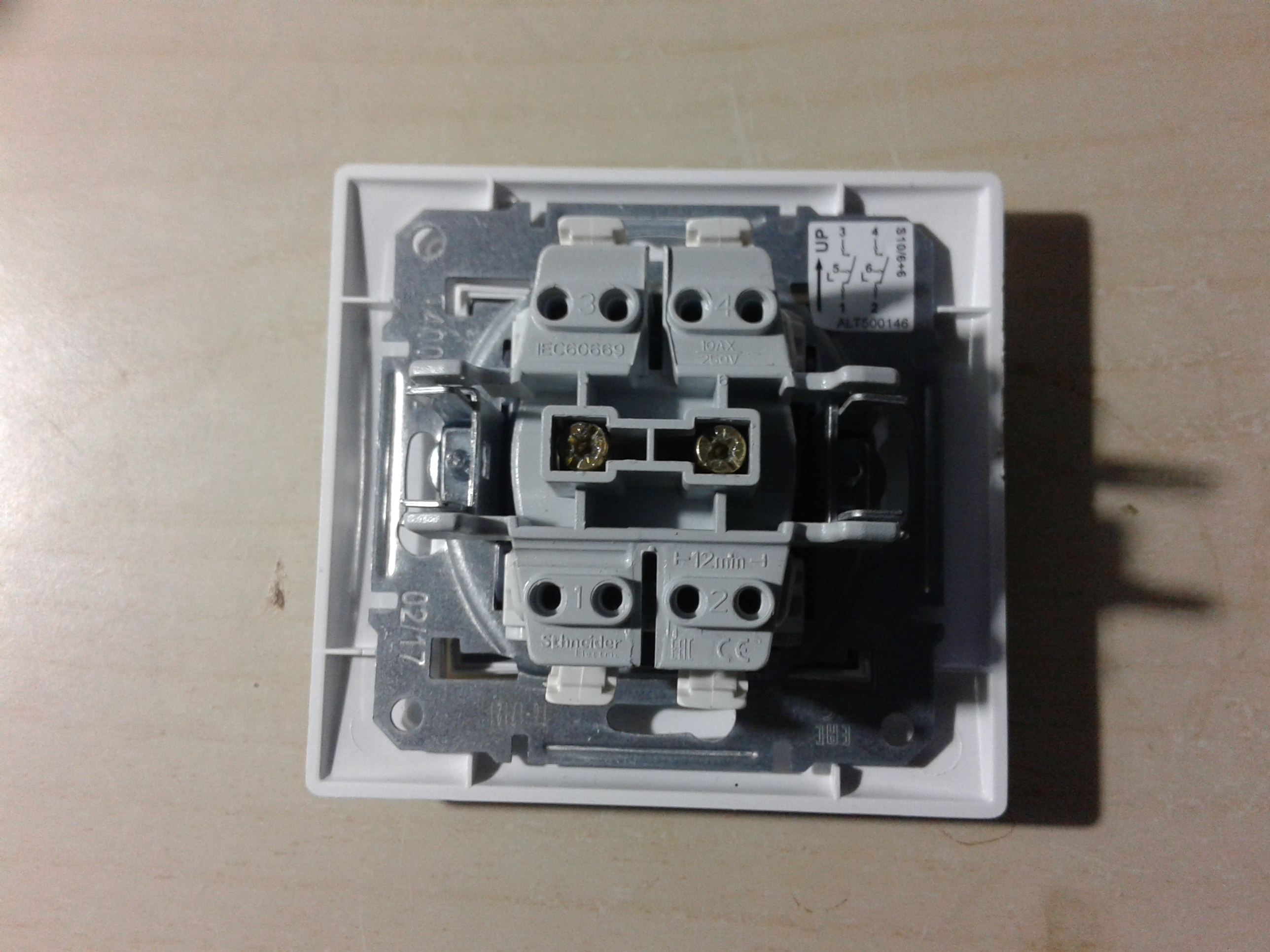

    Switches I have:

    And which lamp are you having trouble with?
    Unfortunately, with a single switch ... when I press the button down in the double switch, there is no phase in the entire circuit ...

    Double staircase: phase on L and bridge on second L. Outlet for bulb 1 on the left part, eg from 1. On the right part 2 and 4 respectively on 3 and 4, and from 1 on a bulb.
    On the right, parts 1 and 2
    More like 2 and 4.
    More like 2 and 4.
    Thank you very much for your help ... as usual, I was not disappointed with the users of this forum ^ _ ^ .. The switches work perfectly ...
