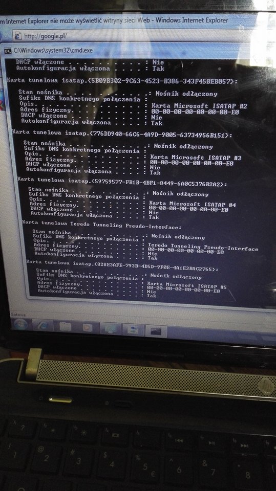

    Hello !
    The problem is as follows:
    The internet at home works fine, other computers have access to it, but today I got a laptop from my friend, I formatted him, I uploaded new drivers and the internet is gone. An exclamation point is displayed and in troubleshooting the message NO DNS SERVER is displayed. There is no internet on wifi or LAN. Someone could help?
  • #2 16609677
    wojt3kka
    Posts: 35
    can you check the network configuration?
    Start -> type "cmd" enter -> type "ipconfig / all" -> ctrl + a -> ctrl + c-> paste to the post "ctrl + v"
    pozdr

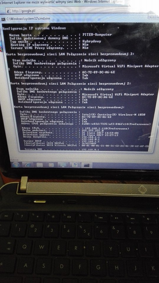

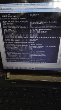

  • #3 16609735
    PatrixXx98
    Posts: 18
    Please :)
    DNS Server Unresponsive on Reformatted HP Pavilion dv6: No WiFi or LAN Connectivity
  • Suggesting DNS addresses and checking router conflicts
    #4 16610942
    wojt3kka
    Posts: 35
    first turn off wifi and check on ethernet if it works. In the configuration it looks like you have two routers at 192.168.0.1 and 192.168.1.1. If it's the same router, it probably shouldn't work.
    by. the current settings, the wifi card works in address 19.168.1.1 and dns is in address 192.168.0.1. you can add dns addresses which should help (e.g. orange / tpsa: 194.204.152.34
    194.204.159.1)
    pozdr
