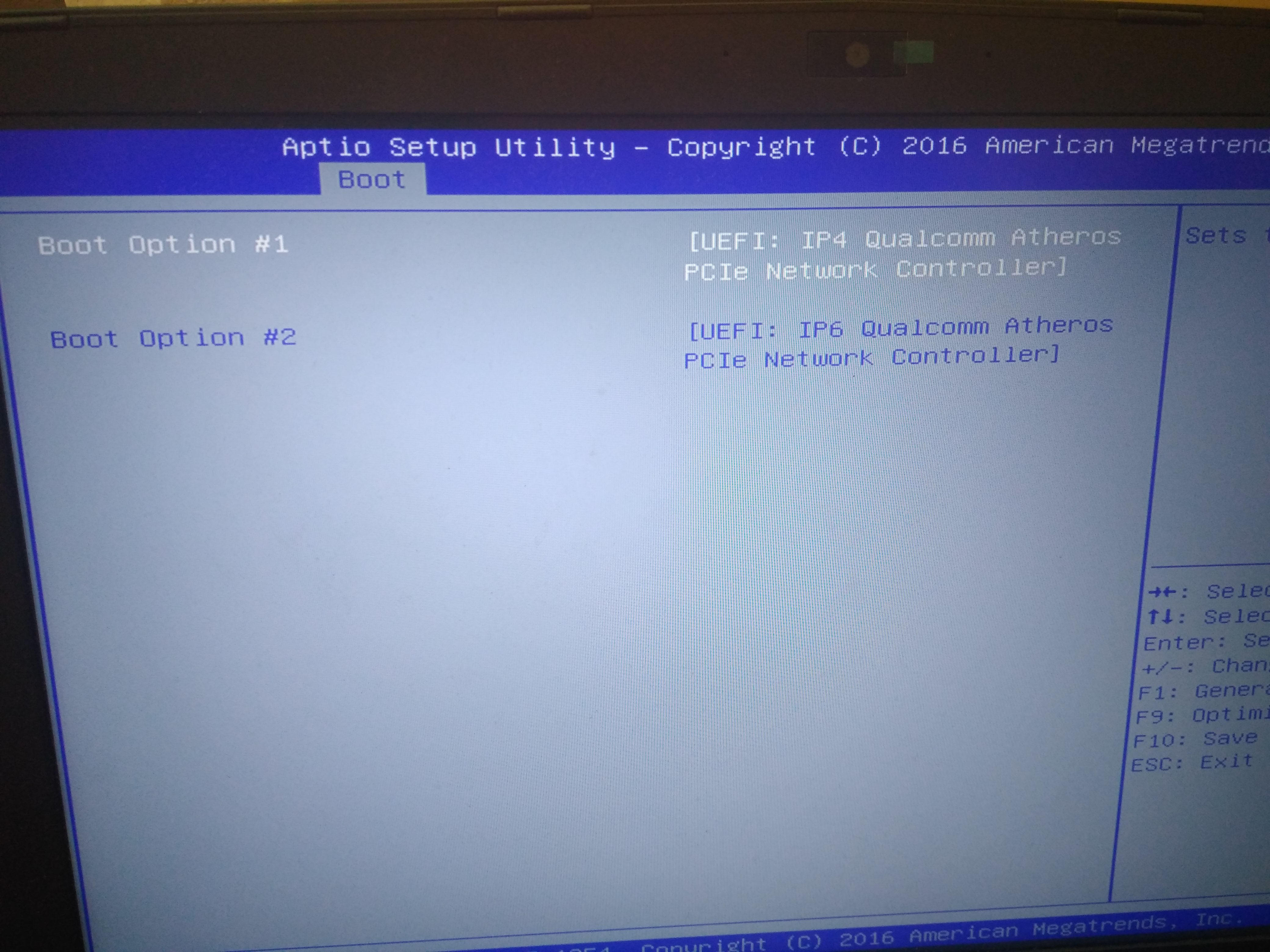

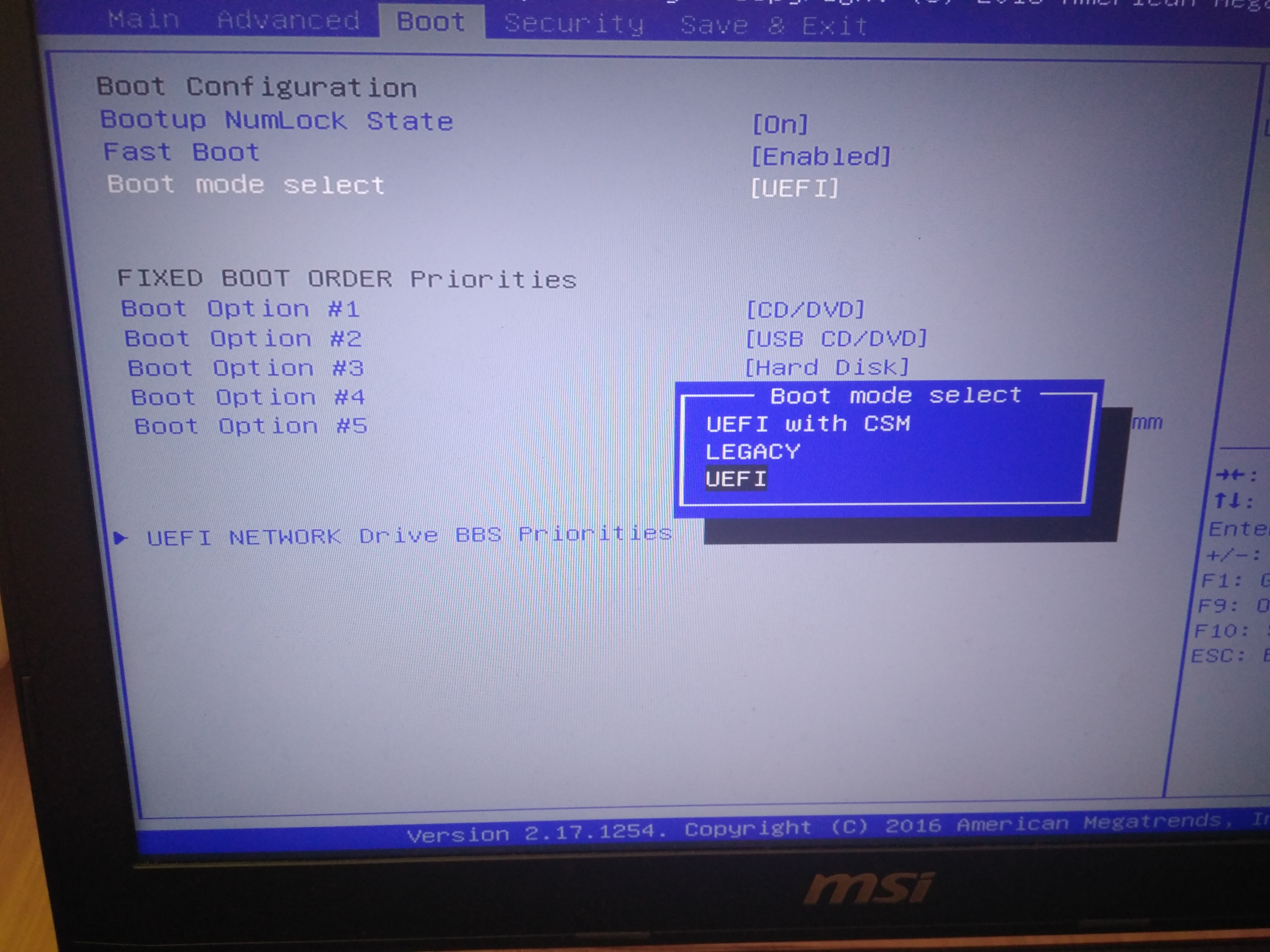

    Hello. I have a MSI Gl62 6QF laptop, Windows 10.
    It happened about an hour ago. As usual, I was browsing mail onet. However, this time the screen was stuck for a moment, after which the laptop turned off and started again with the message on the screen "cheking media presence, no media presence". I have already looked at several topics related to this problem, on the electrode, but everywhere the disks were replaced and new windows were installed. The laptop was not unscrewed, nor was any other operating system loaded. I noticed that this is UEFI. Below I attach photos. I apologize for the cell phone quality of an older date. Does anyone have any idea to solve this problem?

    I wonder if my friend's disk has fallen. The main tab from the BIOS could be useful, because we don't know if the disk is detected by the computer. It is not listed in the BOOT options. But also there is no Windows boot manager that starts new systems with UEFI

    Posts: 10
    A colleague had a disk check program on the board, so he looked at it and was 100% functional. Which surprised me and turned out to be the truth, windows fell. I uploaded it again after a short fight because I didn't want to read the CD at first, but it's completely fine now. Although it still surprises me that he spilled from browsing e-mail onet, not a single bluescreen before, he was also not overheated or anything in this matter. In any case, I already have peace.
