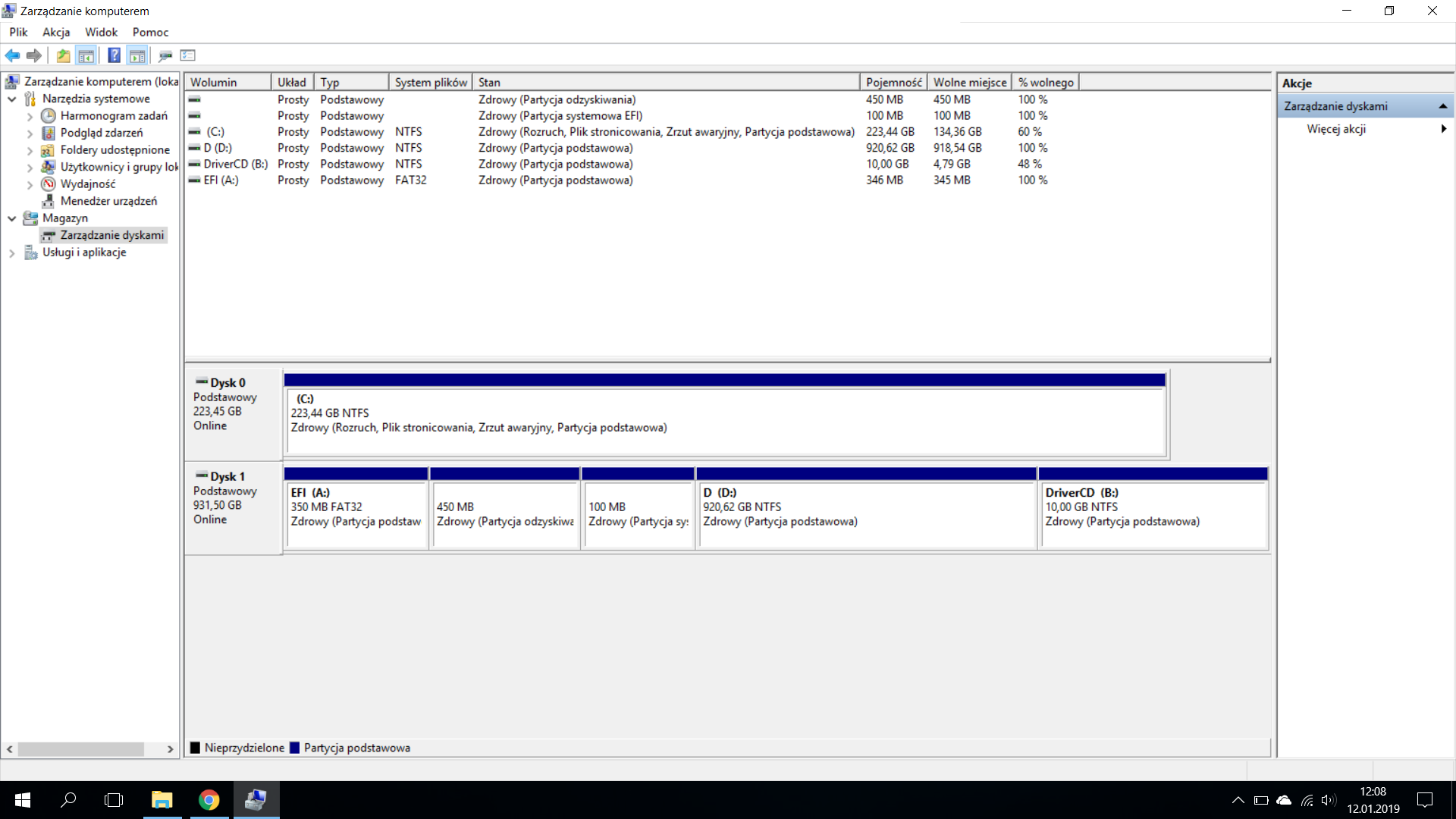

  • #5 17694917
    antrakt128
    This is what it looks like in the disk management table.
    • MSI GF62 - How to disable EFI SHELL before booting the system? b.png (221.03 KB) You must be logged in to download this attachment.
  • #6 17695024
    sylweksylwina
    Posts: 13216
    Help: 1882
    Rate: 2355
    It is impressive how much it got mixed up :D It was a new laptop? Have you added any disks? You have the system on SSD, but the rest of the partitions are on the second disk ...
    Personally, I would unplug the hard drive when installing the system, install the system on ssd, and then on hdd I would make a copy of the partition with the drivers, e.g. clonezilla, and wipe the partition table.
    Restoring it without reinstallation would be a nightmare, and this configuration is absurd, in the event of a HDD failure the system will be useless (it will not be bootable)
  • #7 17695091
    antrakt128
    Yep it's a new laptop and I put SSD in it and this problem occurred after system installation. I'll try to do as you say.
