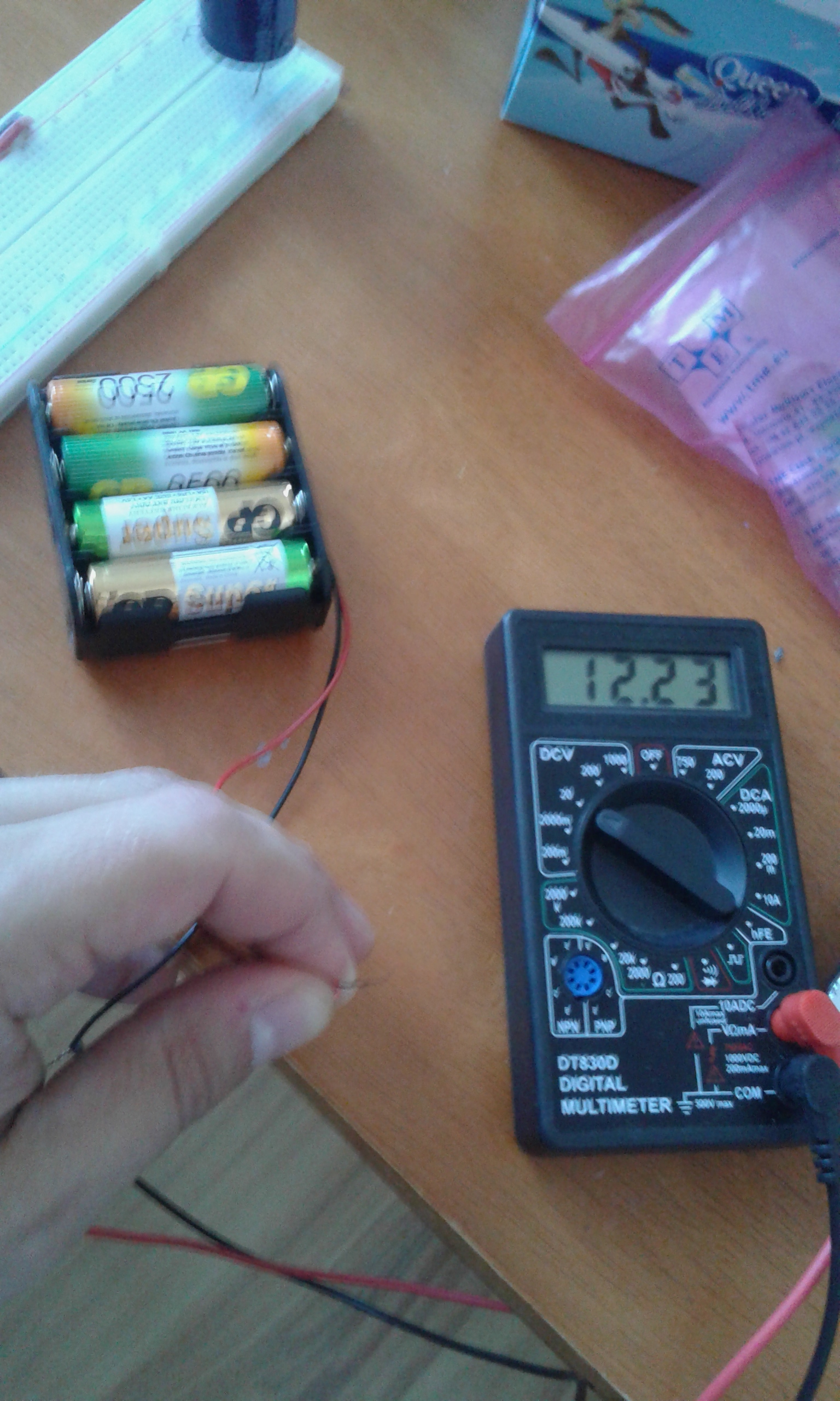

    OK, let's go.
    For the sake of convenience, although I have a 16V panel, I decided to use a basket of 8 AA batteries.
    Can I connect DC to the AC heater? Will I damage the panel in the sun?
    Added after 7 [minutes]:
    So we have:
    (from left)
    1. Voltage source.
    2. 50V capacitor.
    3. Voltage divider (due to small losses I used large values - R1 is 986kOhm and R2 is 266kOhm).
    4. Arduino connected according to the diagram on the above-mentioned page.
  • #27 16626566
    gaz4
    The parameters of the linked transistor allow the heater to be powered with a considerable margin. Since there is already a test "spider web", I propose to improve the PV simulation by adding a serial high-power resistor (probably 1 W is enough) between the batteries and the capacitor. Or rather two in series, because on one it will be difficult to simulate a real PV - the voltage between the connected resistors is the PV voltage (we pass it to the arduino), and on the capacitor it simulates the voltage on the heater. Such a system will simulate various types of insolation, direct connection to a battery does not allow it. If the algorithm waits for the voltage on the capacitor to increase to max, we will obtain a Uoc simulation, and we need a voltage around Umpp which is slightly lower. Therefore, the algorithm should be modified so that, regardless of the load, the measured voltage varies, for example, between 10-11V (Umpp simulation), and not approx. 12V (Uoc). If we can connect to the capacitor incandescent lamps of different power, switched on by the transistor, and the voltage at the connection point of the series resistors does not go beyond the set range, everything is OK.
  • #28 16626679
    camfly1
    Gaz4, thanks for the info, I'm ordering transistors. I'll take some for testing.
    I understand that the resistor is to simulate a heater?
    Hmm. As for the program, I wanted to write so that when the voltage stops increasing (regardless of the voltage obtained) then the current is released on the heater. This would then also apply to the wind farm that I have currently constructed. (500W24V)
  • #29 16626714
    gaz4
    No, the resistor does not simulate the heater, but the PV operation with less lighting (efficiency). Batteries have high efficiency, so they do not match real PV. The use of two series and voltage measurement at the point of their connection will greatly facilitate the tests - one resistor separates from the battery, the other from the load. It is worth describing two basic PV parameters:
    Open circuit voltage Uoc - this value is obtained when we do not take any energy from PV. For GS50 it is 56.1V / 62V
    Voltage at the point of maximum power Umpp - the voltage at which the PV works most efficiently. As mentioned above for the GS50 it is 38.6V / 43V.
    And now let's analyze the algorithm that waits for the maximum voltage to be obtained and only then turns on the load. If we do not consume energy, the voltage on the capacitor will reach Uoc, because until it is recharged it is the only load that consumes less and less current, up to and including zero (open circuit). The problem is that while waiting for this voltage, we cross the point where PV is most efficient, i.e. we lose energy. Thus, from the moment of exceeding Umpp to reaching Uoc, PV works with lower and lower efficiency, up to and including zero. Another issue is the voltage at which the transistor will be disconnected and the current consumption will cease. If we wait until we reach the minimum voltage, we are in exactly the same situation as direct connection to the heater. The minimum voltage will change significantly with sunlight and will be close to zero when it is cloudy. Such an algorithm will force the PV to run in an extremely inefficient manner most of the time.
    It would be most efficient to test the power released on the heater and to increase / decrease the switching voltage on an ongoing basis to make it as high as possible. However, as I wrote, the PV will work between the Umpp voltage measured under STC and NOCT conditions for most of the year. The algorithm ensuring that the transistor turns on after reaching STC and turns off at NOCT will be sufficiently effective - at the level of 90% of PV use.
  • #30 16626989
    camfly1
    Gas4
    Thanks for the tips. In fact, it is worth adding resistors and rethinking the program.
    Why is it worth controlling the power dissipated by the heater? (It wouldn't be difficult)
    Here's how to drive these transistors:
    https://m.youtube.com/watch?v=vaZSQBpzcwc
    The datasheet of the linked transistor shows that after applying 5V (this is what the arduino has on the pin), it should release about 8A on the gate. What should be enough with 240V target.
