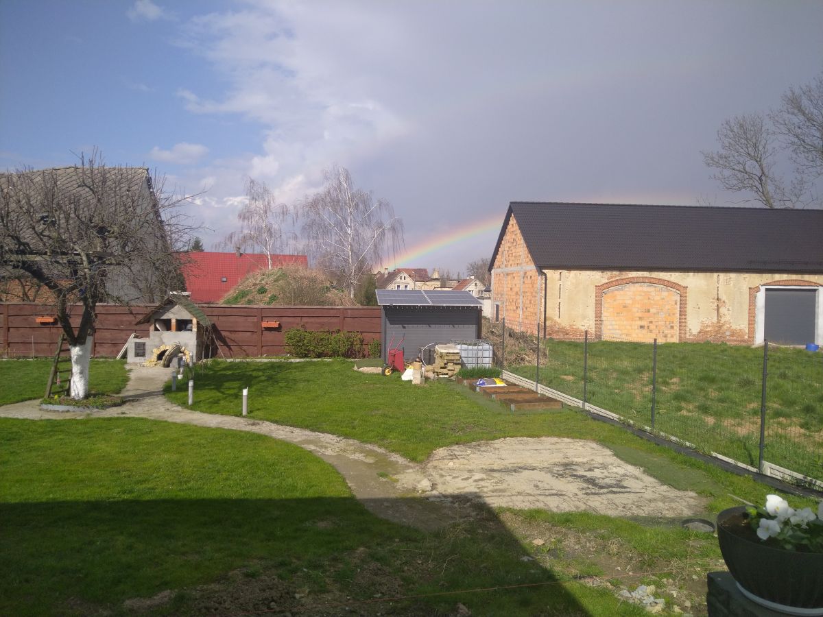

    I had to build a garden shed 20 meters behind the house and it was a miracle that I didn`t start making the roof from metal tiles.
    The location of the garden shed was ideally south, however, I wanted to tilt the roof south for aesthetic reasons with an angle no greater than 8°, and to my surprise, using a calculator for photovoltaic installations, it turned out that in the summer, such an arrangement of the photovoltaic installation can start production at more than an hour earlier, which also applies to the end of production.
    The roof surface allowed for the installation of six panels with a total power of 1440Wp.
    Garden with lawn, visible small garden shed and brick buildings in the background with a rainbow in the sky.

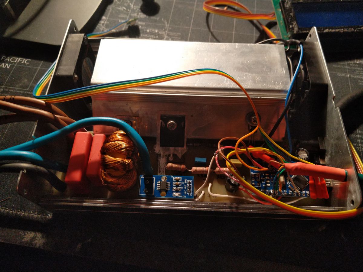

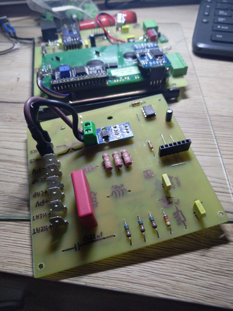

    -The first controller was simple, based on a transistor, a choke and a bit of wirework, which I prefer not to describe - the losses were still over 10%
    -The next one was based on WEMOS D1 mini and ADS1115 - Unfortunately, it often crashed.
    Electronic module mounted on a heatsink with visible mounting components.

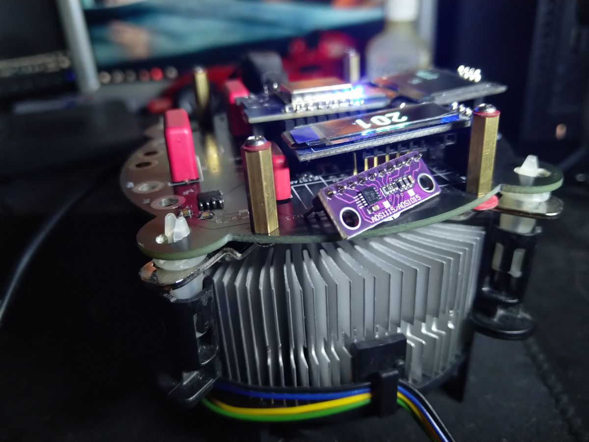

    -I based the next controller on the popular Arduino NANO and several readily available components. Unfortunately, even though I didn`t spend more than PLN 50 on it, since I had practically everything on hand, I wasn`t satisfied with it, because as it turned out, I didn`t have the right Mosfet transistors in stock. The resistance during conduction turned out to be very important, which one day led to the transistor being damaged and the water in the buffer almost boiling.
    Printed circuit board with electronic components on a desk.
    -And another...
    Interior of a prototype PV controller with electronic components

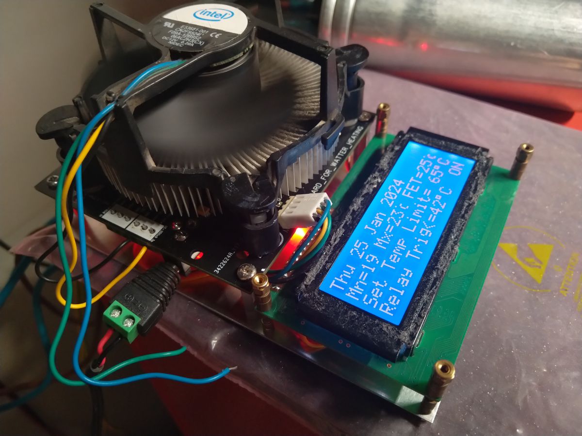

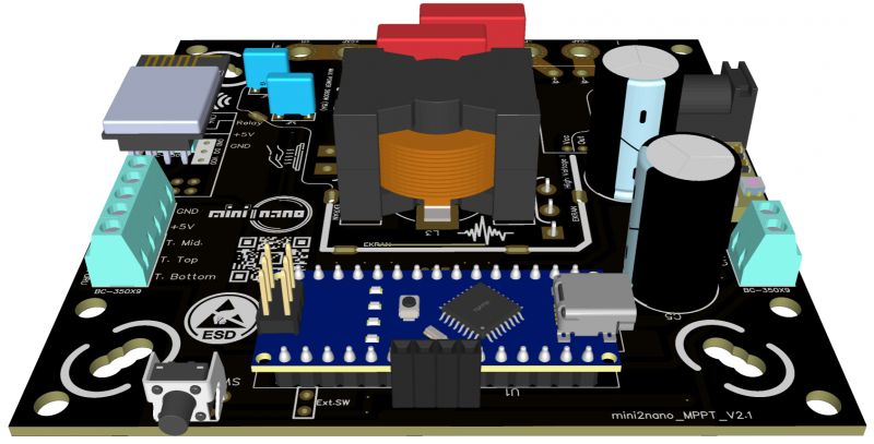

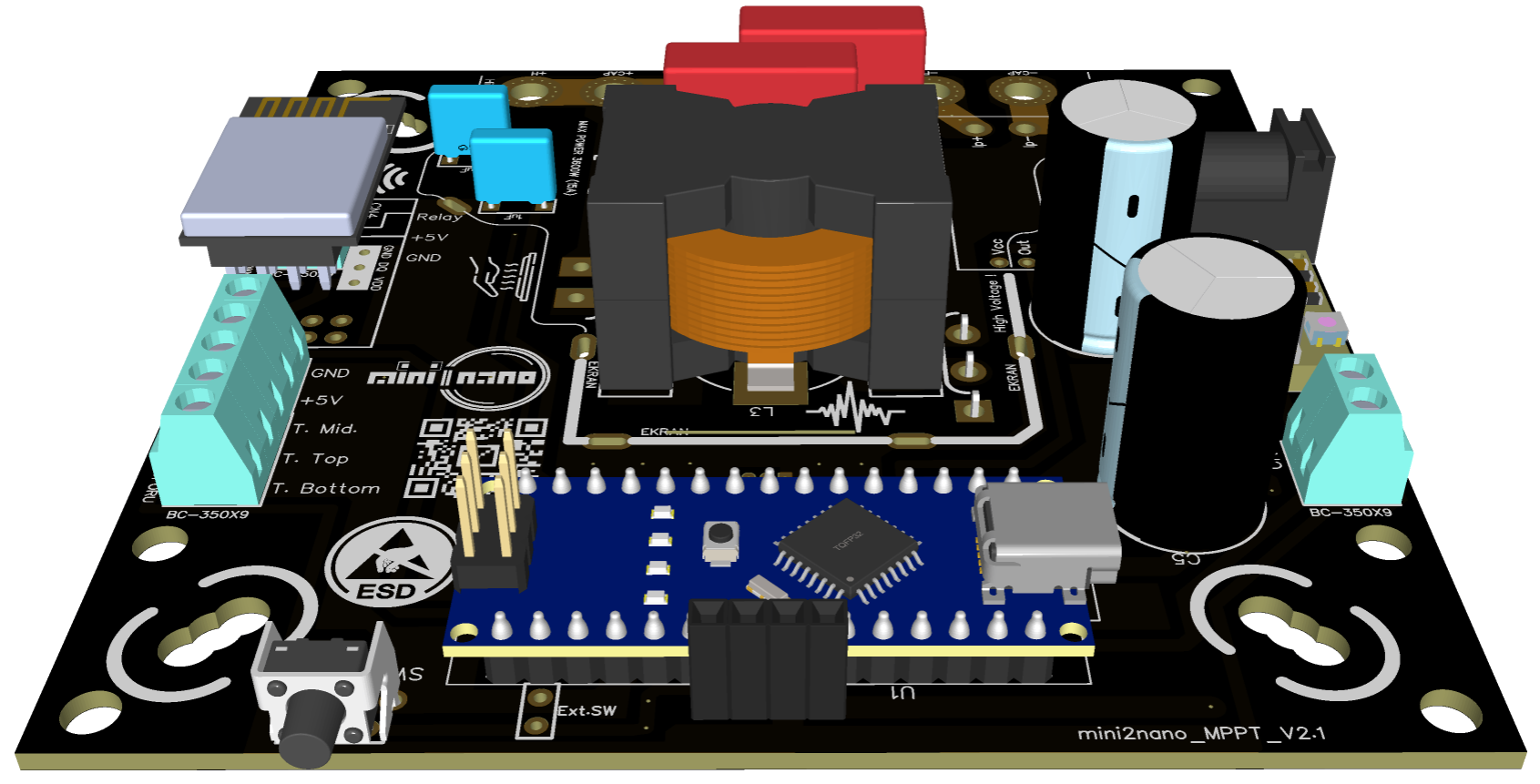

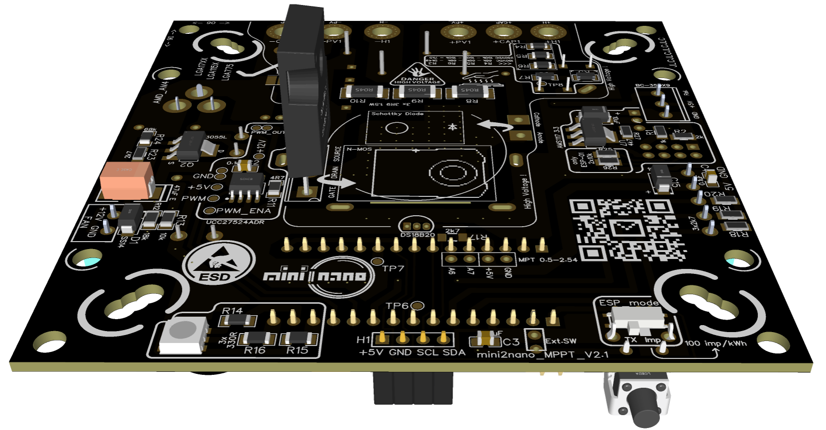

    -I tried to make the next drivers based on appropriately selected components and I started to figure out the pros and cons, taking into account available Open Source solutions as well as the capabilities of drivers available on the market, and here is the version of the MPPT driver, which I called
    mini2nano_V2.1
    View of the mini2nano_MPPT_V2.1 controller prototype with various electronic components.
    Printed circuit board of the mini2nano_V2.1 project with electronic components.
    MPPT controller with LCD display and Intel fan cooling.
    And here are its possibilities:
    -Voltage range from the PV installation <250VDC OpenCircuit (it is possible to increase the range - the IPC-2221 standard was used for PCBs).
    -Maximum current <16A (It is possible to increase the range with the ACS712-30A module and by increasing the track thickness from 1oz to 2oz)
    -The maximum power is therefore approximately 3.75kW

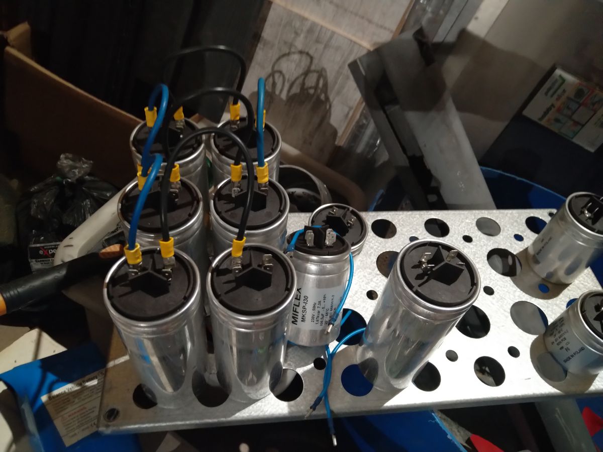

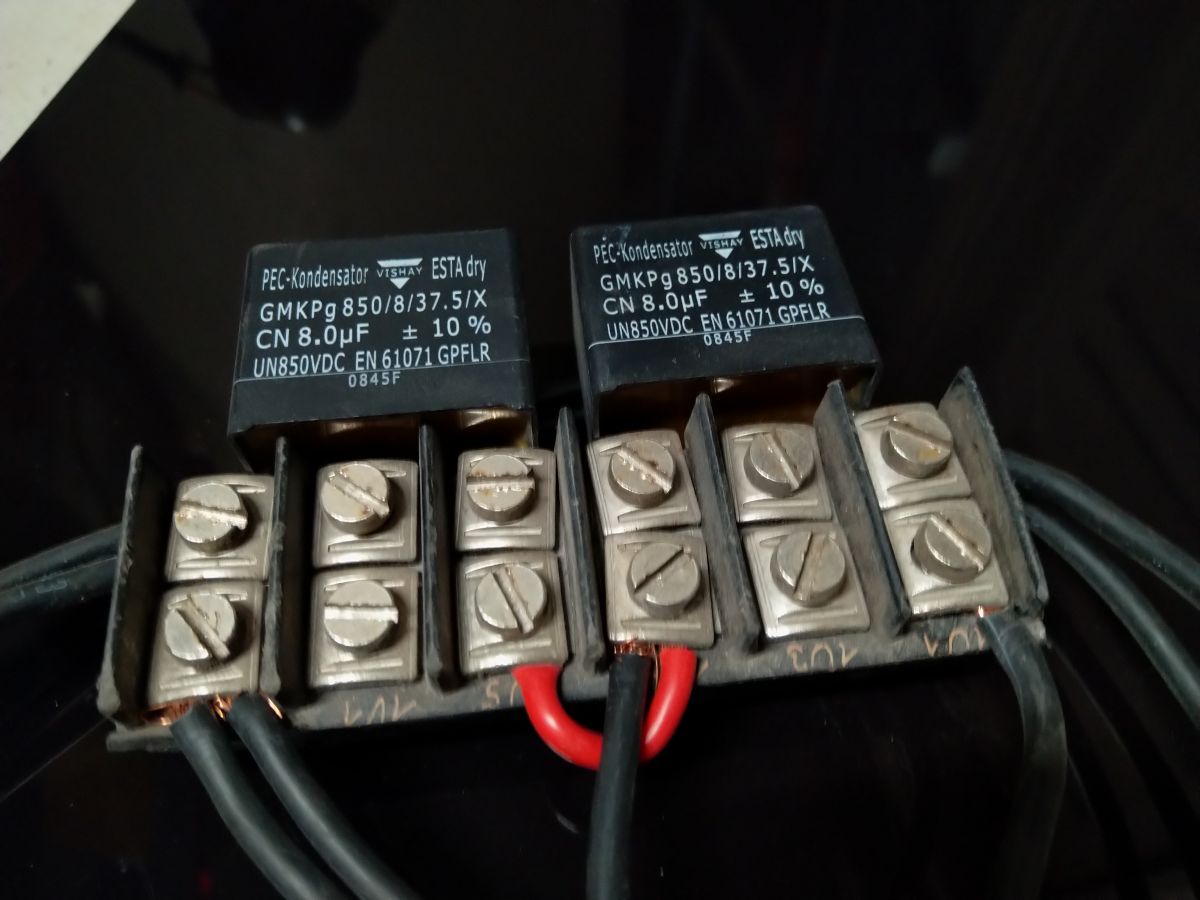

    -A 200uF capacitor is used for smooth operation (buffer operation)
    Set of capacitors on a metal frame
    -Path topology allows for individual selection of components such as: Mosfets, Schottky diodes, drivers, capacitors, etc.)
    -The MPPT P&O algorithm was used, with an efficiency exceeding 99%, with the possibility of replacing it with another one.
    -Control of tank temperatures in three levels (Bottom, middle, top) - Why three sensors, you ask? The next point will explain.
    - An additional output for an external relay has been implemented in case the weather is not good (the controller will connect e.g. a network heater located halfway up the tank and heat the upper part of the "Available water" buffer to a set value, e.g. 43ᵒC)
    -Added the possibility of using proven cooling systems for passive elements (a 12V fan connector has been added, activated after exceeding the set temperature - initially 35ᵒC)
    -The PCB has been designed so that it is possible to use computer fans with Intel LGA775, LGA155X, LGA1700 and AMD AM4 series sockets (prepared mounting holes)
    -It is possible to mount the board to any heat sink using the pressure method (all passive SMD components mounted on one side of the PCB)
    -It is possible to change the frequency of the PWM signal in the range of 2kHz – 17kHz.
    -For temperature protection of the Mosfet transistor, an additional DS18B20 temperature sensor is used in the heat sink area)
    -An additional connector has been added for individual project expansion (2x analog-digital input/output)
    -An additional connector has been added for the ESP-01 Wi-Fi module or ESP-01s based on the well-known ESP8266 for data transfer to client applications such as Supla, Tasmota, Domoticz…
    -It is possible to choose whether we want data transmission from Arduino Nano or a 100imp/kWh pulse signal at the ESP8266 Rx input.
    -Added DS18B20 buffer temperature sensor connector on PCB for ESP-01s.
    -For efficient operation, a Mosfet driver with a current capacity of 5A is used
    -An RGB LED has been added to inform about the device status.
    -The board is made using the lead-free method, i.e. "RoHS compilant" - if it`s ECO, it`s a bad idea.
    -The program performs a full system test before starting work and during work:
    -Checks the voltage range of the 12VDC power supply (The power supply allows you to extract every Watt from the panels.
    -Checks buffer and mosfet temperatures.
    -The device uses an LCD2004 display via the I2C bus (long-lasting and proven)
    -The display will show, among others:
    -Current PV voltage
    -Current PV intensity
    -The current power of the system.
    -PWM signal drive level
    -Current buffer temperatures
    -Maximum daily buffer temperatures
    -Current cooling system temperature
    -Error messages in Polish
    -Information on the status of the signal output for the additional heater
    -Date
    -Total daily production.
    - Pinout of the display connector allows for easy installation of a display such as OLED SSD1306, however, due to the extensive Adafruit library, it is not possible to write code for multiple displays at the same time (I decided to leave the topic of OLED for dessert)
    -A connector for an external button has been added if we want to mount the PCB in the box.
    -Through the USB connector and UART connected to the ESP-01s connector, it is possible to set the following values:
    -Date stored in EPROM memory (RTC clock removed - date will change automatically after dark)
    -Temperature ranges:
    -Buffer (pre-set to 65ᵒC)
    -Additional external heater (pre-set to 43ᵒC)
    -System cooling temperatures (pre-set at 35ᵒC)
    -Additionally, via USB, UART we can:
    -Call the command to start or turn off the system.
    -Invoke the full test command for PWM signals showing the peak value and MPP power point
    -Determining any PWM signal drive value.
    -Monitor the values of analog inputs and their values converted into Amps, Volts for the purpose of calibrating the system.
    -Call the intuitive MENU with a description in Polish, of course
    -Erase the EPROM memory
    -Send current values on request
    -Inquire about historical values.

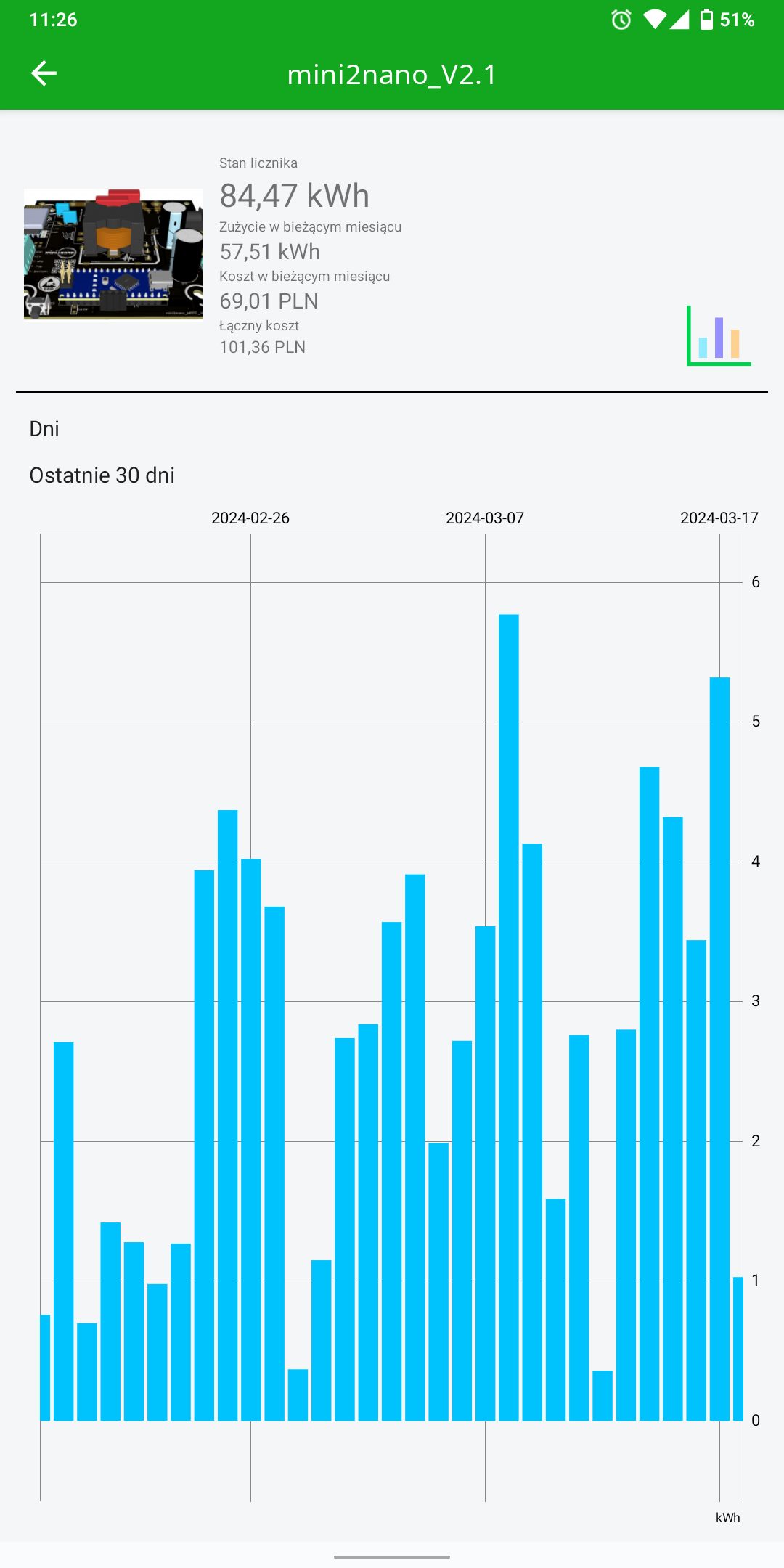

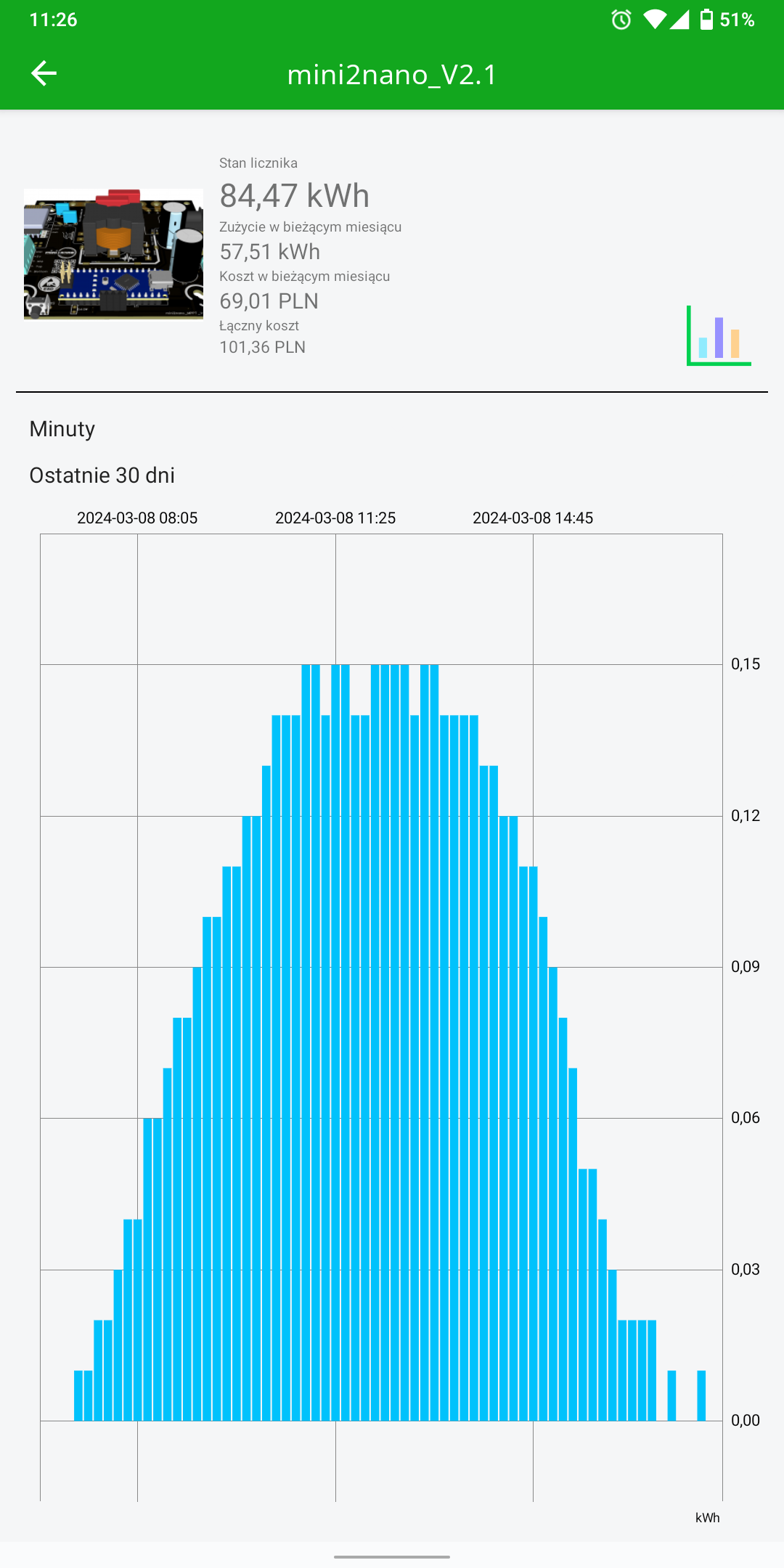

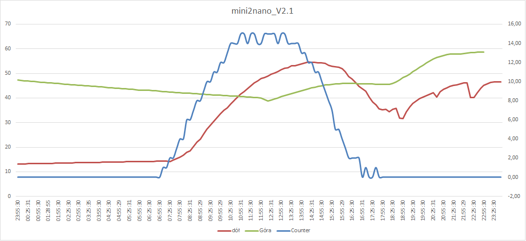

    Someone will say, hey, another controller also has a graph on the display, but this one doesn`t.
    That`s right. But the display used in my case costs about PLN 20, and if you insist, it is unnecessary, because thanks to the Wi-Fi module we have access to charts and history for free, as far back as we want, without additional SUBSCRIPTIONS, and best of all, we can choose which platform we send data to.
    Bar chart displayed on a mobile app showing electricity consumption in kWh on March 8, 2024.
    Data saved every 10 minutes.
    Mobile app mini2nano_V2.1 with energy usage graph and costs.

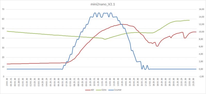

    This is the monthly production in the gloomy period of February - March
    Chart of data from the mini2nano_V2.1 system showing temperatures and a counter.
    Example of exporting power and temperature data to Excel from the sunny day of March 8, 2024.

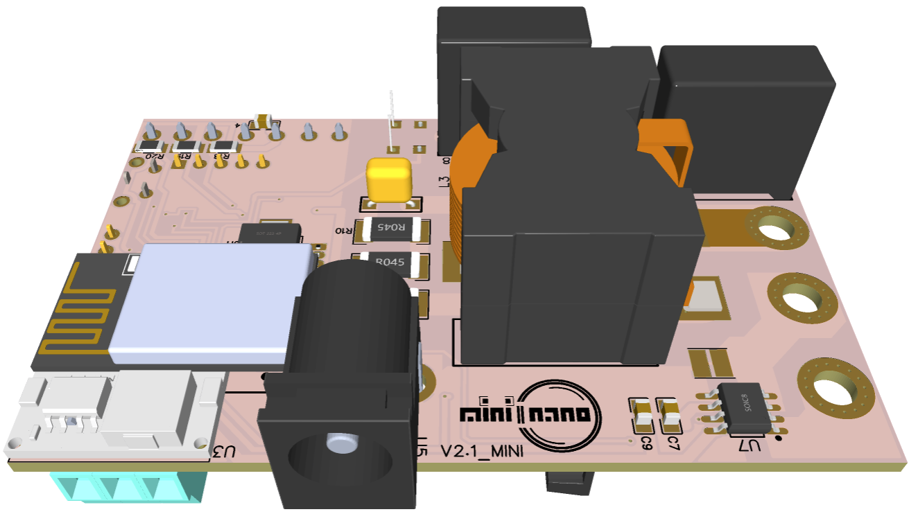

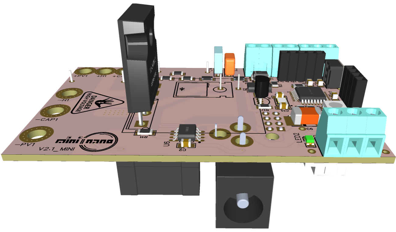

    I forgot to add that I left the cherry for the very end.
    Following in the footsteps of such well-known companies as SONY, we know that after each premiere of e.g. PS, the so-called miniaturization takes place.
    At the request of a friend, I also decided to take a similar step and on the day of ordering the laminates of the controller described above, I also designed and ordered a miniaturized version of the same design with dimensions of 50mm x 80mm (i.e. more than half the size).
    I wonder how this little thing will work.
    Below is a view of the mini2nano_V2.1_MINI project
    Miniaturized circuit board design labeled mini2nano V2.1 MINI.
    View of a miniaturized PCB design mini2nano_V2.1_MINI with electronic components.
    If everything goes according to my plan, I will definitely be proud of myself after testing this project in a system with PTC heaters.

    sq3evp
    Posts: 6723
    Help: 226
    Rate: 901
    Interesting project.
    Did you use ready-made software or wrote something of your own?
  • Questions on MOSFET, snubber, and sensor choices
    #17 21011774
    comer3
    Posts: 746
    Help: 123
    Rate: 56
    Looking at the information provided by the author and sitting a bit on the topic, it can be assumed that the base software is https://projecthub.arduino.cc/stevetearle/loa...xp-a-smart-pv-mppt-solar-hot-water-controller -5264c7 + modifications by the author of the topic with his own pcb.
    Looking at the PCB screenshots, I have the following questions for the author:
    - don`t you mount the Schottky diode plugged into the PQ2617BHA choke on the radiator? Does it get hot when the system is running at full power?
    - how do you select the RC snubber components for the keying transistor while changing the PWM signal frequency (2-17kHz) available in the controller software? As far as I know, the extinguisher is selected strictly to the specific system operating frequency and voltage;
    - why is the lowest available PWM switching frequency 2kHz? - reducing the switching frequency below 1kHz would reduce thermal losses on the transistor;
    - what transistor did you use as the main MOSFET switching transistor?
    - what was the reason for using DS18b20 temperature sensors? Switching a few kW at a frequency of a few kHz, depending on the length of the heater cable, can cause a lot of noise. Here, the EMC pulses are partially limited by a choke at the output, but there are no interruptions in transmission on 1-wire? Wouldn`t it be safer to use ordinary NTC thermistors in a voltage divider system as sensors?
    - does the controller have any protection / the possibility of physically interrupting the heater power supply circuit from the panels by activating some DC/vacuum relay in the event that the main MOSFET is damaged (DS short circuit), or is the notification via Wi-Fi only in such a case?
  • DS18B20 sensors on separate 1-wire lines
    #18 21011954
    dgproject
    Posts: 183
    Rate: 272
    comer3 wrote:
    you don`t mount the Schottky diode plugged into the PQ2617BHA choke on the radiator?
    The diode is most likely arranged parallel to the Mosfet, and yes, I admit that I based it largely on what I consider to be a very interesting project, the Loadmaster, whose work I once saw live at a friend`s place.
    PQ2617BHA, or rather PQ2614, heats up to a maximum temperature of 65°C in the middle of the PWM signal range.
    comer3 wrote:
    how do you select the components of the RC snubber
    I select the extinguisher using the program.
    Don`t worry, I don`t choose randomly 😉
    I use resistors of at least 1.5W and I also positioned them in such a way that they can be additionally cooled with a thermopad along with the transistor and Schottky diode.
    You can practically go below that and I use a lower frequency in my other project with a furnace equipped with PTC heaters. In the furnace, however, I use AUIRGDC0250 IGBT transistors that do not consume kiloHz. Initially, I used frequencies below 1kHz, but several people accused me that the melody line on the choke and coil was a bit irritating.
    Initially, I used the easily available IRFP460 and had no complaints even though it emitted a bit of heat. Ultimately, we chose STW74NF30 and SIHG80N60 because their parameters are promising and the price is not scary.
    I wanted to monitor several points of the tank at different heights and initially I had everything connected to one 1-wire data line, which actually caused errors. I use Dallas quite often in my projects, so I also used them in this project.
    Currently, three units operate on a cable approximately 4 m long and have not been disturbed by anything yet. I also measured the heatsink temperature on the DS18B20, but in this case I decided to add pads for an additional screen between the Mosfet and the Dallas.
    comer3 wrote:
    Does the controller have any protection?
    As a protection, I left two additional outputs on the PCB, where I can programmatically assign the SSR emergency shutdown threshold at the power input (e.g. TempMax +5°C). Unfortunately, I once experienced damage to a transistor and after this lesson I decided to make an additional connector for a relay, etc.
    Additionally, as you can see, there are no twisted pairs for HV cables on the board, but only soldering pads.
    This is dictated by my experience with this type of unreliable connections, so I decided that this section cannot have connected elements.
    I have been working in the automotive industry for years, producing heaters for electric cars and more, and I know what poor connections are prone to. Even the best the wires start to overheat over time 😉

    dgproject
    Posts: 183
    Rate: 272
    MarekS6 wrote:
    If there is an H-bridge at the output and the voltage is alternating, what does it look like with the voltage value - is it always the same regardless of the number of connected panels?
    What matters is Watts and the resistance of the heater, the rest is just the operating characteristics.
    The MPPT algorithm itself selects the best voltage and current ratio to obtain the best possible power. I use the P&O algorithm, which checks the current power and regulates it with voltage.
    Somehow, after Fibaro, when I discovered the green color of Supli, I remained faithful to it 😁
    MarekS6 wrote:
    I would probably have to have the "more powerful" version of the driver mentioned in the description
    Currently, I order laminates with a copper thickness of 1 oz, which defines the maximum power of the system at the applied track thickness, but nothing prevents me from thickening the tracks, or exposing the copper layer and strengthening the tracks with tin for higher powers.
    Soon I will be adding an additional 200 liter tank to the utility room (this time horizontal, but made of stainless steel), which I bought for PLN 200 after a solar-vacuum installation.
    In the period from April, I usually have the 220-liter buffer heated to the max, so a spare will come in handy 😉

    Have you tried using a bank of small low esr electrolytic capacitors e.g. 250v 22uF 25P2S instead of one large capacitor? Will such capacitors be able to work in such conditions?
  • Small capacitors caused unacceptable voltage spikes
    #27 21014720
    dgproject
    Posts: 183
    Rate: 272
    No, because I am not convinced about the durability and safety of this type of electrolytic capacitors.
    I wanted the capacitor not to be located next to the board, but not more than 20 cm away, and its replacement was very simple and quick.
    Initially I used smaller capacities like these two.
    Two Vishay PEC-Kondensator GMKP9 electrolytic capacitors mounted on connectors with wires.
    Unfortunately, voltage peaks at low capacity were unacceptable, and during a lightning discharge, the voltage peak I recorded at the peak during operation exceeded the maximum range of the voltage divider despite the headroom.
    I know that I could have added a Zener diode and that was it, but increasing the capacitance of the capacitor removed all the inconveniences.
    You can always add a diode or something else 😉
