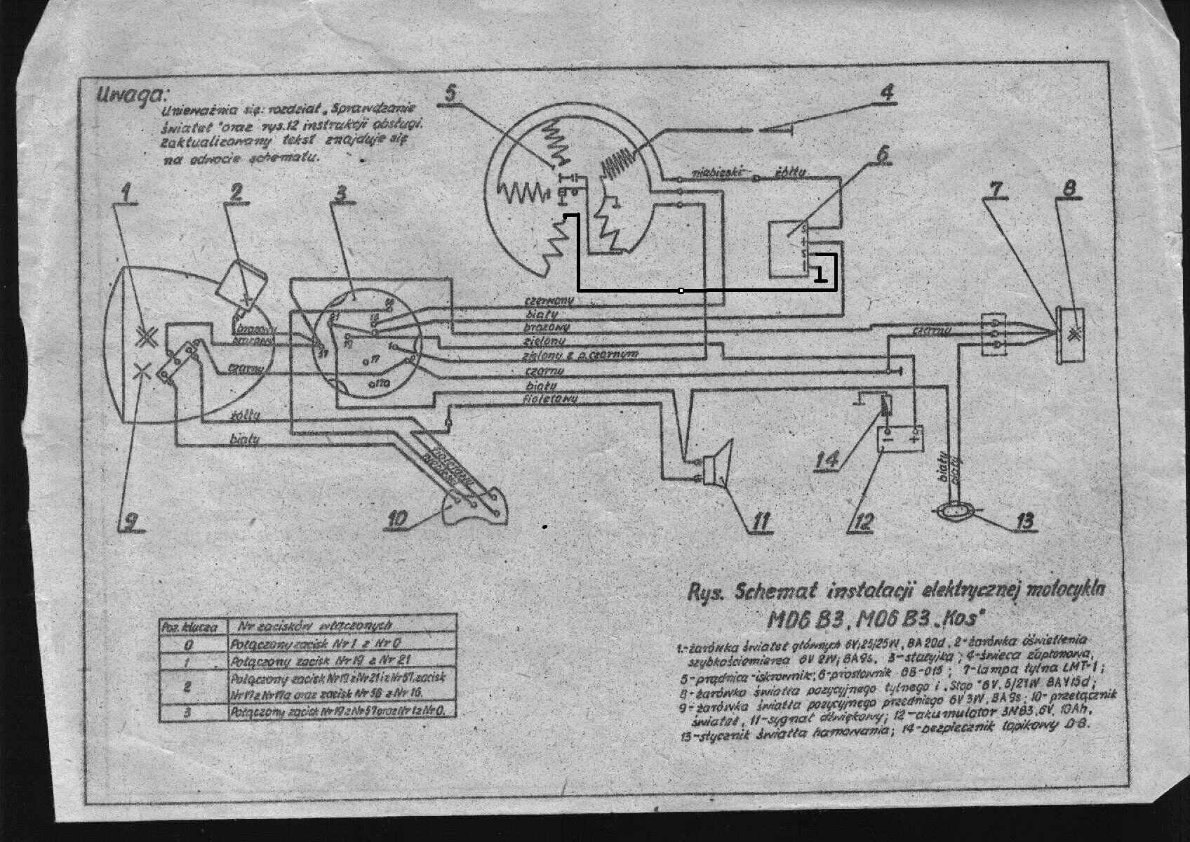

How do I wire a replacement diode bridge in a WSK125 when the motorcycle diagram shows a different rectifier?
Connect it according to the WSK 125 installation diagram: the original setup uses only one half of the rectifier circuit, so the bridge can be wired as in the first scheme, but it will charge the battery with only half the current [#16615761][#18359048] One wire from the charging/magneto system goes to chassis ground, and the other goes to the lamp/charging circuit through the rectifier [#16615478] If you want the simplest repair, replace the old selenium plate with a silicon diode rated about 5 A in the charging circuit [#18359048][#16615478]

    Unfortunately no, there is nothing where to connect.

    Two wires must come out of the magneto, probably one of them. The link describes what to connect where.

    One wire from the charging system goes to the weight of the motorcycle while the other wire goes into the lamp and there is a one-half selenium ptostownik which is exactly one selenium plate.
    In addition, the charging system is protected by a fuse around this selenium plate.
    Added after 4 [minutes]:
    Simple. blow the selenium plate and solder a silicon diode in this place, it can be 5 or 10A, charging will definitely improve, because the diode has a much higher efficiency than the selenium plate.

    Here you have the installation scheme for your version of WSK https://static.elektroda.pl/attach/ins_wsk12543.jpg
    And here are the changes that need to be applied to take full advantage of the rectifier bridge. WSK125: Connecting Diode Bridge Unitry - Diagram Differences and Connection Guidance
    You can connect a bridge according to first scheme. It will also charge the battery, but with one-half current.

    Hello, I'm adding a clearer diagram of the WSK 125 M06 B3 and Kos electrical installation from 1985 WSK125: Connecting Diode Bridge Unitry - Diagram Differences and Connection Guidance

    The diagram shows like a bull that this two-half rectifier that was used in WSK 175 motorcycles in the WSK 125 motorcycle is used and used only as one half. Instead of breaking your head by connecting it, just mount a 5 Amp diode in the charging circuit of the WSK 125 motorcycle.
